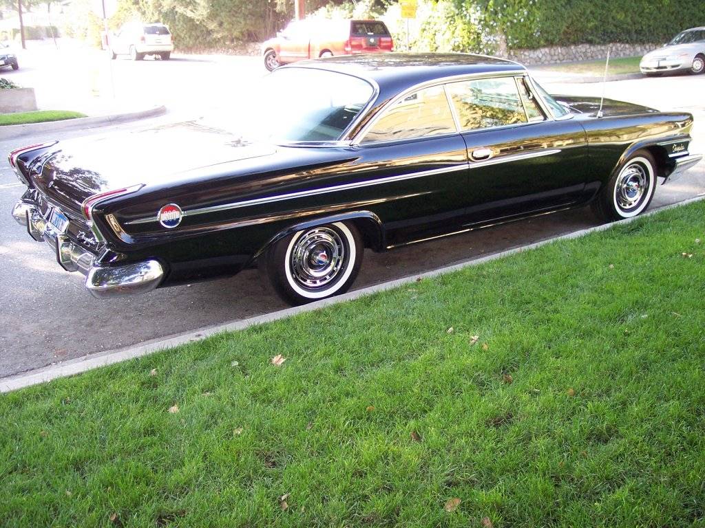

I have a 1962 Chrysler 300H and I am putting the Nexens referenced by Dan above on it very soon. I have already put Nexens on my other C bodies and am completely satisfied with them.
This is a photo of my car but with slightly wider whitewalls on it now but the Nexens are just slightly more narrow and more preferable in appearance to me.................these cars didn't come from the factory with wide whites either.

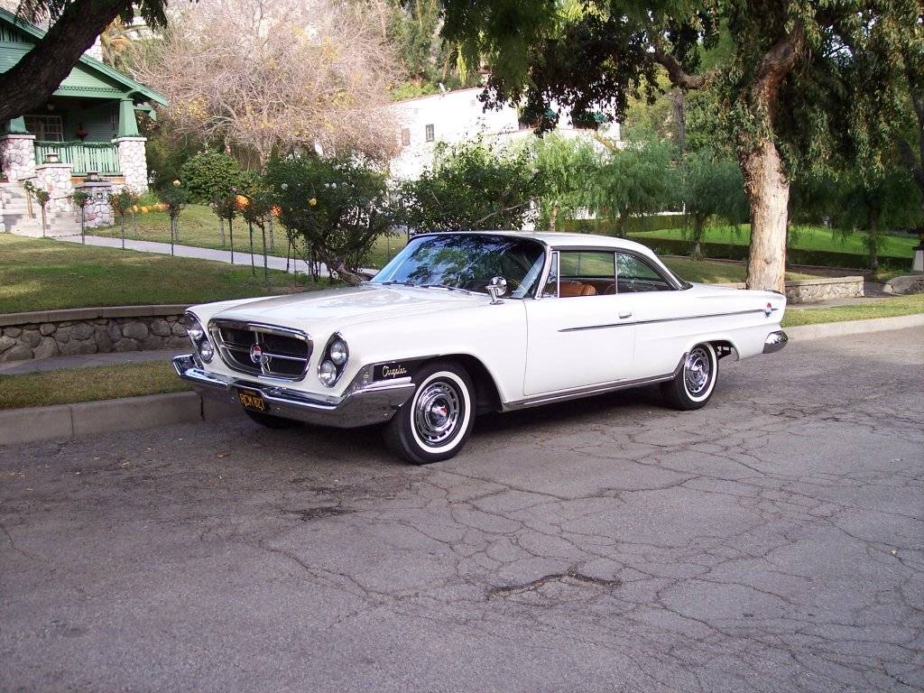

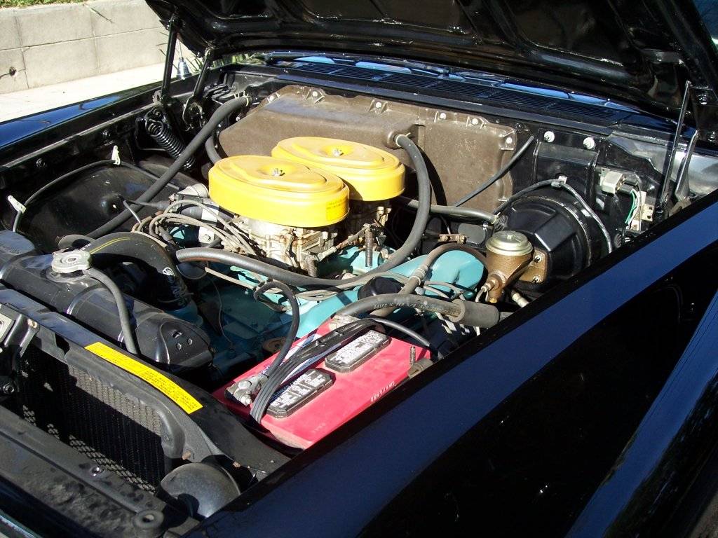

For me, the non-letter 1962 Chrysler 300 non-letter cars were pretty significant as well as the letter car. Here is one that my dad bought new in 1962 and I restored that car as well when it was well worn and my dad was considering buying a new car. It had the 300H dual 4-bbl carb sport package engine in it even though it wasn't a letter car, because it was an available option. I liked it almost as much as my "H". Here are some photos of that one.................

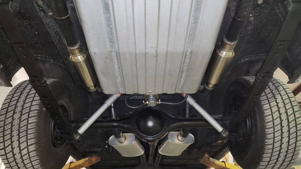

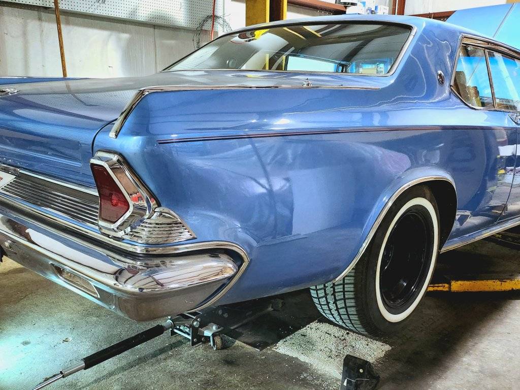

So 90% of tires already have a white in the sidewall. Even if it's NOT a raised white letter. In the pic is a 64 K that makes over 600hp. I had Wheel Vintiques special make all the wheels. The rears are a 15 x 10.5" wide with a 275/60/15 Cooper Cobra Radial GT with a period correct white wall (buffed) into the sidewall.
I've done this for 30 year's on sticky tires to make sleepers that almost dead hook on the street.... A STI's nightmare at the import street races with my Grandpa's 64 . It also has 4 mufflers with the new 421c.i. horsepower kind of hush hush....
The machines that do this are from the 60's. I've seen 3 different manufacturers of the original piece. Then a guy in Phx has made a newer JIG design that holds any sized tire onto a balancer & his buffer is moving.... The old original machines sit on the ground next to the car & you place the car in gear on stands & it spins the tire. Just depends on where your at....
