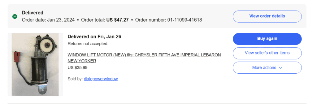

I bought this for my '67. It fit.
The motors were generally the same from '67 to '72, as I understand it.

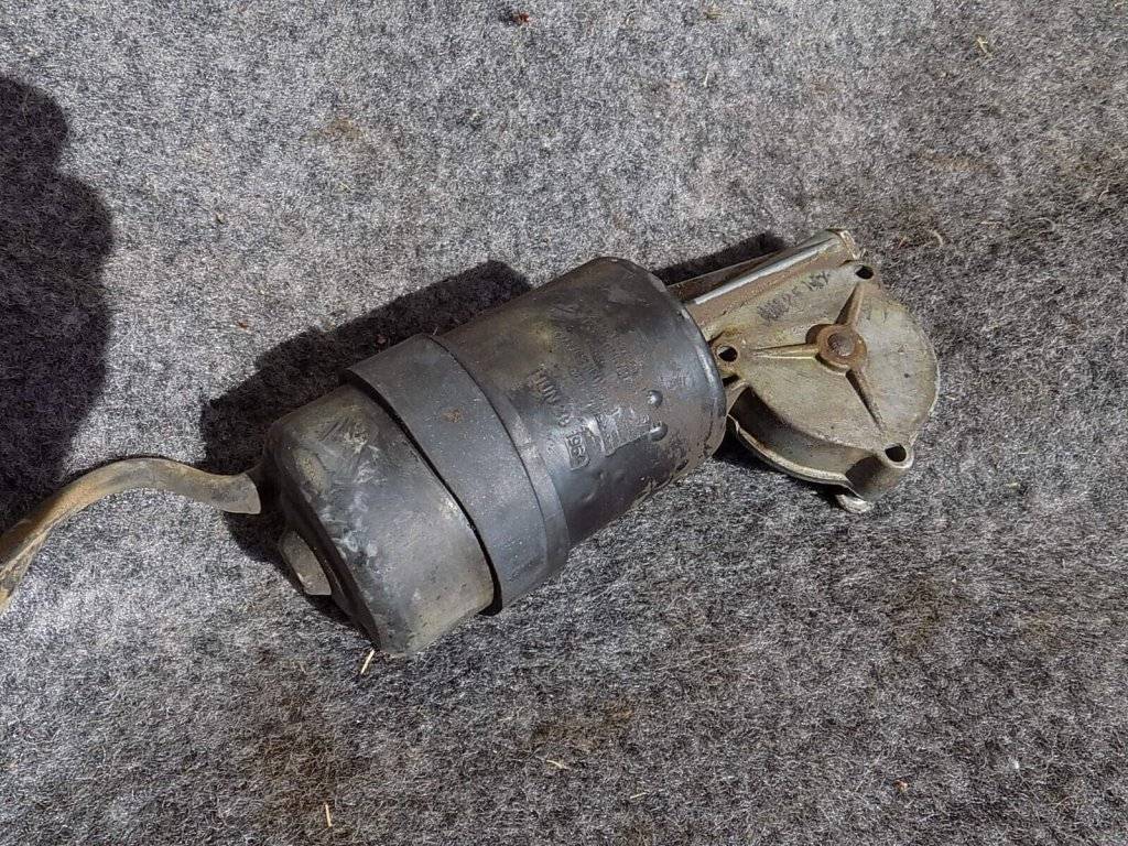

I found some images of what the motor in my 66 looks like (See below). It appears to be a little different than the one that came out of your 70. Mine appears to be sealed at the bottom.
Do you know how would I access the internals in mine? I found this video on YouTube of a similar-looking motor that needed to have the rubber bottom cut open. Is this how mine would come part?
