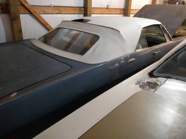

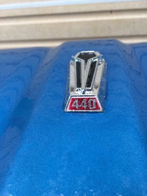

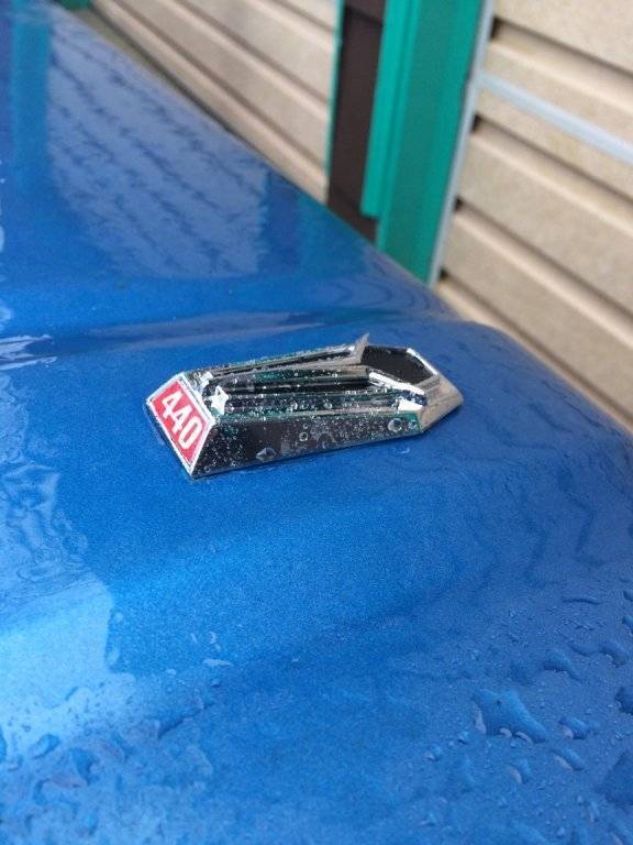

My 69 Sport Fury convertible is blue /w white top white interior. Needs alot of love, but a 440 K code E85 car. It also has a stamped 440 badged hood emblem not some decal imitation badge.
I agree, pictures please.

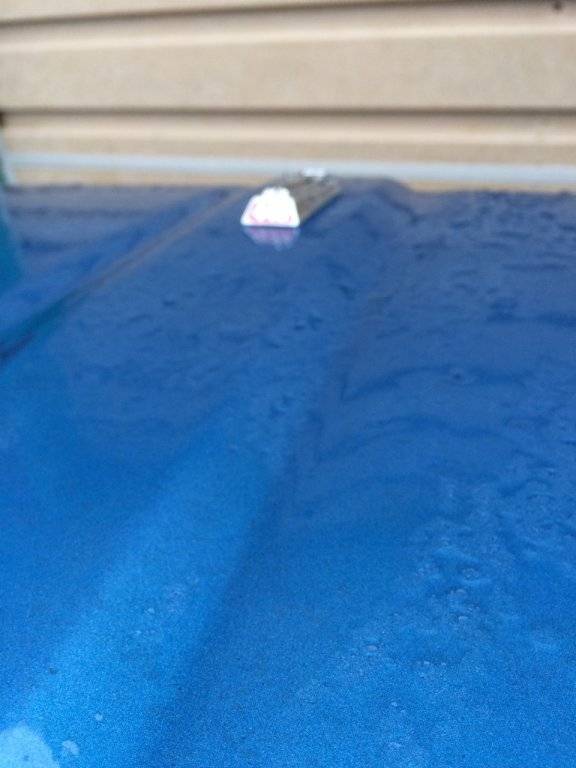

Here's the close up of the 440 hood emblem. I'll try to get some more photos sized down so they download. Little new at this but love this forum!!! You guys have great info.

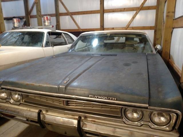

As you can see this car is need of a total restoration. I just couldn't see it setting outside with the possibility of having the 440 removed for an E or B body. Had to buy it and pack it away safe and sound.
