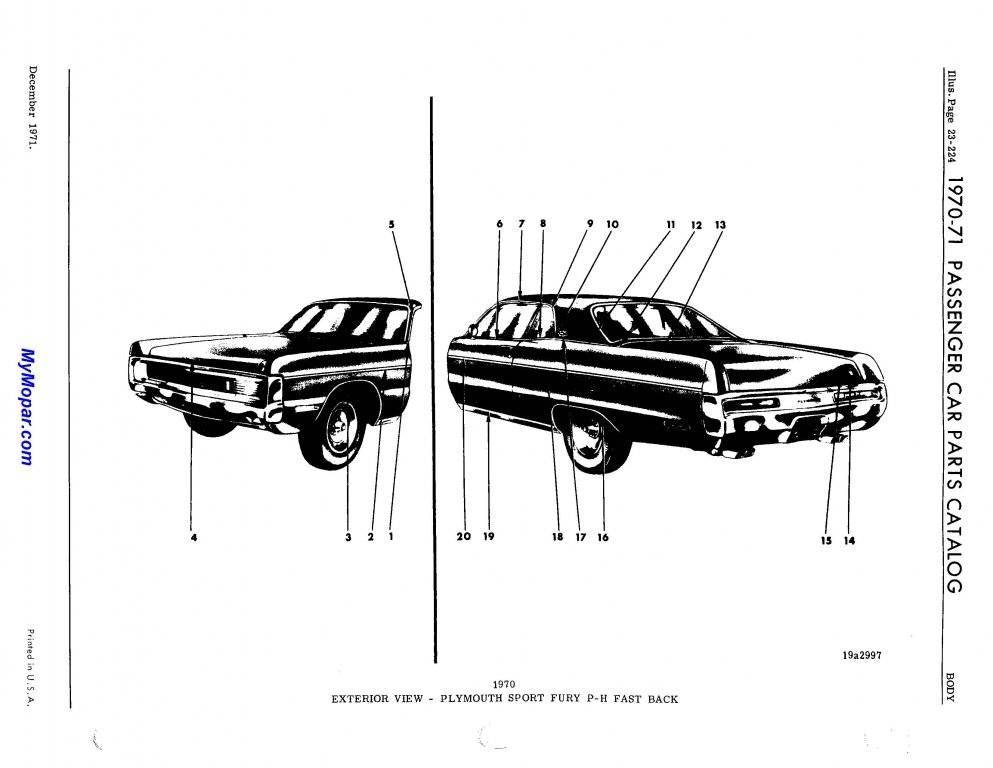

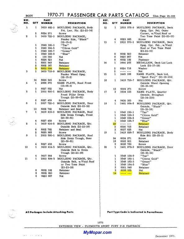

I'll see if I can find a part number for them, but I did so great with the last plastic piece I needed that...well, I failed miserably and Big John had to come to the rescue with the number.
The part number appears to be 6003004?

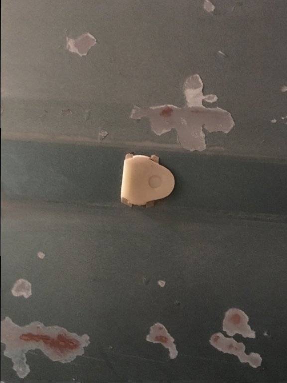

So...I never found any of these clips. I did, however, figure out how to easily remove them. In the pic above, see the circle on the right side of the clip? Well, you simply push that in so it pops out of the clip and then you can easily pry the clip off the car.
I do, however, still have several that are broken that I need to replace, so if anyone has any or knows of a car with them still on, please let me know.
