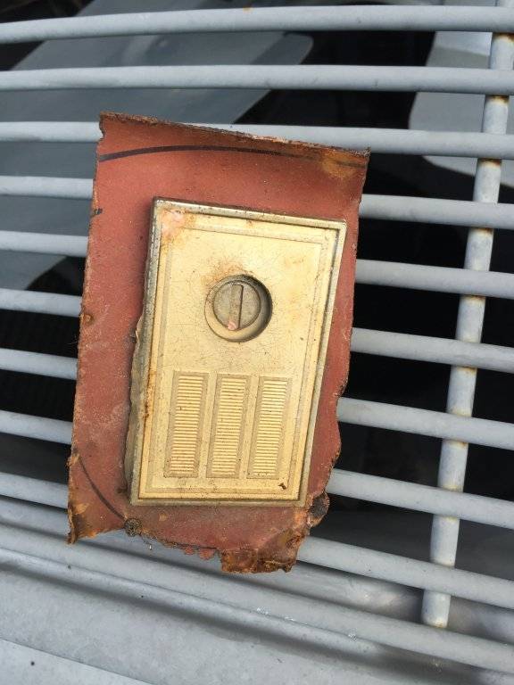

OK, well, I've struck out finding a trunk medallion in good shape. Hence, I'm going to restore the one I have. However, I need a little help. I have never seen a new or really good shape medallion. So, I'm wondering if one of you can provide me with an up close picture of a NOS medallion or one in really nice shape. I need to see the finish on it, the color of the three stripes, etc. If anyone can help out, I'd appreciate it.
This is what the one I have looks like (and for reference).
Sorry, can't help. But I like your make-no-prisoners-approach when it comes to removing medallions
:lol:
Oh, haha. That's how I received the emblem. I actually think that was off an S/23 or GT (can't remember which).

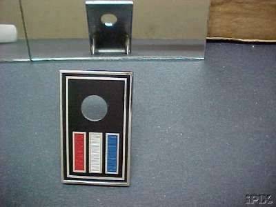

Not a great picture, but is the only onde I could find in my library.
From the Cbodydrydock 10 or 15 years ago;

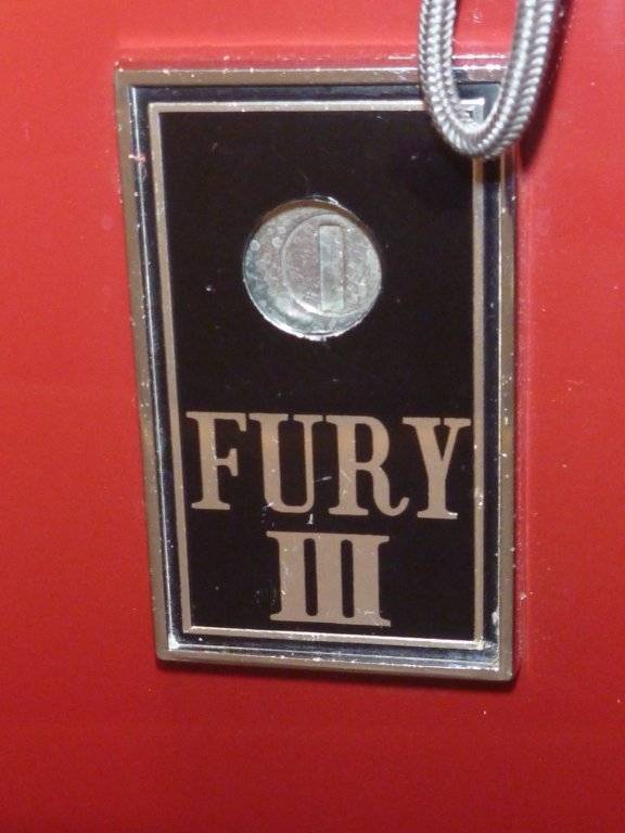

I kept pretty well all of my Fury III badges, the grill being one exception since I wanted idden headlights. However I can't help on the SF trunk badge since I used an NOS Fury III badge. Here is a somewhat dusty NOS Fury III trunk badge. Excuse the hanging camera strap. LOL

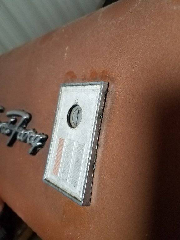

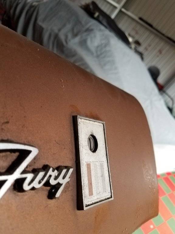

I don't know if these pics will help you or not, but here are a few pics of the emblem on my car. I'm not going to do any sort of factory correct restoration on my car, and I really don't care if that emblem finds it's way back on my car once painted; that said, if you like this emblem over the one you have, you can have this one (assuming I can get it off without cutting off a portion of the trunk lid off along with it, lol)
Wow, thanks. That would be great. Much better than my current emblem. If you don't want the Sport Fury emblem I'd take that as well. I have no problem throwing you some $ for the effort.

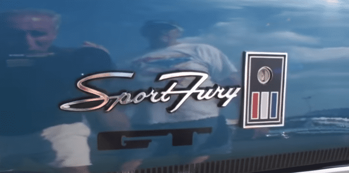

Here's a screenshot of Dave's 70 SF at Carlisle last year as well as the full youtube clip.
