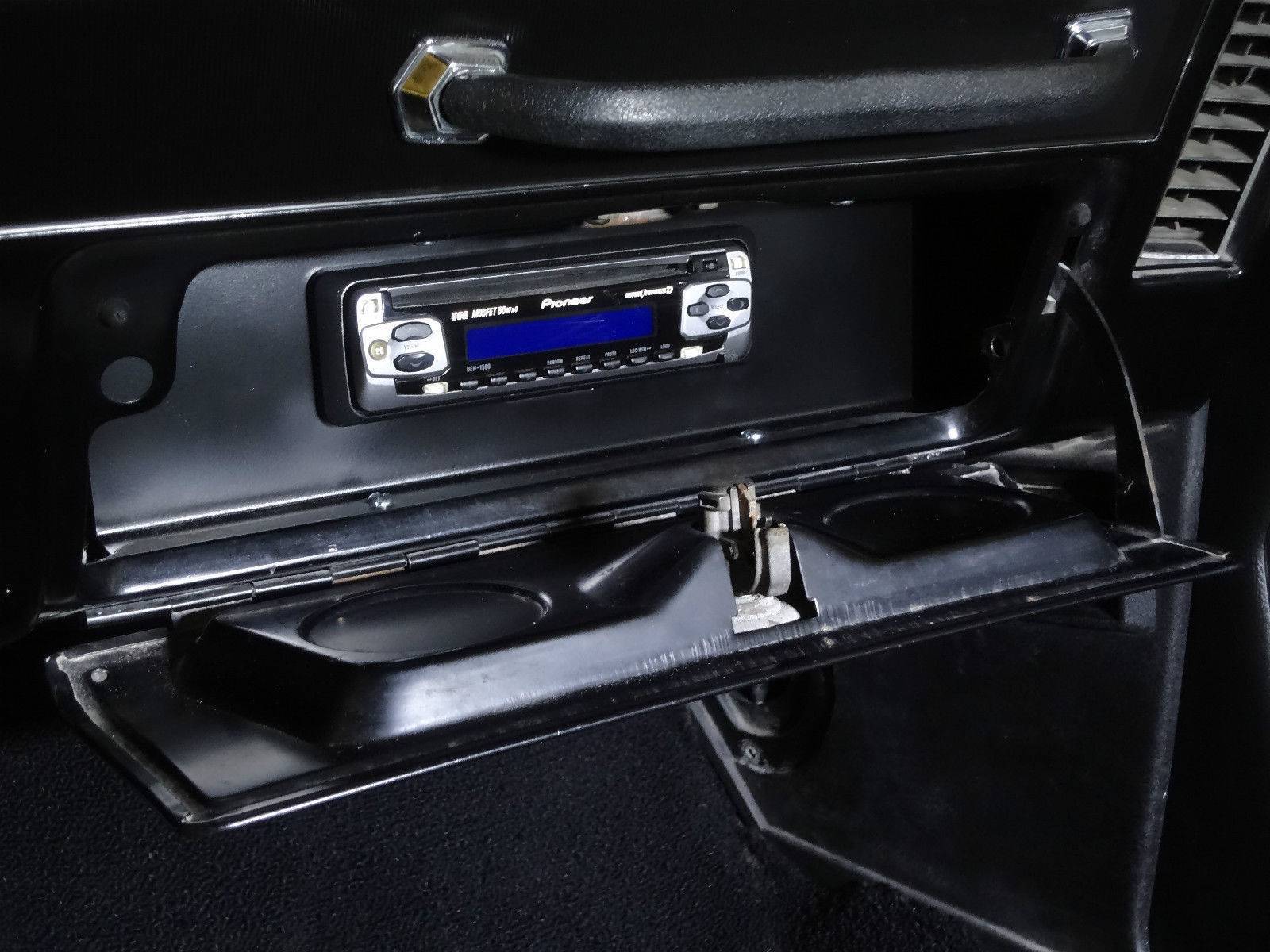

I can't bring myself to spending the money to modernize my factory radio at this time. I was looking to mount a modern radio in the glove box. I wanted a nice clean reversible look. I am pretty sure I found it.
This company of course doesn't offer a mount off the shelf for our c-bodies, but will make a custom mount for nearly the same cost of around $65 dollar. You make measurements that work for their standardized blueprinted CAD program and then the mount is cut and powder coated.
TMC Customs, LLC
Here is a photo I pulled of what their mount looks like.

They mention that you need to be able to remove your glove box. I have had it out to access the front speaker in the dash. It will now be remain out and stored for later re-installation. Still surprised that they were made out of cardboard.

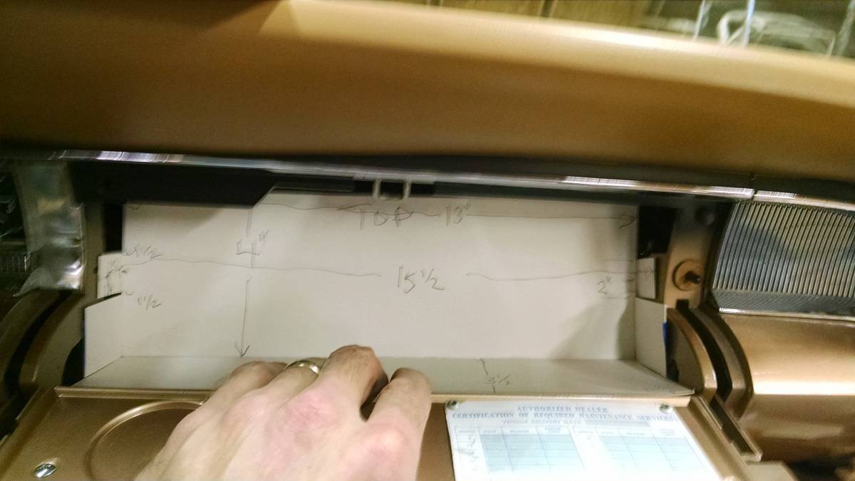

You are right Fury1 a standard radio probably won't fit in the glove box. I thought that maybe once the interior portion of the glove box was removed one would easily fit in. It will be very close. I am going to try first. I found a good deal on one with a CD player. Plan B is a radio without a CD player. There are several out there now and they are 2 inches less deep and will fit in.
I am going to make my own mounting bracket. It will be pretty simple to fit. It will be held in place by 3 machine screws on the bottom and 2 tabs on the sides. Here is my poster board mock up.

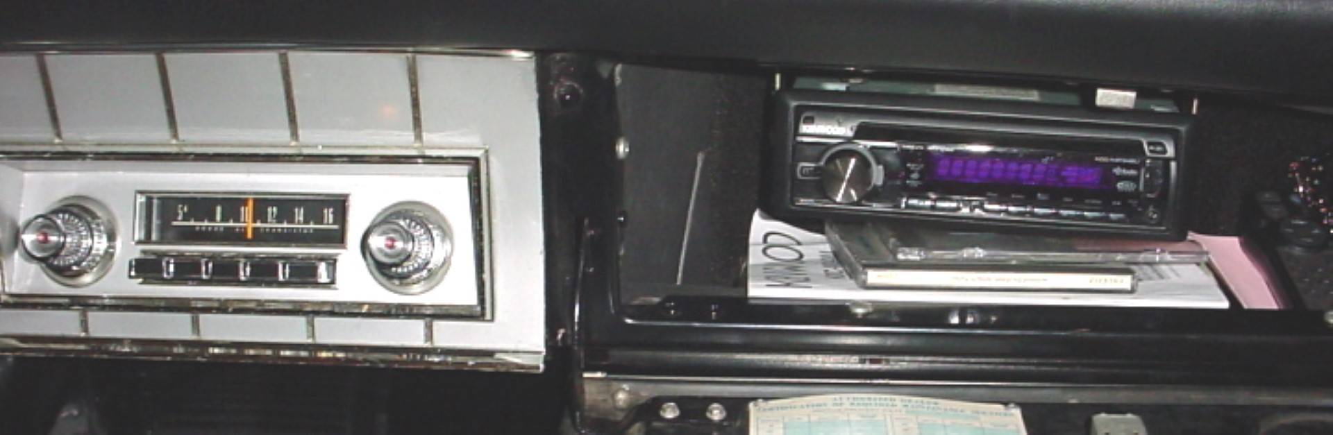

I bought a repop glove box liner for my 65 Coronet and, using a simple "U" shaped bracket attached to the inside top, mounted a kenwood radio. I retained use of the glovebox for the car papers, radio info book and maps.
The radio has provision for a remote CD player, MP3 player, (which is all I use), and a remote amp.

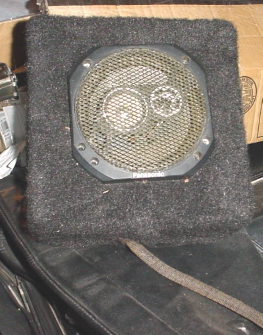

It's a convertible, which limited the options to mount speakers, so I mounted two 5" 3 way's in homemade wood boxes. I use 10' of speaker wire on each, with RCA connectors, and can locate them where ever I want them. Usually on the rear floor when cruising or on the boot while at shows, cruise in's etc.
