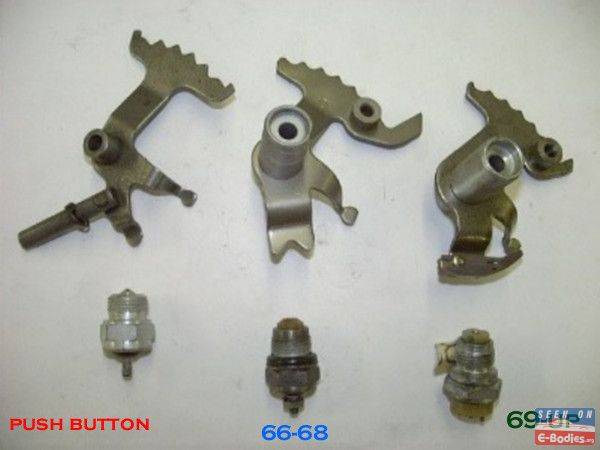

Also make sure you have the right switch for the right rooster comb in the trans. Common if the trans was changed.
Up to 68 the backup switch was on the column or the console shifter.
69+ it was on the transmission.

I just discovered that i have a 1966 transmission in my car, so the 1978 safety switch can´t work correct with the 1966 rooster comb.

No kit on the rooster comb. There are a few charts out there with the pics of the differences, search it, then you can get the right switch to work. The seal I believe is all the same on them. But leaking through it is in need of a new switch the crimp is leaking.
