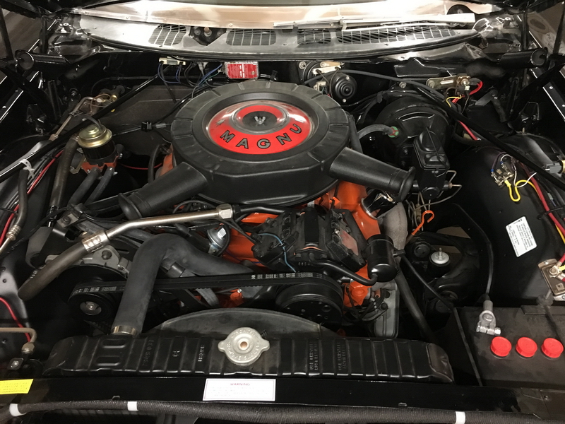

Unless your engine compartment looks like this you probably don't need the resto coil.
