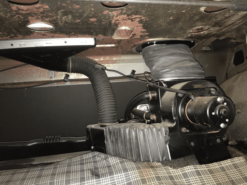

I decided to take a different route and install the ac in the trunk and have it blow forward from the package tray.
It's to much work to install an original system, and i am just a tourist driving it on some road trips in Canada and the US ( or maybe some more ) so i am running hoses under the car next to the rear heater hoses.
I do have another question, the car has a rear heater, it now has one speaker in the back, i want to mount 2 speakers
i am thinking of disconnecting the air hose to the package tray and mounting the speaker there.
anybody done that before? is the hole the same size as the speaker side?
so the heater stays but the hose will be removed for now ( stays with the car, don't kill me )

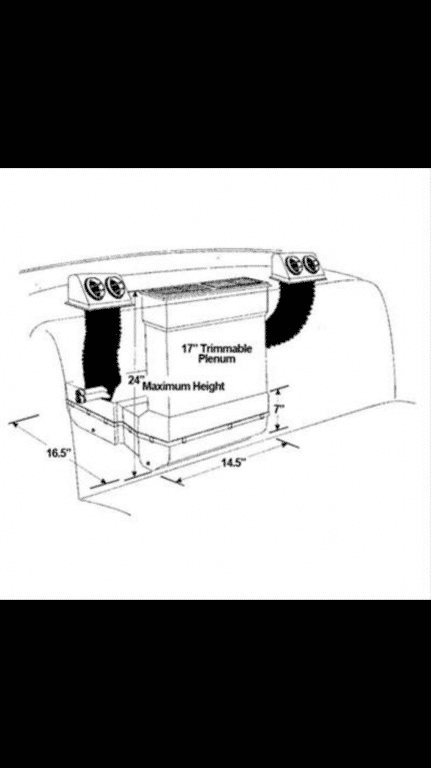

It's an aftermarket ac system from Old Air Products.
It's connected to the package tray like on the drawing
it doesnt even intrude in the normal trunk space, you can stil park a smart in the trunk and do donuts in it.
