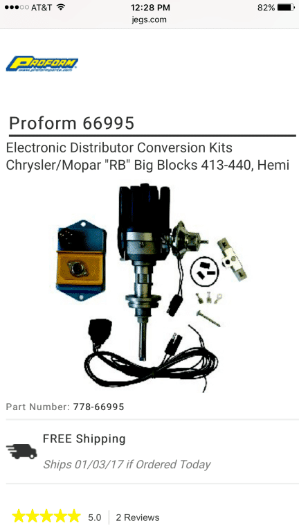

The previous setup was a 361 that someone slapped in it and a points distributor. The "new" 440 is out of a 76 New Yorker and we put the new electronic distributor in it from Jegs.
Black wire with yellow stripe goes to negative side of coil and ignition on 12volts for the green with red stripe.
