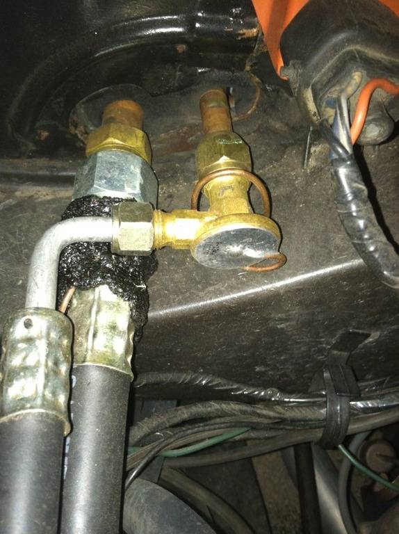

The factory one was designed with a long thin probe to lay in a slot or tube in the suction side. Any probe that you could clamp or hold against the suction side tube to make feedback on temp coming out of evaporator to regulate pressure differential. I would wrap it with styrofoam pipe wrap and a couple of zip ties to shield heat from probe.
Mine is wrapped with Permagum. A length of it came with my Bouchillon kit.

Hallelujah!!! Third time is the winner. It came a day early from RA. First thing I did was pull it out and look it over. Here's a picture of the winner.

I had the energy(maybe more like excitement) when I was done mowing. The only things that need done are to install the suction line (I don't have a big enough wrench) and to affix the capillary tube from the expansion valve to the suction tube.
I've been striking out on the permagum locally, so I'm considering this stuff. What's your thoughts.
Gardner Bender 1 lb. Plug Duct Seal Compound-DS-110 - The Home Depot
Duct Seal came up when I search permagum on Amazon.
From the wide range of application it didn't seem like the permagum was a super fancy thing - even used on washing machines according to listings on ebay.
