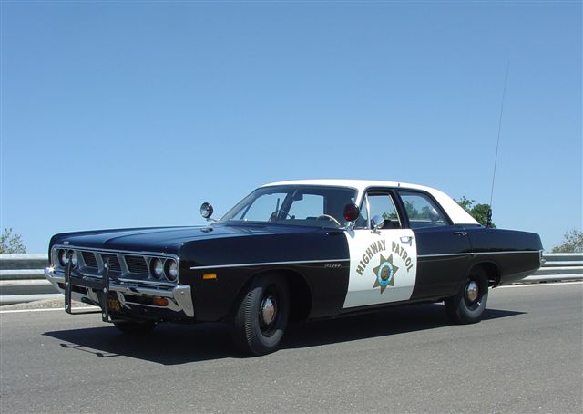

This is unit 4870 owned by Ron Hurwitz and for the last 3 years I have been going to shows throughout the state with him.

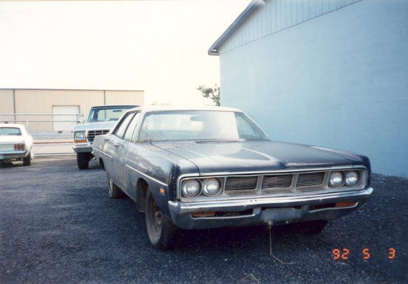

Ron initially went and looked at the car and then reported back to me where I then made the trip to Tulare to see the car and talk with the owner (don’t even think about asking about the other vehicles).

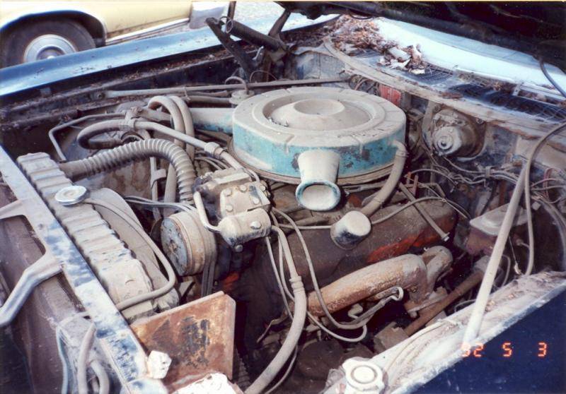

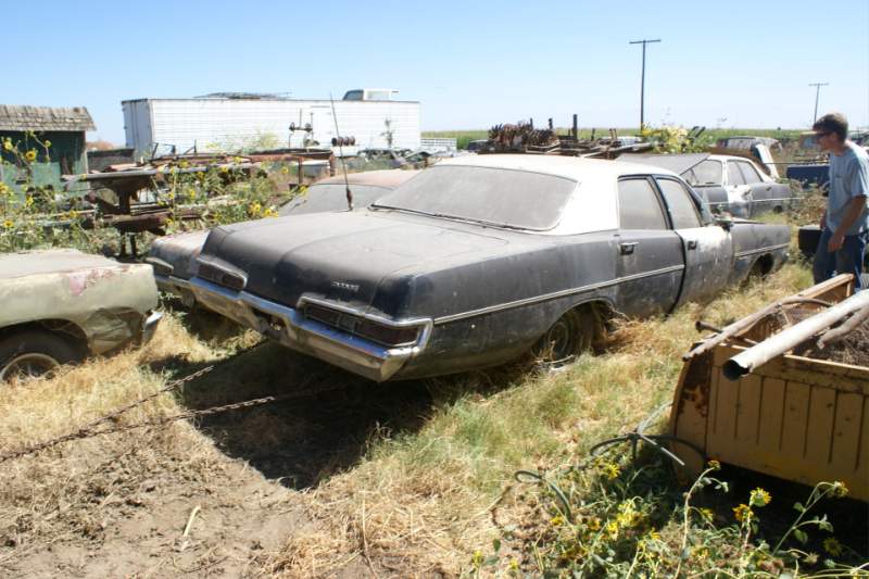

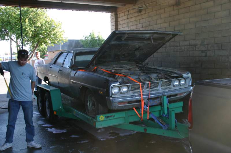

My first impressions were that yes it has some rust issues but it was solid and unmolested. I asked what he was looking to get for it and with no response I had to throw out a number. I followed up with that I didn’t have it on me and I’d check back in a few months when I did. Two and a half months later I called him up and asked him where we were on this, he simply said when you want to pick it up. Trailer and help we made our way to Tulare (4 hour drive) and right away went to work getting to ready to tow out of the field. After putting some air in the tires a chain was hooked up and it was pull out. After close to 30 years it was dug in pretty good, needless to say it was out and on its way to the trailer.

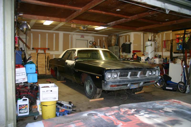

Before it was unloaded I wanted to try and clean it, to the self serve wash.
Ten hours after we left it was in the garage.

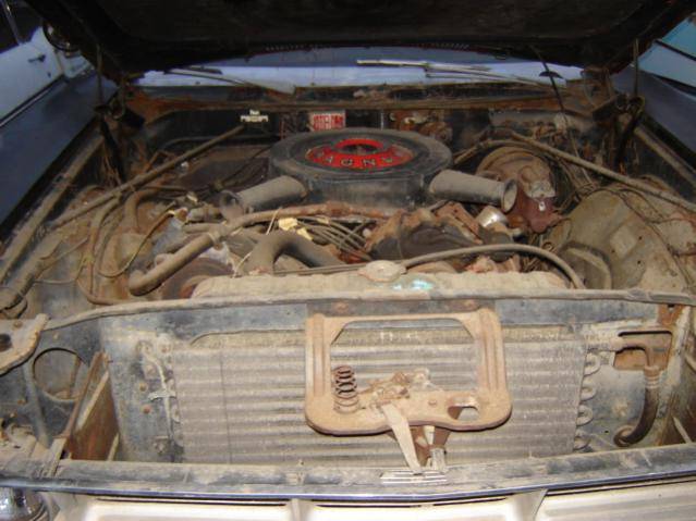

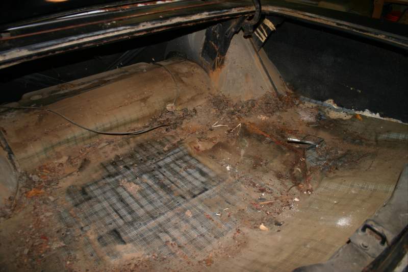

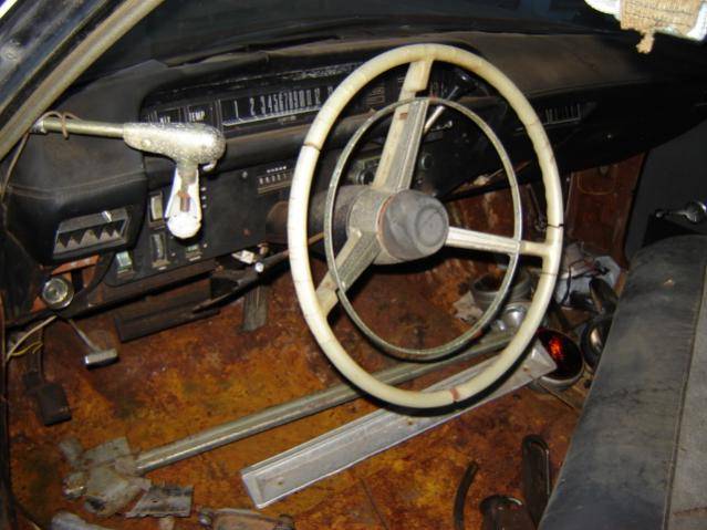

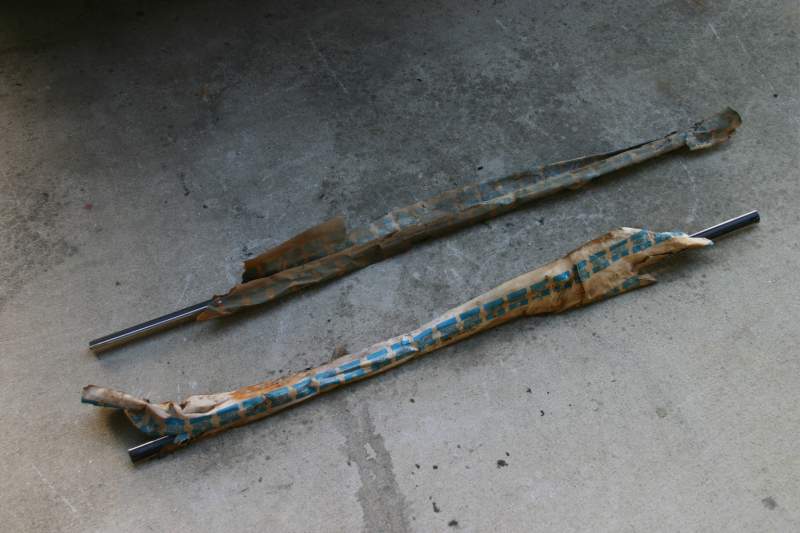

There was a time at the start that I thought I might try and get it running but I soon found out the engine was seized. I then moved my attention to cleaning it out of all the parts, trash and disintegrating bits of metal. In the trunk were the NOS trim for the front doors, packaging was rotten but they were still there.

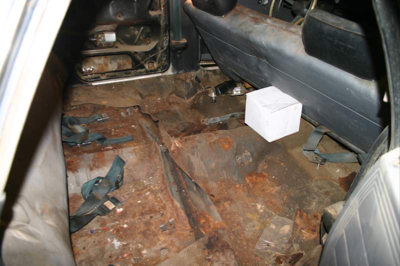

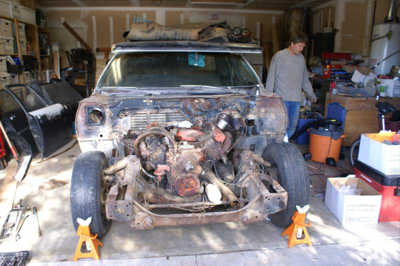

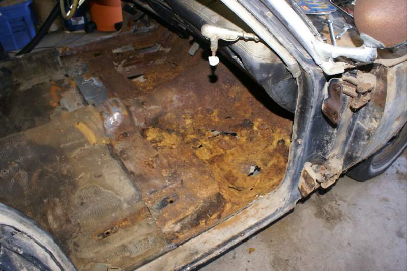

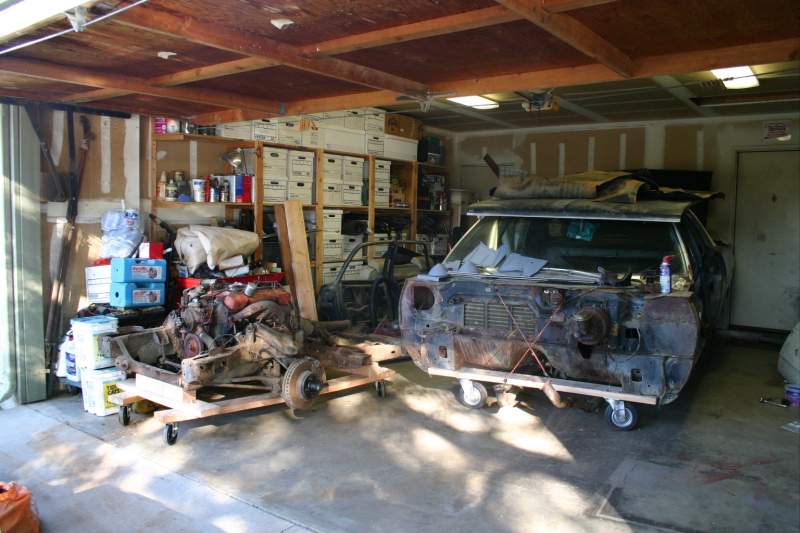

Two weeks into it and I make the call to do a full teardown. In one weekend the car was pretty much completely apart leaving the engine, trans and frame attached. This is when I got my first real look at the floors.
Over the next month I continued to pull off the remaining parts and was finally left with the frame and engine assembly. A wood dolly was put together that would carry the full assembly and a set of wheels attached to the front of the body.

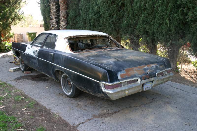

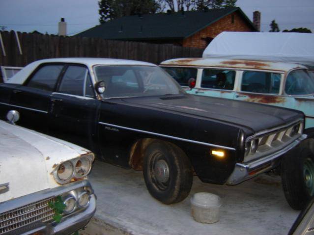

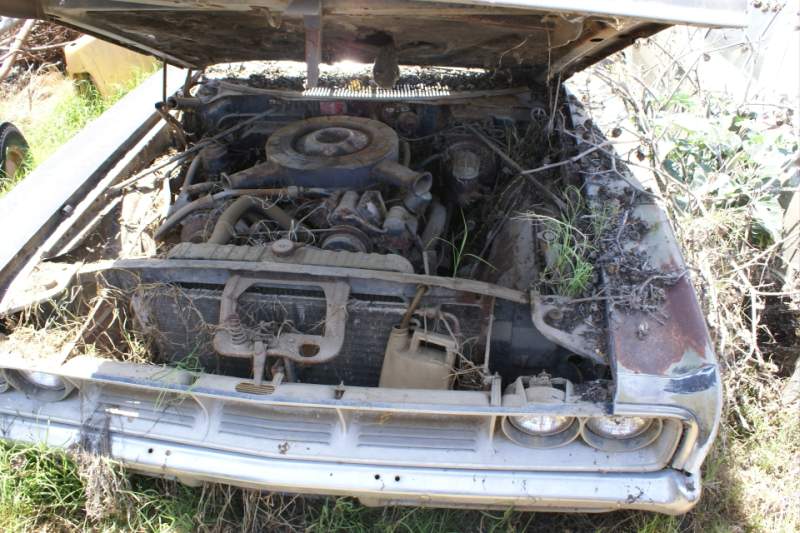

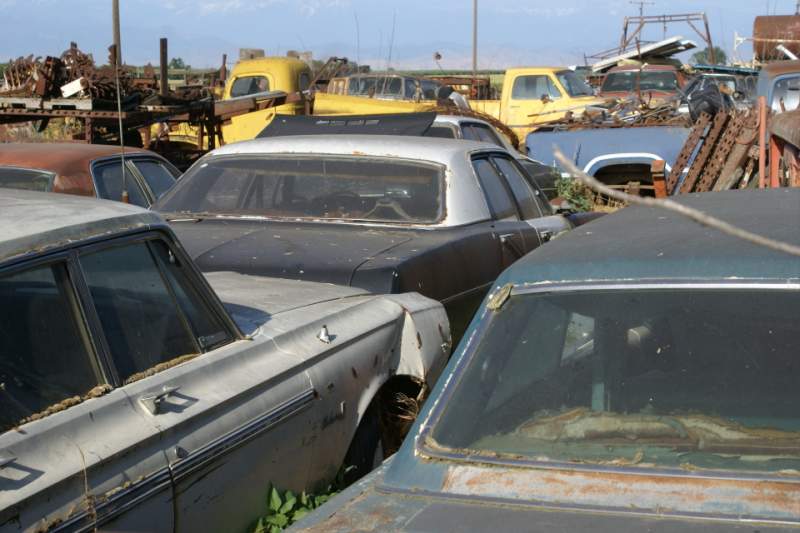

He had two on the lot.....? Is that what I am seeing?

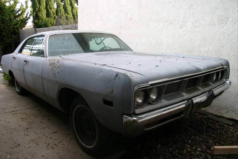

Yes, there was another 1969 CHP package Polara there. As part of my deal also got it. Although it was a CHP package car it was never used by the CHP, it was sold to another agency. This car was in real bad shape, the rust was very bad, pretty much no floors, trunk floor, rusted lower quarters, lower fenders, hood, trunk lid and rear window frame. There wasn't much worth saving on it but we took as much as we could and scrapped the rest. It already was missing the motor and trans. Other than it being a CHP package car (that was never used by them) it had very little going for it.

Damn shame to see it let go like that.
We tried for six months to sell it but the rust was overwhelming. This car sat in the field close to 30 years as well but there was never any effort to protect it, it was always seen as a parts car for the other one.
He still has a couple 69 Monaco one is a HP 440 sedan in rough shape that maybe is restorable, never really looked that close at it. The other is a 69 4-door hardtop with a 360, again never really looked at it.

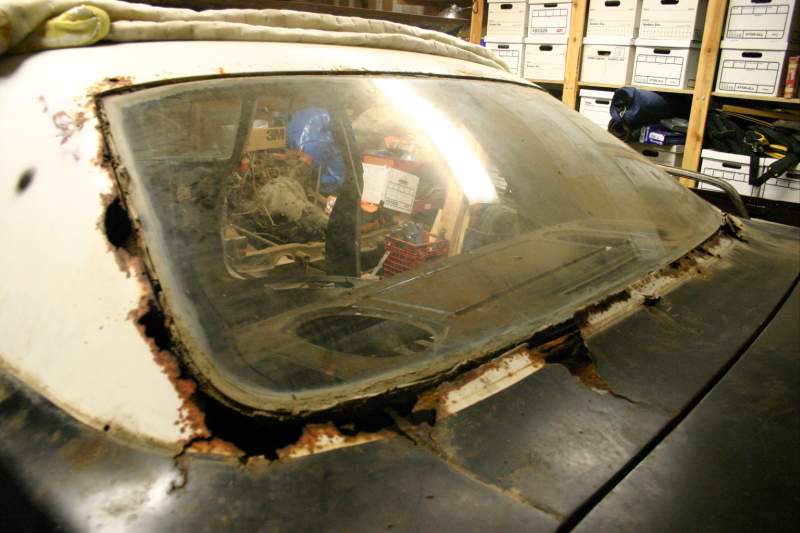

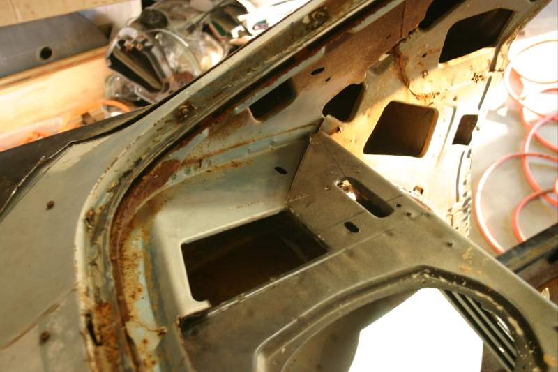

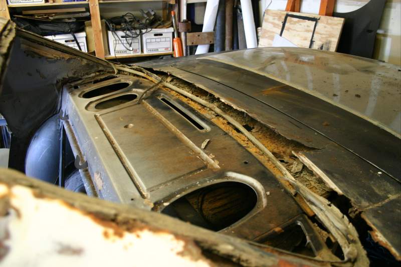

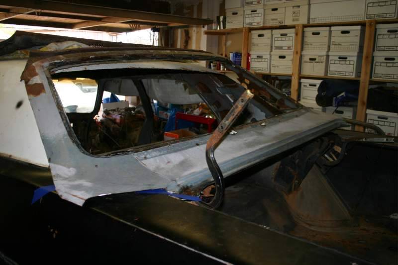

Before I could get started I needed to remove the rear glass and I was shocked by the degree of decay that this car had. That wasn’t really a problem as the way I had planned to fix this would take care of it.

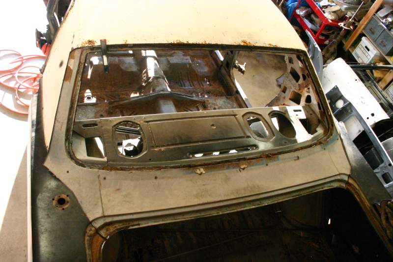

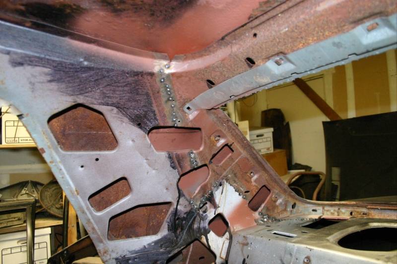

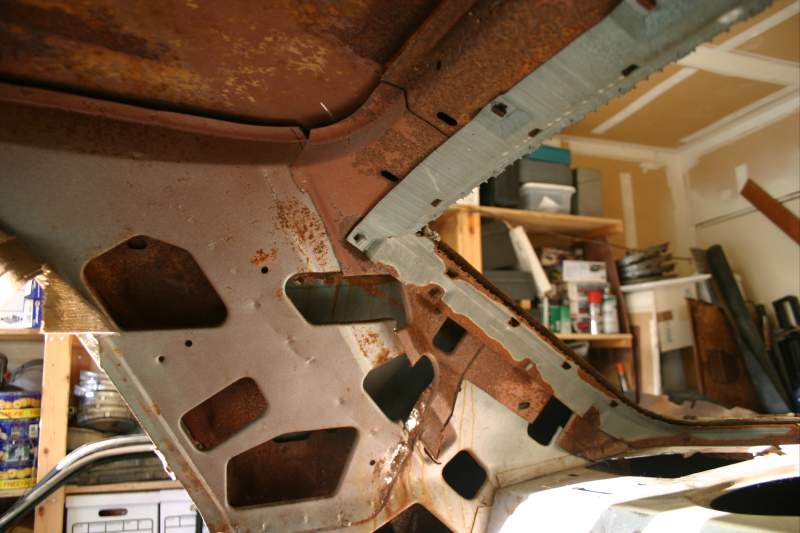

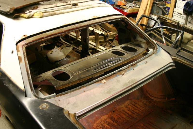

Cutoff wheel in hand I cleared the rear window rust and what an instant transformation but at the same time exposed more issues. With the slug out of the way I found the upper part of the wheel wells rusted along with the hinge support pieces. From the beginning I had planned on trying to replace the full frame the dutchman panel along with some of the inside of the c-pillar. At a glance one might see this as an impossible task but I saw the potential.

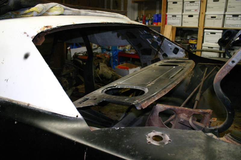

Now six months into the project I have worked the rear window slug into place or at least enough for proof of concept, keep in mind there is portions of the inside of the c-pillar and package tray attached to this piece. Basically it was dropped into the trunk and lifted in place. Still much work to get it full in place and ready to weld in.
Additional fitting has been done of the rear window frame and it is almost ready, some final trimming and flanging it will be set.

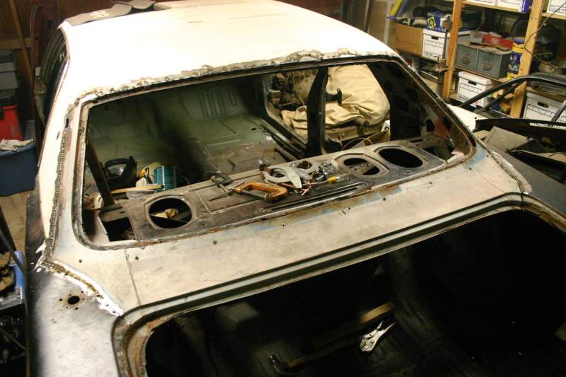

I screwed it in place and proceeded to weld it in. Still some spots to finish up but for the most part it is done.
Already the car is looking far better than when I first got it.
This will get cleaned up along with the bodywork later at this point I just want to take care of the rust repair.
