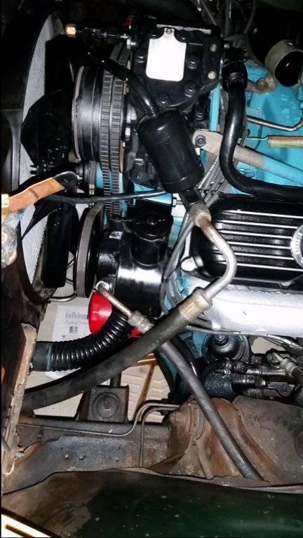

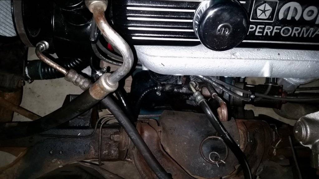

Any pics? ...would be helpful.
Yes pictures please. You should have a "Federal" design pump, but we need pictures to help you.
Sorry for the late reply.....

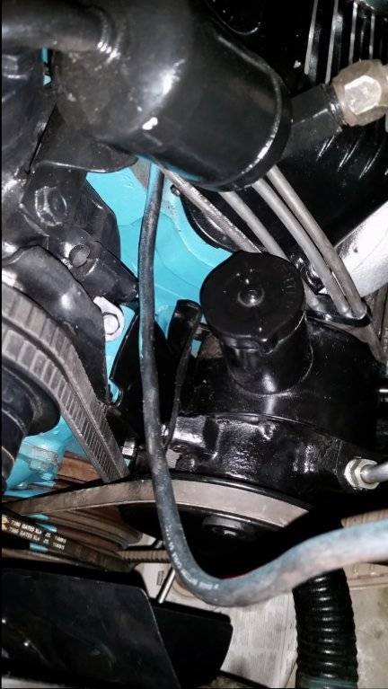

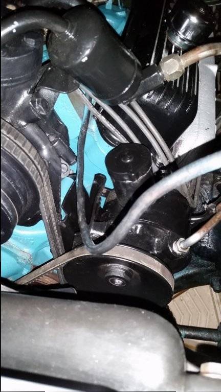

Heres some pics of the pump and it is a federal pump.
I had my cousin come over to look at it and his opinion was to take the belt off and manually spin the pulley by hand. There was some resistance like it there was something blocking it. I did notice when I revved it above 3000 RPM there is some assist so the verdict was to try another pump.

oK..Thx for the pic. I know this sounds simple but when ever I have a problem I begin with the simplest fix first.
I assume you've confirmed the fluid level in the pump itself?
Looking at the drive belt (for the pump) it appears to be taught, which it would make me think the pump was in the proper position (it would be loose if the pump were not). Sometimes the bearings go bad in these things, esp. if they've been rebuilt (re-manufactured they call it, lol)...they will self destruct esp. if the fluid isn't kept at the proper level and/or your not using the correct type of fluid. They pulley wheel should spin freely and without any kinks or "rough spots" in the movement.
First, you do have a "Federal" design pump, As suggested check the fluid level and type, (do not use ATF). If they are good get a long piece of hose and mount it to the return end of the gearbox, start the engine and watch it run into a large container. the pump should go dry in seconds at idle speed. if it does not the pump is bad. good news is if you have to replace the pump, you can change it to the "Saginaw" design at this time.

Just took it for a successful test drive. I ended up getting a new federal pump and also installed a new return hose. It immediately bleeded the air and worked flawlessly. There were no leaks and full power in idle from side to side. Now my new yorkers ready to go for the cruising season!!!
