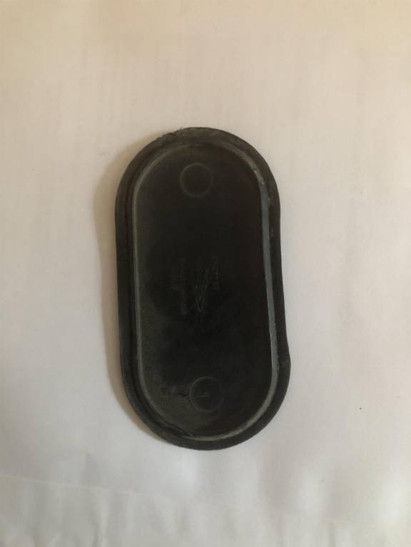

Hi, I have recently Purchased a 1965 Chrysler 300 L , One of the oval body plugs in the Trunk is missing. I have searched most of the suppliers but cant find any repro's. so it might have to be an original. Can anyone help Please.
Do you have any junkyards you can access over there? That would be one way to try and find those plugs. I did see some things on ebay. You could take a look and see if a seller will work with you to match one up. I have found that sellers may have things available that are not listed.. good luck and welcome to the forum.
I have a coffee can full of old body plugs. May have the one you need. Got a pic of it or the size?
I've been casually looking for one myself. I have both, but one has shrunk a little and falls out easily. A spot of glue keeps it in...
Part# is 2527781 and the hole is 2" x 4.25". Nothing that DMT sells is large enough.

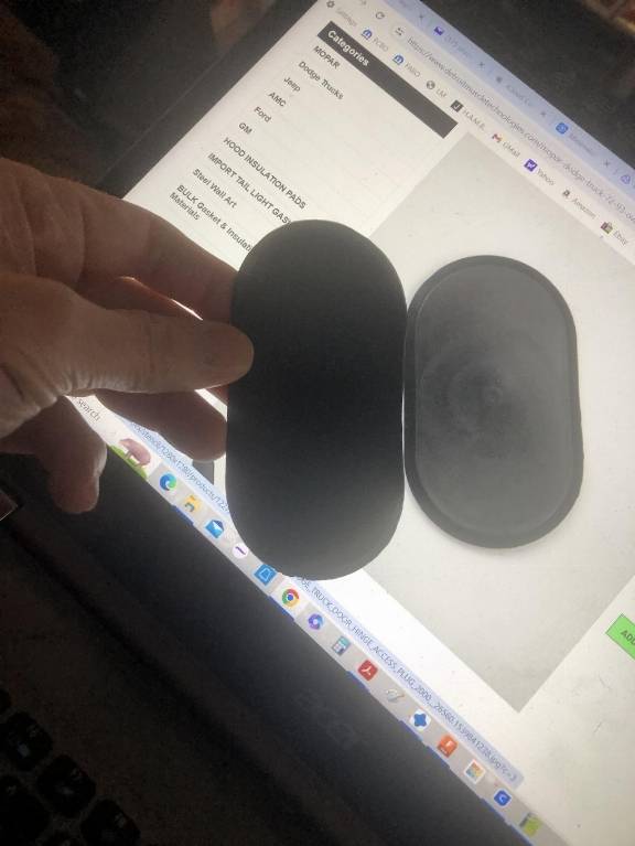

DMT has them on their website. They looked good until I scaled the picture to an original plug and it looks about an inch shorter. The configuration is the same though.

Original v. DMT plug.

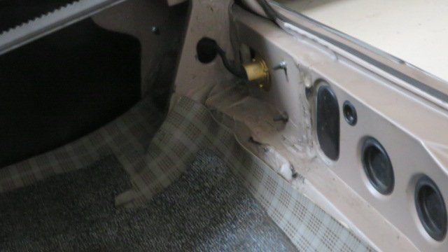

My 300 is Dec 15 and it has 4 bulbs. Does that vertical oval plug cover the access for the back up light?

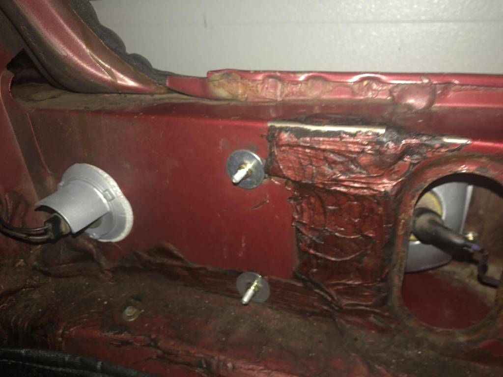

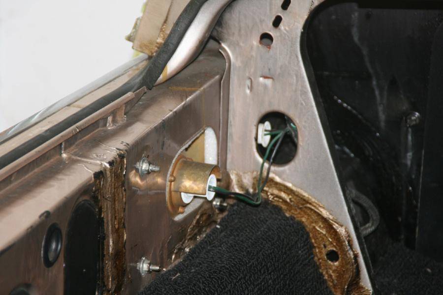

The reverse light bulb is accessed through that plug. The hole cutout is round for the single taillight with the socket closer to the brace. The hole cutout is oval for the dual light and the outboard socket is the other side of the brace.
Top pic is my car with a single bulb Bottom car is a low mileage, very original car with dual bulbs.
