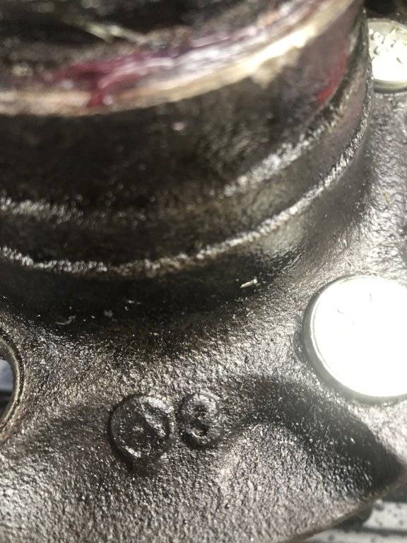

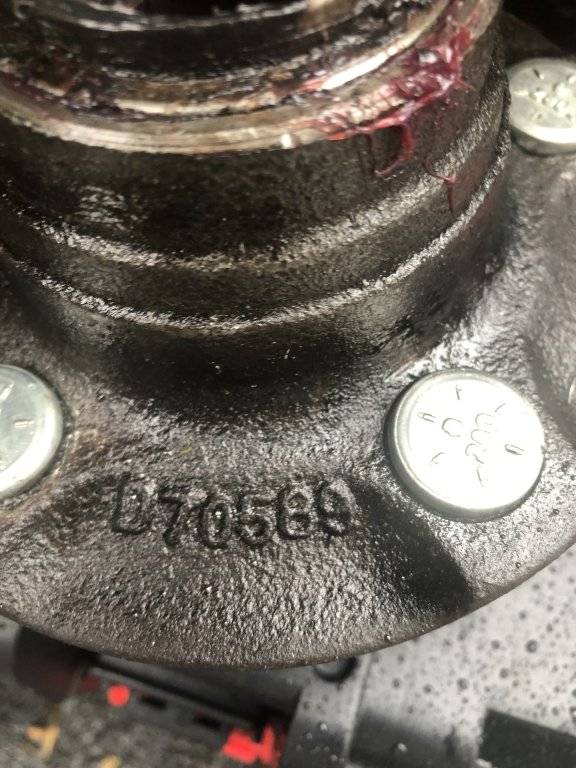

FuryGT,
I'll double check tonight. I'm sure on the D70598 number. I'll post the pic later tonight
D70589 is not a Chrysler part number. BD60141 is a Wagner part number for an 11 x 3 inch drum, but I don't whether that is left or right hand threads.
Are you 100% sure that your '68 Fury III has 11 x 3 front drums? 11 x 2.75 front drums were the standard front drum package on '68 Furys. 11 x 3's typically would be on '68 Furys ordered with heavy duty brakes or a towing package.
I currently own '68 Furys and have owned others in my 30+ years of experience with '68 Furys. If you haven't done so already, measure the width of the brake shoes, not the drum. Once you have confirmed the size of the brake shoes, contact me or @mobileparts to see if we have the drum with hub that you need.
FuryGT,
