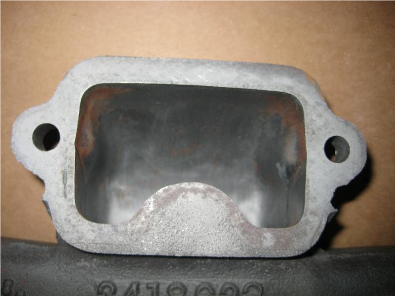

About 15-20 minutes with a die grinder with a quality bit/bits you can open up the exhaust pipe flange and smooth it and match exhaust ports to gasket will do more than extrude hone for way less money.
There is a bigger diameter exhaust flange on HP manifolds which accounts for the extra flow numbers everyone thinks they are getting from HP manifolds. Think hot gasses need more volume to escape.
There is my 2 cents take it or leave it.
When I first heard of extrude honing, it was new and innovative. It also posibly put a kink in Brezinski's profits (as they were hole-sawing small block Chevy intakes and exhaust manifolds to hog them out internally, then welding it all back together to look factory, for the dirt track "factory parts" classes.
Extrude honing only follows the shapes that are already there, just makes them bigger and smoother (or to a desired smoothness). There are various grits for that purpose, just like sand paper. Key thing is that all of the internal surfaces are done, not just the easier ones to get to (which explains why Brezinski hole-sawed them to get to those places).
Past simple gasket matching, use a bore scope to look for any other internal casting flash areas that might need attention. Then determine how to get to them, as needed.

Extrude Hone AFM quoted me $800 & if it works well in my opinion it is money well spent cause I just plain hate the constant maintenance of headers but obviously if there isn't really any gain then why bother
