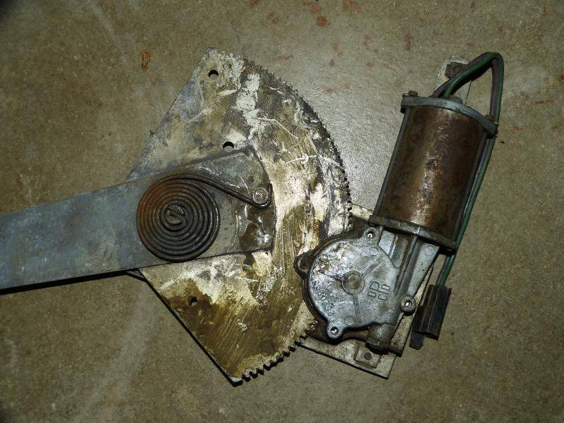

I am still having problems with the installation of theelectric windows in the 65 Chrysler. Theshop manual has all the detail as to the parts and adjustments. However, there is no detail of thespring. I have installed the driver’sside windows so many times that my skinned thumb is now healed. Many times I have pulled the electricalconnections apart or the spring drops out. The last time the window was in the up position and the spring droppedout. It has dropped out when it was in thedown position. I took pictures of theregulator and spring when I took it out of the car and it is installed the sameway as when I took it out. For C Bodieshas always been a great resource. I amhoping that someone can give me some detail and or tips to help me out. I got the take out and installation down to a15 minutes. I am willing to tryanything.
Here is a picture of a '65 C-body left front power window regulator.
If the spring that keeps falling out is the one in the center of the regulator, then it isn't wound tight enough. The spring should be under tension even with the window in the up position.
That helps greatly 65 500. My spring was way too loose. Will reinstall this AM and let you know how it goes. Thank you, Boyd
You probably need to wind it one turn, put it on the center slot and wind the hook end around to preload the spring maybe more.
Everything is running fine since I tightened the spring. But, now I am dealing with the window tilting rearward and binding. I am not sure if it is the window motor position on the regulator or something else. Spent a day on this, but I will not give up. Any tips are used and appreciated.
At this point I would make sure that everything is lubed up and moving freely as well as the rollers and tracks being in alignment.
I'm not sure on your tilting problem, it sounds like the glass is coming out of the channel. I doubt that it has anything to do with the window motor, unless the glass is hitting it, in which case you should have 10 million little pieces of glass any time now.
