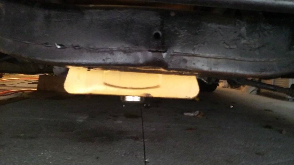

Milodon Street and Strip Oil Pan Kits 31930
This is what I used on my 65. It doesn't touch anything from lock to lock on the steering, fits like a glove.
With that said, your 66 stub is different, if it would change anything, I don't know.
The pan hangs down 2" past the K member.
Overkill for most applications-your results may vary
I have a Milodon 7 qt on a 493 in my 66 NYkr. Not sure what model # it is (it looks like that 31930 from above) but at the time it listed A,B and E-body as the application, no C-body. I knew the big block A-body needed idler arm clearance and that the hot ticket for a stock pan was a C-body pan so I called Milodon to confirm and they said it clears an A-body idler arm so it should clear the C-body.
WRONG. No right turn Clyde.
We had to box a window about 4" long and 3" deep into the sump so the idler had somewhere to go when you turned right.
