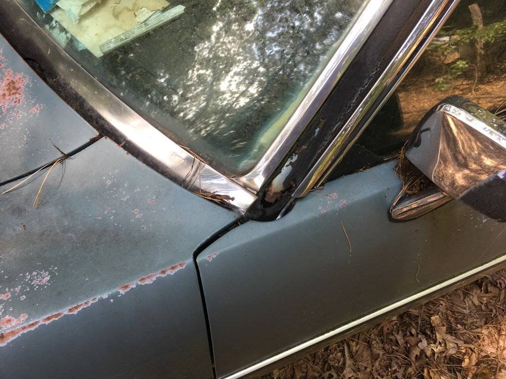

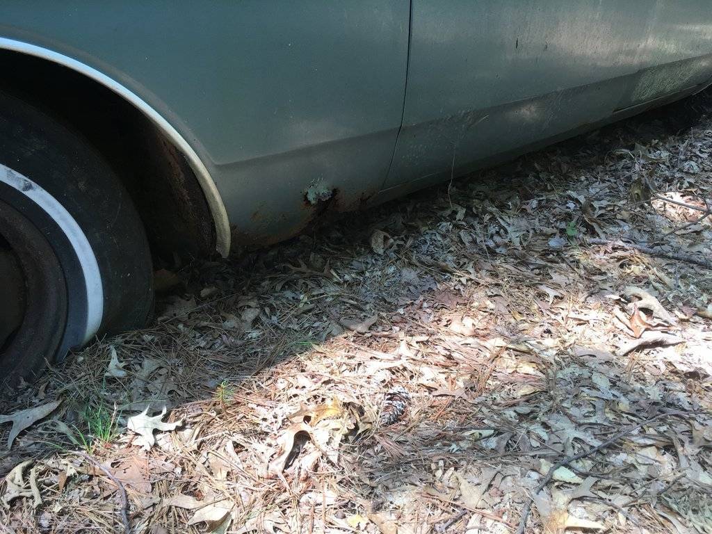

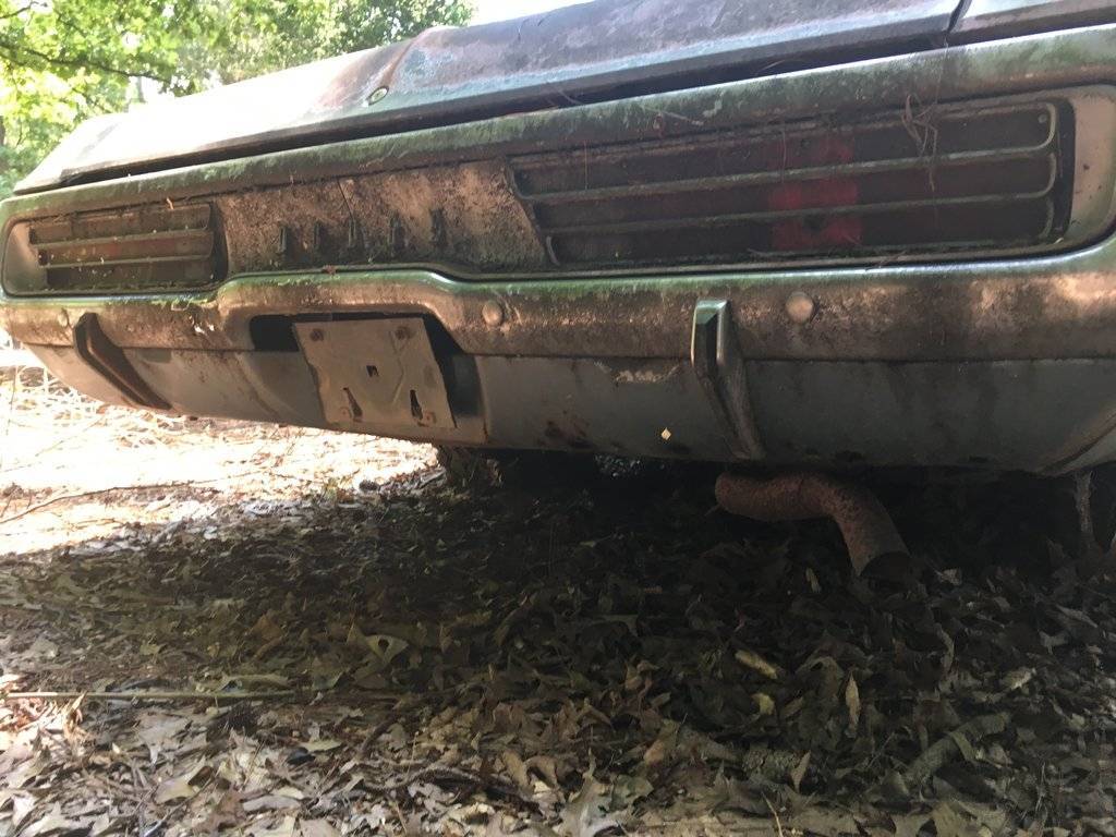

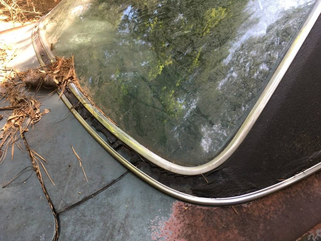

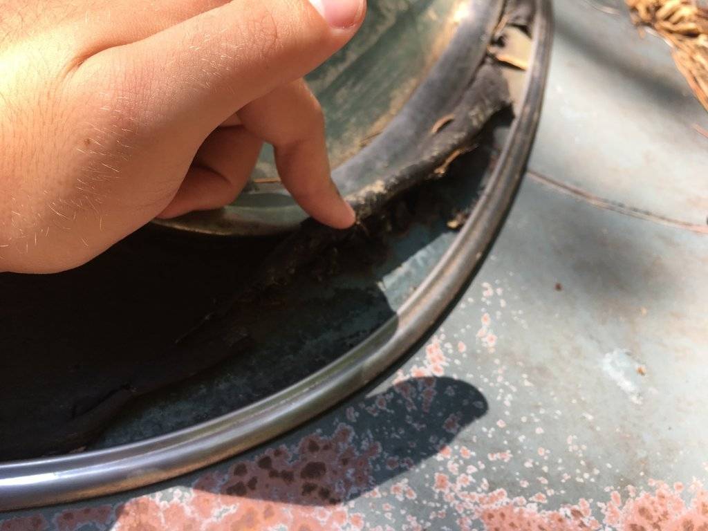

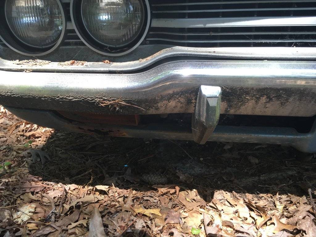

It has been a few months since I posted last, and in those few months I have gotten a lot of positive remarks on the car spanning from engineers at Hotchkis Sport Suspension in California to a guy I met at Carlisle with the very first 1970 Hemi Roadrunner. Now that's all fine and good, but in order for me to start on the car I need a solid foundation. And after this car has sat under an acidic pine tree for 20 years in East Coast climate, she's a bit rusty. A pillars are gone, front and rear valences have spots completely eaten through, the rear window (under the rubber) has some small spots that are completely through, the left fender has a nice hole, and I have no clue what hides under the vinyl roof or under neath the car (it sits so low to the ground). I talked with the guy you recommended to me while at Carlisle (Mark I believe) and he said he has most of the stuff. I don't want to cut the entire roof off the car and would much rather have everything patched up. What's y'alls opinion on it? We all hate rust but I hate to replace the original sheetmetal.

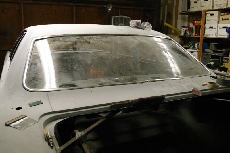

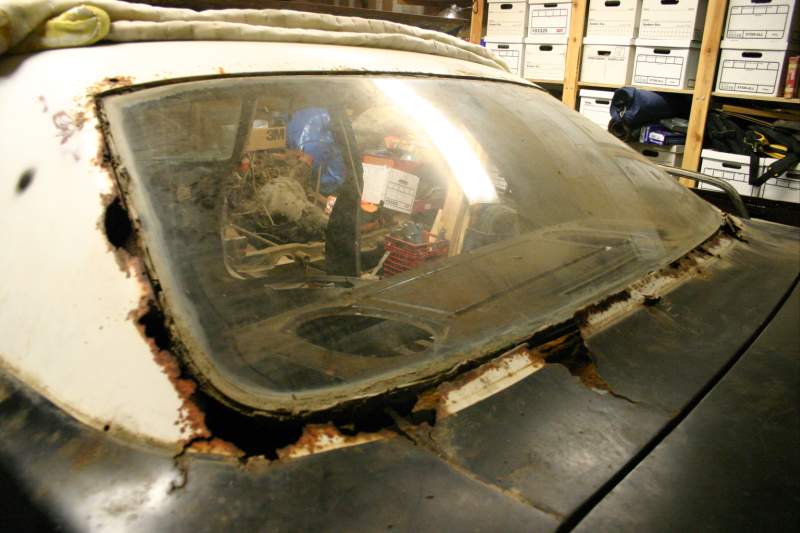

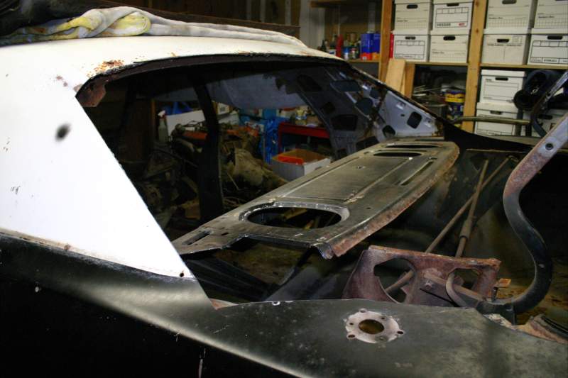

Which car would you rather work on...
This one...
Or this one...
And all done...
Just clearing the rust makes the project seam less daunting.
FYI, I knew nothing about bodywork when I tackled this.
Alan
Based on what I see, if you want to build a C body with a trick suspension, it would be best to start with another car.
There's just too much rot on the topside and I'll guarantee it's not any better on the bottom. If you change floor pans, trunk floor, frame rails and what ever else, and then patch the A pillars and the window surround, you'll still have a car that you're going to get real discouraged with every time you have to deal with a rusty bolt.... Plus you'll have way more money in the car over what you can purchase another 4 door C-body for.
I hate to discourage you, but I've seen so many projects start like this and get abandoned half way through.
I wish you luck.
That's a tough call. With bad A pillars, you most definitely need a solid parts car to do it correctly. It won't be pretty under that windshield chrome.

The best move right now IMO, is to get her off the dirt and carefully inspect the underside... stored like she is, I would bet on serious rust damage under her. If she doesn't scare you off, put down a decent tarp or plastic and block up the wheels on big pavers to minimize the bottom exposure. A car cover at this point is less important than the bottom.
Absolutely, you have to get air circulating under the car. Air circulation will dry it out and is the first step in saving it. I highly recommend you also address the existing rust as soon as you can because it will continue to eat it away. I remembered that you said you're in college and money's tight, that's why I suggested a rust converter. It's a relatively inexpensive temporary solution if you can't get to the car right away. Buy a can whenever you have the money and start with the worst first, wire brush the rust then spray with a rust converter.

When I saw the rust through on the front bumper I knew things had to be bad. Can't recall the last time I saw a rusted through bumper. That alone would make me dread what I am going to find once the car is jacked up so I could look under. That is assuming there are safe and strong points for jack stands.
The bumpers are solid. It's the lower valences that are rusted through. I know the trunk pan is good. I don't know about the floor pan because all the original interior is still in it but I think it may be ok
If that car has solid floor pans I'lleat my hat.
