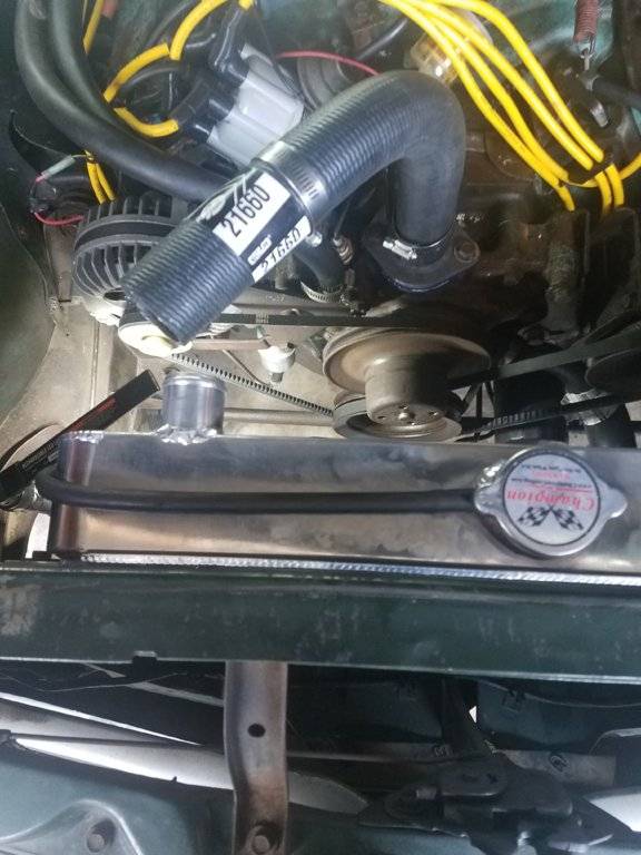

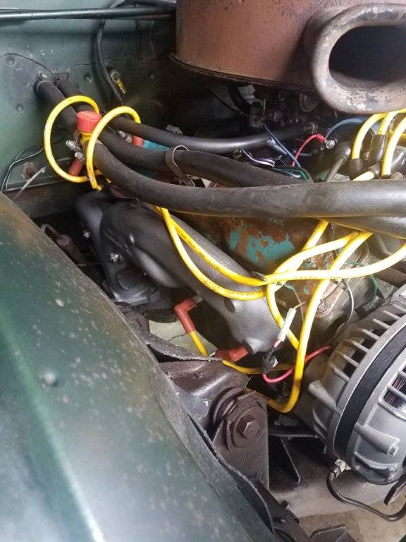

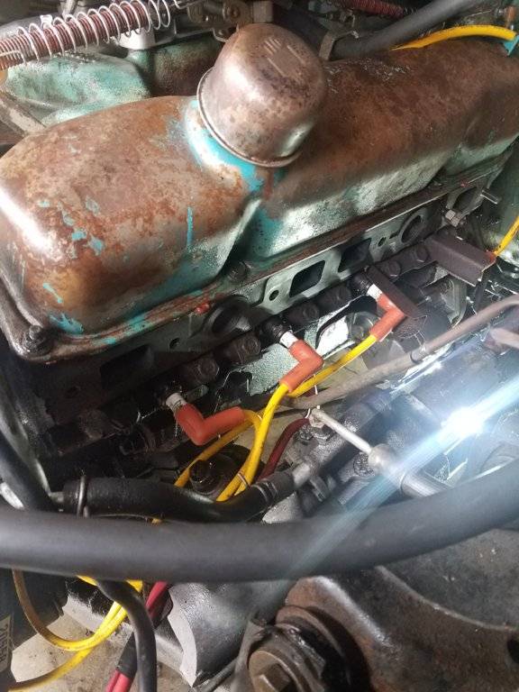

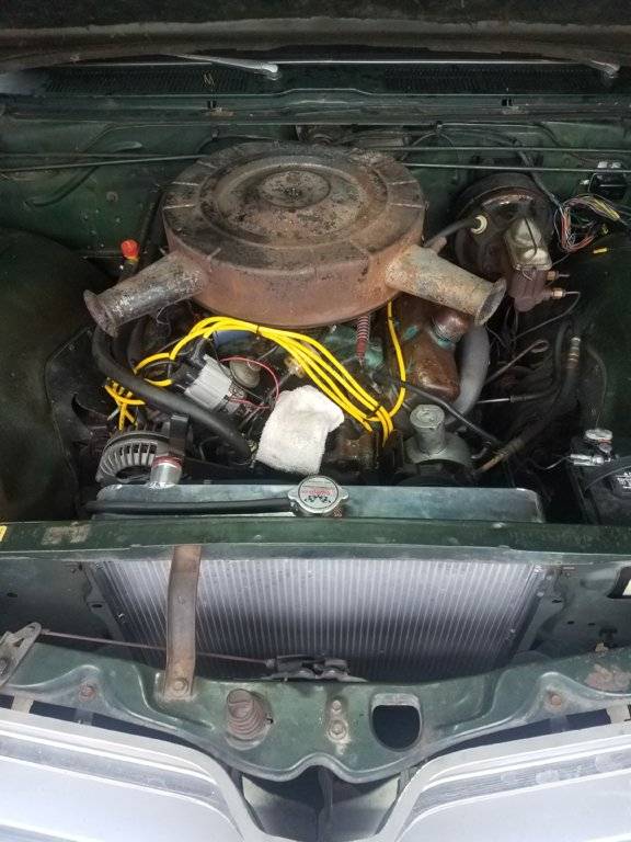

Had the day off and its a heat wave here at 54degrees! As soon as the sun got up i was in the barn wrenchin. Installed my new 3row Champion radiator and installed new tstat. Also got my exhaust manifolds off and installed new studs and nuts with my HiPo exhaust manifolds! Man do they look good compared to the stock logs! And i installed a high torque mini starter! And its not even 1:30pm yet!
Its the CC2375B part # im pretty sure. Its a little shorter than stock and i am having radiator hose issues with it. Trimmed the bottom hose and top hose wont work. And i had to trim for the bottom bolts to work but otherwise im happy. It was $202 shipped. Cost less than a recore and its a 3row
I had lower hose issues. I know that I had to get three different hoses before one was long enough.
