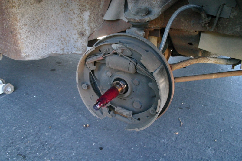

Ball joints in hand I set off to do them and pulled the drum saw some very clean raspberry grease, never seen colored grease before. A couple things I notices were the pads were almost gone and the adjuster cable was on its last thread literally. Before I started taking things apart I noticed that they didn’t look as bad as it drove so I started moving things about and then saw the idler that was totally shot with lots of vertical movement and the ball end was separating. I put it back together without doing the ball joints and before lowering the car back down I put a bar under the wheel and checked the play, pretty much none (control arm was supported). Off to order an idler.

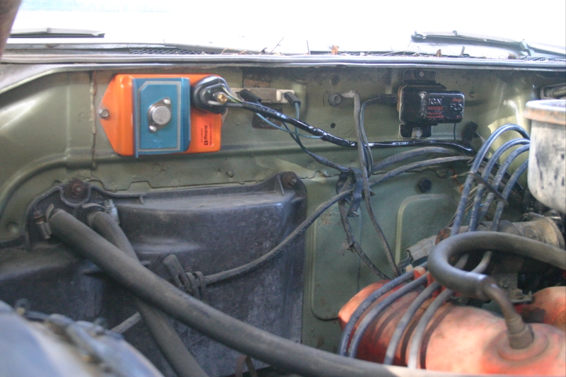

Project two that I had planned that day was to upgrade the ignition to electronic. I chose to just buy the Mopar box and pigtail and buy the distributor at the local parts store, total cost was about $100, far less than the Mopar kit. I didn’t like the way the pigtail was arranged so I stripped it and changed it, the coil wire was put in with the distributor wires and the power made a u-turn and came back out right below the ballast where I was getting power. Now this is where I prove to the world I’m no mechanic, the car wouldn’t start not even a spark. Frustrated I called in a friend after having already tried the distributor over a full 90 degree range. He said it has a spark, he checked at the cap I did at a plug. Off comes the cap, no rotor? I asked the counter person if it had a rotor, didn’t matter I should have checked so I knew I wasn’t 180 out. Rotor in, timing checked it was good.
While he was there we checked the charging system as I have been having issues with dead batteries. I had to replace the battery that morning as it wouldn’t take a charge over night. It was determined that alternator and or the voltage regulator was bad, I chose to get and alternator and install a NOS voltage regulator I already had. On I went.

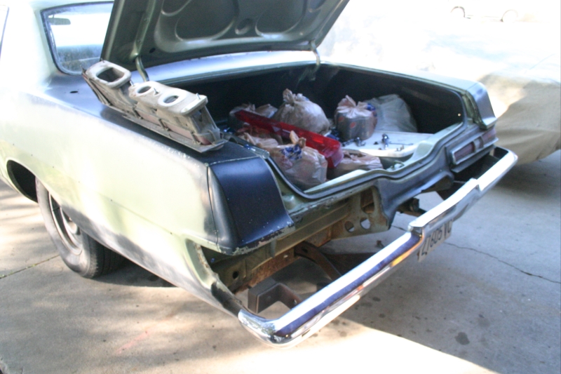

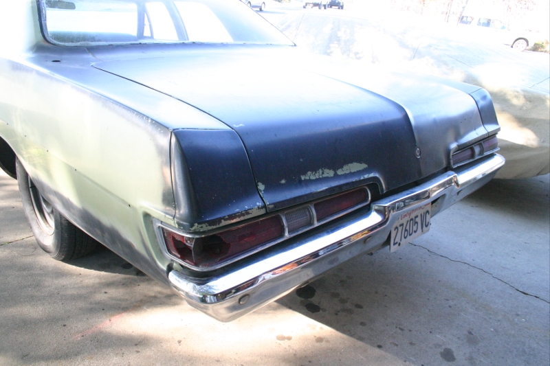

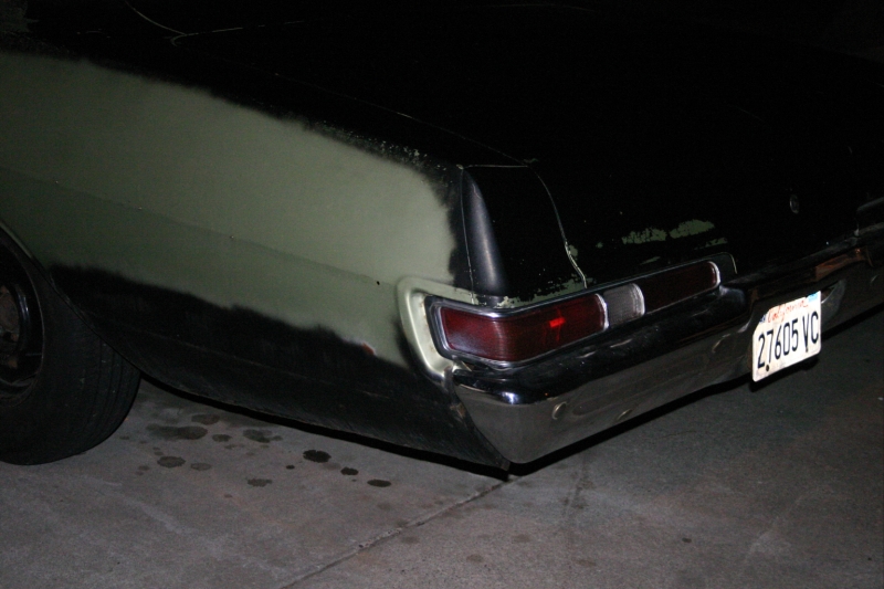

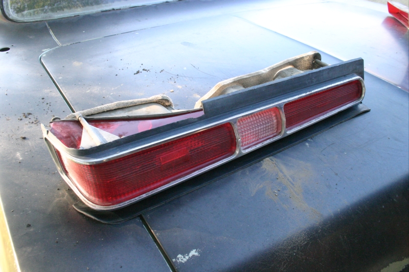

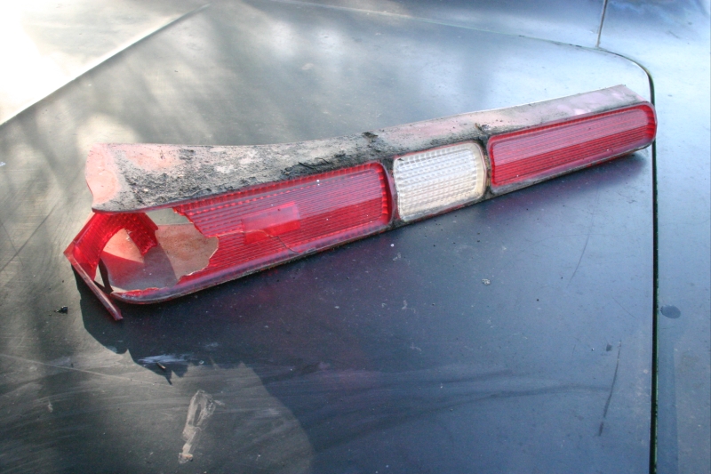

A few days later I get stopped by the local police for a burned out taillight and get off with a warning. That day I dug out a spare taillight lens as I figured I got lucky once. On the 69 Polara you need to remove the bumper the get to the taillights, I got lucky and was able to leave it hanging out several inches. Lens swapped out and put back together I replaced all four taillight bulbs and tested it. I turned on the hazard switch so I could test them all at once, nothing, should have know, it never worked before. Ok forget that, right turn, WTF? the two right taillight bulbs were blinking alternately in a wig-wag fashion. That can’t happen I must have a grounding issue, lets check the left, wait hazard switch is still on, turned it off now the right blinks normally, so does the left. Rechecked the hazard with both turns off and they still do not work.

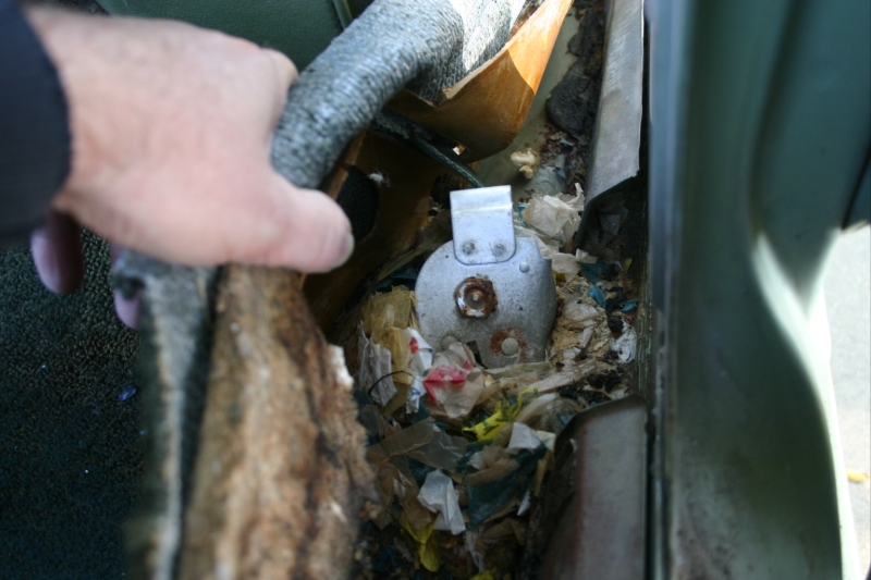

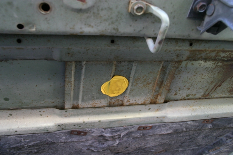

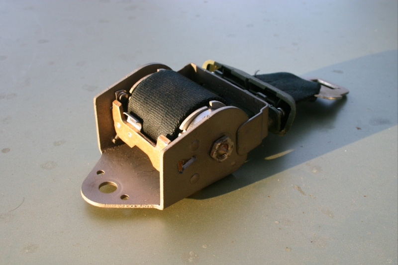

Some time ago I was informed that the passenger seatbelt didn’t lock so this afternoon I chose to look into it. I had a good idea that some tissue or trash had made its way into the retractor and was interfering with the mechanism.
The first thing was to put the b-pillar trim so I could get at it (sill plates were already off) and when I pulled the carpet back I could see the problem, I’m still not sure where all this trash came from but it was under the back seat as well. I vacuumed it up and pulled the mechanism out so I could clean it up as well.

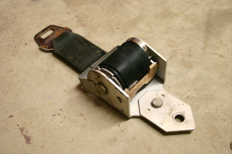

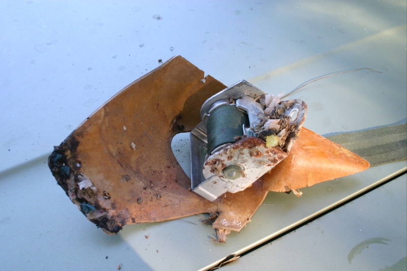

Even once I cleaned it up it still didn’t work, I could see the ratcheting piece wasn’t doing what it should. Still not sure what makes this thing tick I pulled the belt out fully so I could see if that made a difference, yuck, it was a mess between the trash and the rust the belt was like a rock so I felt it shouldn’t be used. Fine it doesn’t matter why it doesn’t work now, I’ll just have a black belt there.
In comparing the belts I noticed that the hardtop ones had an extension on the mounting tab, this was because on the 4-door hardtops had the belts mounted back 2” further because of the b-pillar reinforcements. So I guess I’ll need to rebuild the original one.
The first thing I did was pull the original one apart so I could clean the frame on it. Once cleaned it was painted and set aside to dry. I then pulled the pats one apart with care so I could see what went where (I still had one together as a reference).
With the paint dry I placed the recoil spring in place and wound it up enough to get the spool back in so it would help hold the spring. The main axle bolt was put in place but not threaded as I still needed to finish tightening the recoil spring. With everything loaded I was able to place the ratcheting spring (that was broken on the original) back on and test.
Everything worked as it should so it was installed and buttoned up.

Mouse house ya think? That is usually where trash like that comes from
and what was the time frame on that? I wish I had that kind of time, looks excellent.
I think the mice used the wire way as a tunnel where there is a separation right at the belt, still not sure how they were getting into the car, this was all before I got the car.

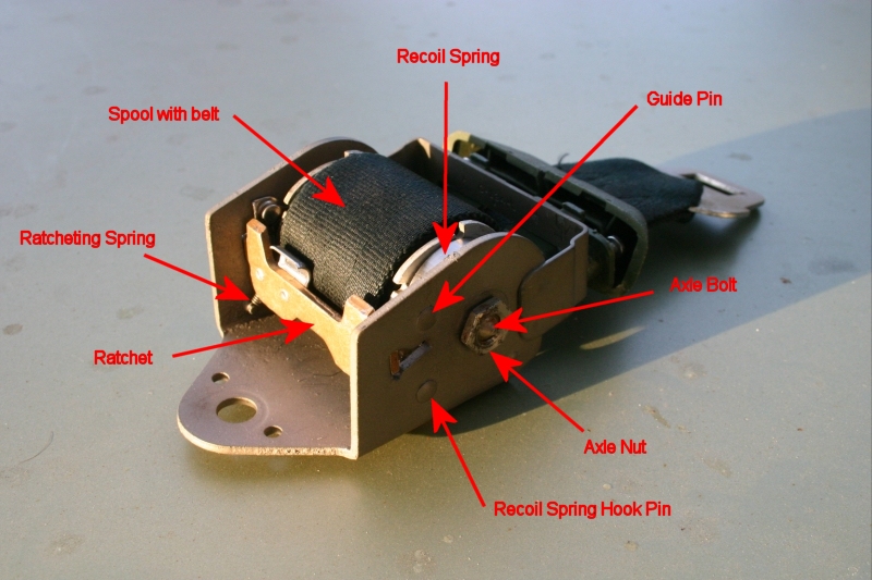

Here is the procedure (no pictures so you will have to use your imagination).
1. Remove the axle bolt (not the nut), when you do this the recoil spring may un coil a little.
2. Slide the spool away from the ratchet (or just remove)
3. Un hook the ratcheting spring (mine was broken)
4. Rotate the ratchet 90^ which will allow it to be moved more to one side for removal.
5. If it hasn't come off already remove the recoil spring, you may need to rotate the nut to release it (clockwise)
Assembly, here is where it gets tricky.
1. Coil the recoil spring up as much as you can (not important to get all of it)
2. Place the spring in place and insert the nut, rotate till it hooks the spring.
3. Hook the tail of the spring on the lower pin, check while tightening.
4. With a wrench coil the spring up more, it needs to be inside the guide pin. Rotate nut counter clockwise to tighten. Don't worry about getting it fully tightened. This is a three handed job so I doubt you'd get it anyway.
5. Once the recoil spring is inside the guide spring place the spool in but not centered, more to hold the recoil spring in place.
6. Place the ratchet back in. This cold be done first but it got in my way trying to get the recoil spring back in.
7. Hook the ratchet spring on its pin.
8. slide the spool in place and insert the bolt (do not thread)
9. Fully load the recoil spring (counter clockwise) Hold wrench on when done.
10. Thread and tighten the bolt.
11. Test.
Assembly time was about 10 minutes.
Hope this helps,
Alan

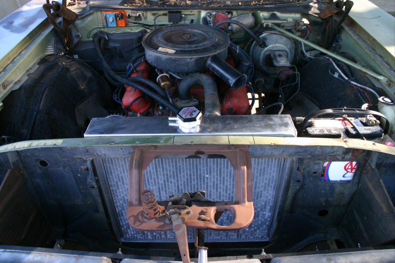

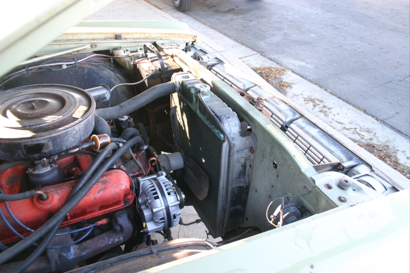

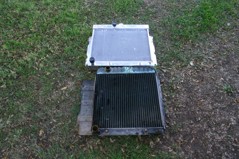

The other day while working on the seatbelt I took delivery of an aluminum radiator, $203 shipped from Champion. They do not list a radiator for a C-body with a 318 so I looked at different options first being the big block unit they did list. I saw a couple problems; first was the inlet/outlet locations didn’t work and would cost more to relocate, second was the size, I wasn’t sure it was setup for the standard core support or if I would need to swap the 26” one I also have.
In looking through all the different radiators they had listed for Mopars I only saw one that was ready to go for an early small block (driver side lower radiator hose). The Champion model EC1635 was listed for several different applications including the 1967 Fury. I felt I could adapt and drill holes easier than relocating fittings and swapping core supports so I ordered it.
Coolant drained I removed the old unit and then test fitted the new one, it dropped right on the lower two bolts so located the upper holes through the bolt hole and drilled them out. That do I bolted it up and connected al the hoses and lines then filled it up with 50/50. 2-1/2 quarts in and I was good to go, fired it up and checked everything, great no leaks. So I go to close the hood and bump? Good thing I didn’t just slam it shut like I typically do, the radiator was too high, and to double check this I put some putty on the cap and lowered the hood and pressed down yup zero clearance.
Great $30 in coolant and I wasn’t going to loose that, nothing to transfer it to I looked at options. First I put a jack under the radiator and removed the bolts, I then lowered it to a set of holes that were already there on the top and bolted it up. The lower two bolts were going to be difficult as the core support is double walled at that point and you cannot but a punch through them.
I loosened the two bolts and spaced the radiator out so I could see the holes in the core support, a little measuring I was able to locate the holes and drill in place. Once again I bolted it up and tightened everything again, closed the hood, done!
After a spirited drive I checked everything again and all go, didn’t even need to top off. The entire time the temp needle never left the bottom of the operating range.
