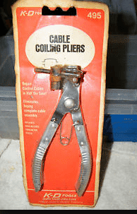

On another tack, I've since found that the inner cable seems to be .031", which is a common size for mig welder wire so you may be able to manufacture a replacement core if you can find both ends of yours for length measurements - and I think it was KD tools that made a tool to create the 'coils' on the ends of the cables as the factory did. Fuzzy on some of the details as I remade mine about 30 years back or so and have never gotten around to replacing the homemade one with the NOS one I finally found a few years back. (Although that's where I got the diameter of the inner cable since the new one's still hanging on the wall.) When I remade mine I was in a hurry and didn't find an optimum inner wire which is what makes it hang up on cancelling.

The tool is KD 495, doesn't show as a current offering, though.
