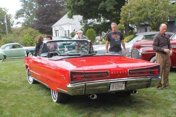

A 1966 Monaco convertible I am restoring which was built in Windsor Ontario and is a bit of a barn find. The body is finished and ready for interior unfortunately part of the benefit of the barn find was that raccoons got in and 8 a lot of the interior I have the frames but the panels and the interior foam excetera has been chewed up and pissed on badly. I have removed all of the crap from the car but it only has 88,000 original miles. All the panels on the outside were fine other than a little bit of condensation on the lower quarters which I've completely replaced with metal and I have also completely replaced for otherwise it's a solid vehicle. I think I have the interior sordid but my biggest question is should I put the original 318 wide body into the car to keep its value up. The Windsor built Monaco's had 318 as opposed to 383 engines. The car which I picked up from a custom motorcycle guy who was three-quarters of the way through the restoration is impeccable and he has purchased a lot of otm chrome parts and had Chrome redone. I'm also wondering if I should keep the fender skirts on and stick with 14 inch tires to keep the continuity of the originality of the car. Any comments would be helpful I have restored a lot of cars but never a Mopar.
Location: Ontario
What a great forum and this will help me immensely in trying to finish my car. My picture is what I'm working tonwards. I just need some good help with the interior I have the console and all the frame parts for the interior just need good upholstery foam and some guidance on what motor I should throw in it to keep it original. Everybody up here is telling me the 318 wide body is garbage but it's a Canadian car and that's what it was built with. The 383 is a great motor but am I better off to keep it original as the car is pretty solid and all the metal has been replaced

And unless you want the prestigious look, loose the fender skirts...but... here is one that pulled it off
