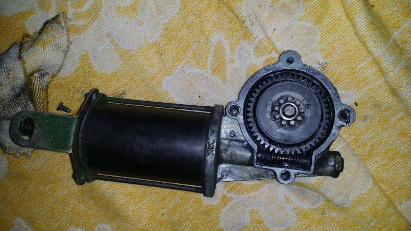

I have my driver's rear window motor out because it seemed pretty weak. It had trouble going up so I intend to lube the mechanism. Still, I looked at the motor to see if the plastic bits were worn but what I found doesn't look like the originals I have seen in other threads. Is this aftermarket or something? The teeth are plastic but the centre is some kind of rubber.
Agreed, that one is stock. No telling how much life that piece of rubber has left in it. I'd replace it with the nuts or other filling of your choice.
I think the electric motor itself works or it doesn't. Your tired motor is likely due to the rest of the mechanism needing a good cleaning and some fresh grease on all the moving parts.

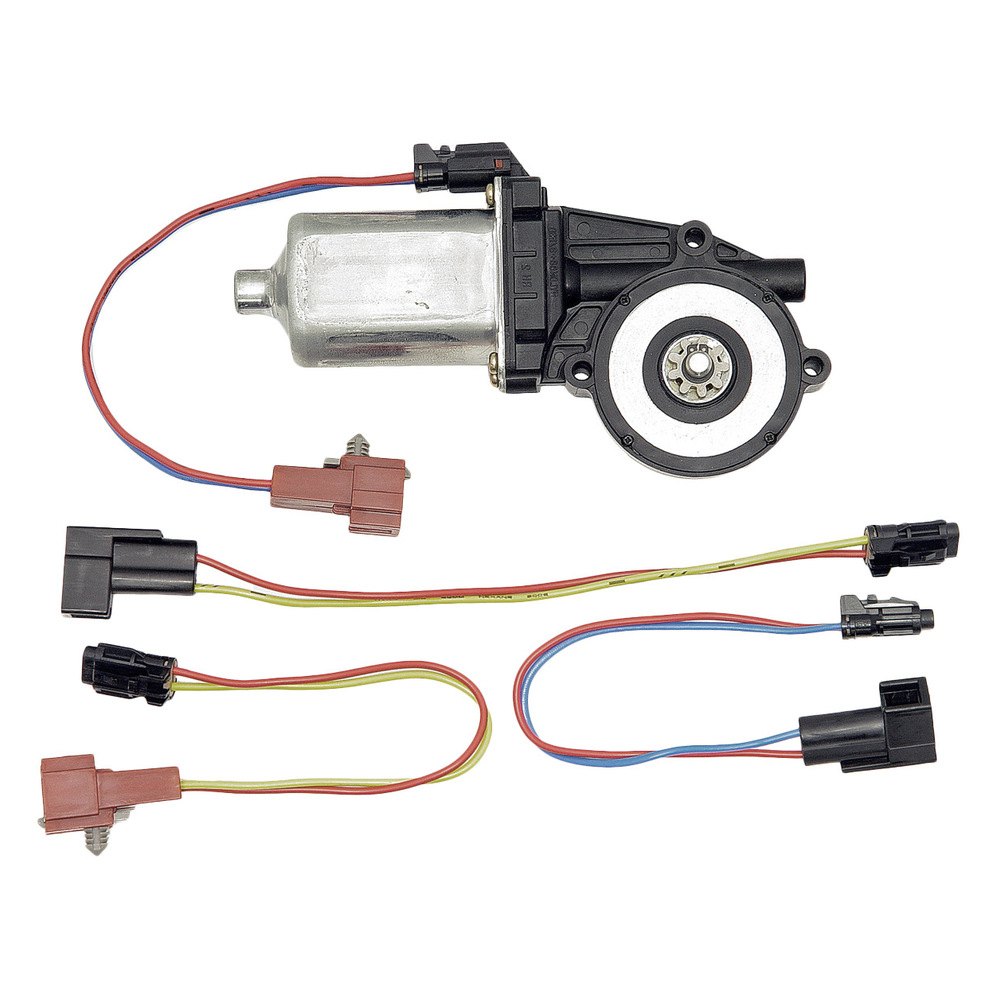

AZ for a C-body application lists a new Chinese motor that is actually for later year models.
It does not fit!
The three bolt mounting pattern is different.
Get the Cardone rebuilts.
If they hand you this one, hand it back:

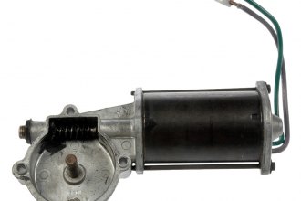

It has to look like the OEM one like this:
Notice that it comes bare. No gear and no cover plate. Even though some pictures will show it with the gear, it will come naked.
In other words, you cannot find out there a new or rebuilt complete motor with gear.

As much as I hate to admit when I'm wrong and others are right, against my religion you know, you guys were right. I pulled the regulator and motor and the tracks, thoroughly cleaned them, and used a non-grease spray on lubricant and now the window goes up and down faster than the others. Of course this means I have to remove and clean all the others, now. You bastards...
