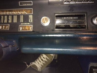

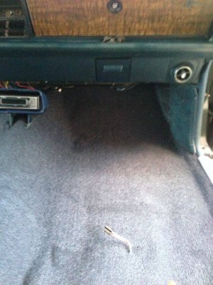

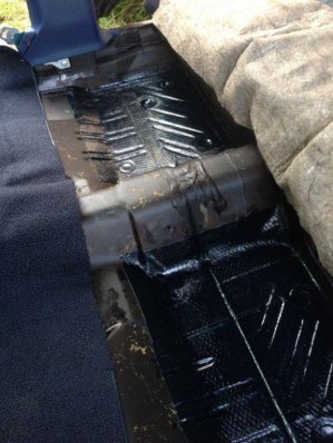

Looks good! But personally, I would grind the rusty parts to bare metal and remove all rust before treating the areas with the rustol. Looking forward to see more pics!
now ther's a big hole on the top. i will fix it later, the most important is that everything works now.

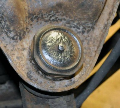

Lower ball joint thread in / press in?what is the diffrence ?
....The '69 Imperial only Pitman and Idler Arm are not available new. Firm Feel can rebuild your cores if you send yours in. For round about $450 each, IIRC!!
Hi Fred,You have encountered the same thing that I did with my ‘67 Crown Coupe in early 2013. After reading much discussion about idler arms, I went against the purist and purchased a Moog K7014 steering idler arm. I, also am a scientist (Ph.D. Engineer) by trade, and arrived at the same conclusion that you did. After replacing the idler arm, I had the front end aligned, as you suggested. The drivability is excellent, so I would say follow you reasoning and use the idler arm that you have. It is probably the same as the one that I used, and is listed for use on 1965 – 1973 Chrysler vehicles. The current price on Amazon.com is $37.99, so you got a real bargain when you bought it from Rockauto.
