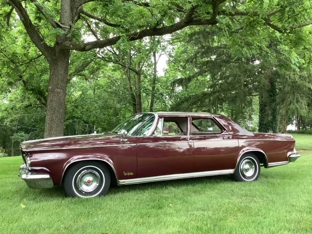

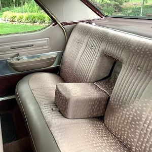

It is a 1964 Chrysler New Yorker Sedan, two tone Royal Ruby Iridescent and Rosewood Iridescent, with a two tone interior that coordinates in Mauve seats and door panels, and a very dark maroon dash pad and carpeting.
It has had one amateur driver quality repaint, and the interior and drivetrain are original unrestored. The body is remarkably sound. I'll tell you why.
The original owner of this odd duck was a FUNERAL DIRECTOR! For 24 years, this car was used by a funeral home in Johnstown PA to transport people and flowers to funerals. You know how funeral homes are with their official vehicles - they are kept spotless! Then, in 1988 it went into collector hands, for recreational driving and car shows only. I guess I must be the fourth or fifth owner. The last owner had it for 15 years or so.

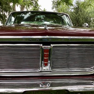

I have purchased an entire grille on eBay (not a charcoal grill) to get the red medallion which is missing on most of these cars.

Beautiful! Never seen one this color. The seat uphostery fabric is rather unusual!
