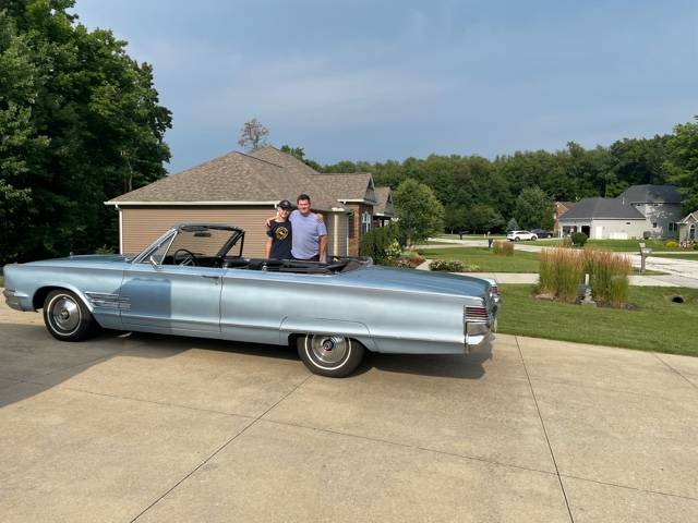

My son and I have almost completed a 300 driver.
He's 16 and loves road kill. They inspired him to educate himself about everything classic auto. This 300 is our second classic garage restore. We bought this car at an auction from the estate of a former 300 collector. This car was intact but wasn't running and had rust. My son got it running fairly well, and he fabricated and welded in new floor pans. We did the body work and paint.The only remaining issues are front bushings and there is an engine hesitancy. I think the engine issue is timing but if anyone has a suggestion - we would love to hear from you.

Check the vacuum advance on the distributor for your hesitation. I will effect low speed and throttle response. If you manually apply vacuum to the tube it should move the arm inside the distributor. Then maybe carb accel pump if your timing is correct.
