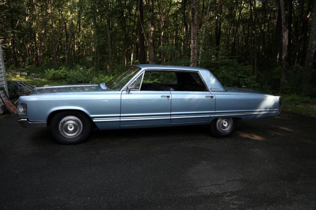

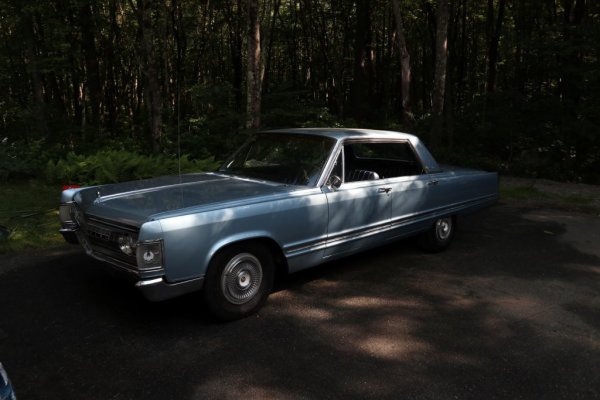

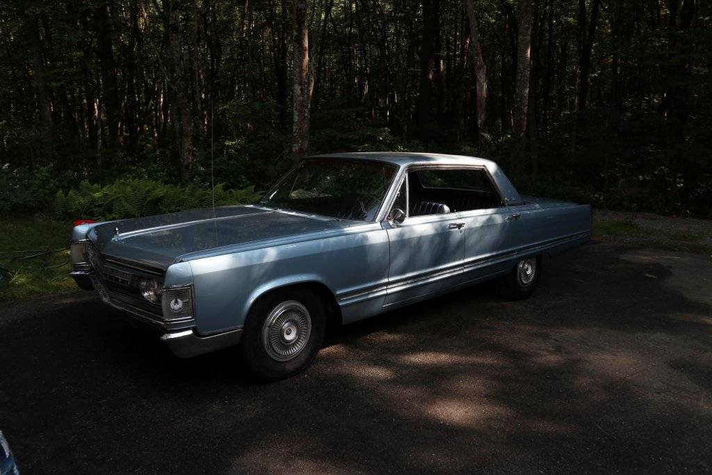

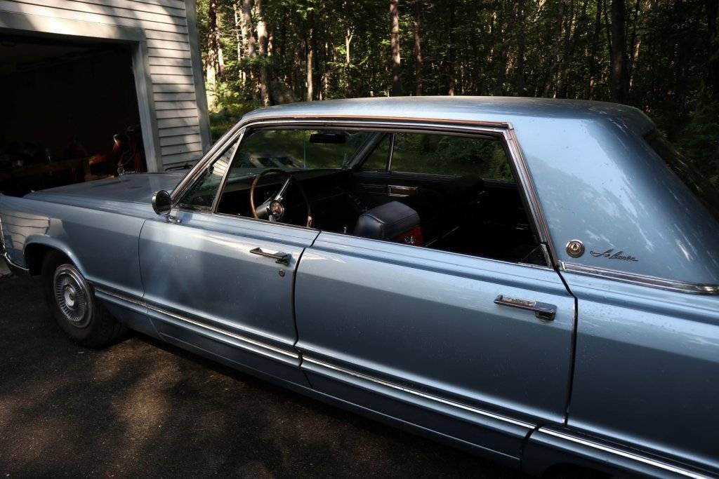

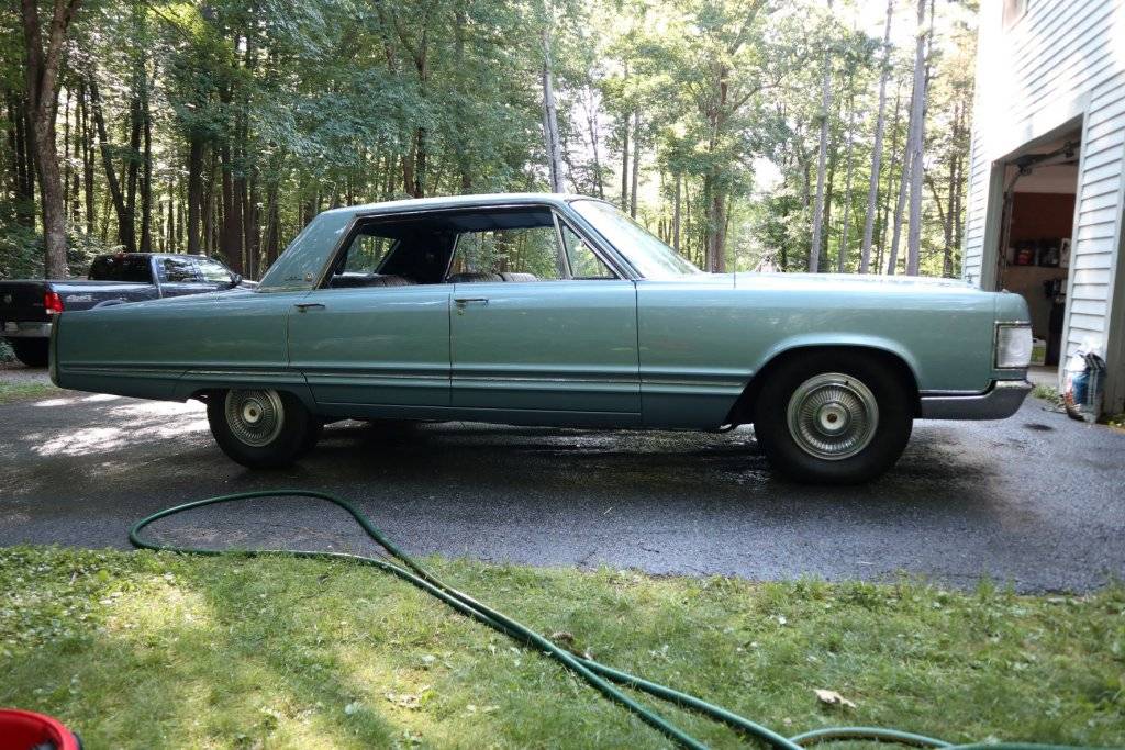

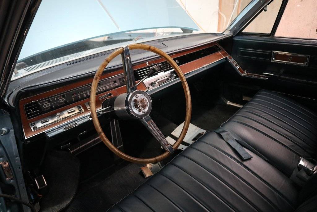

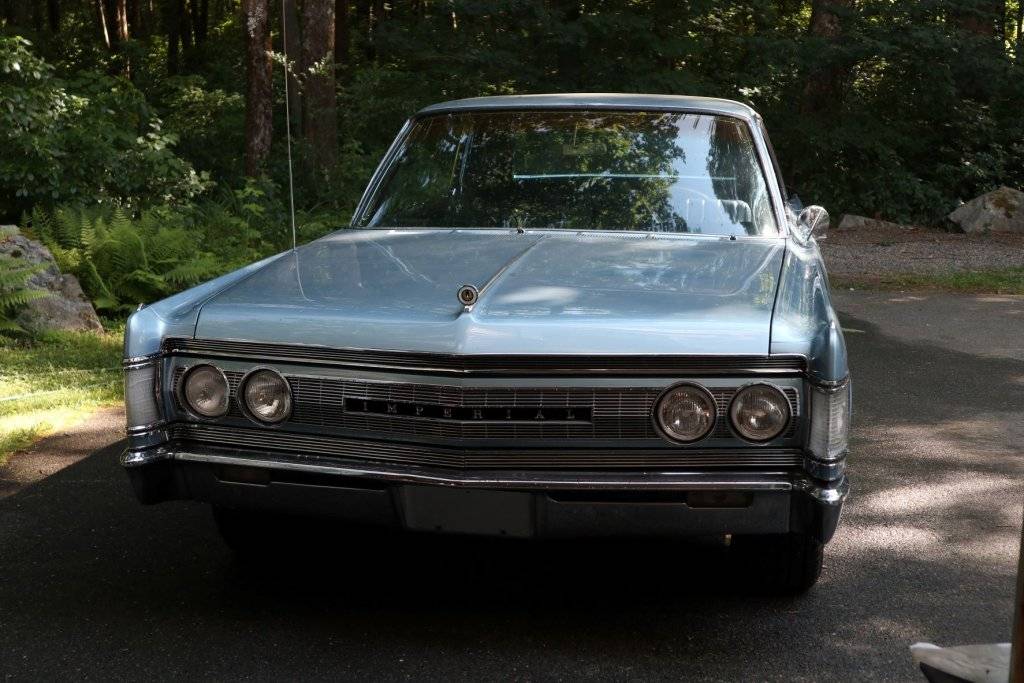

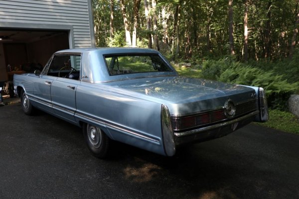

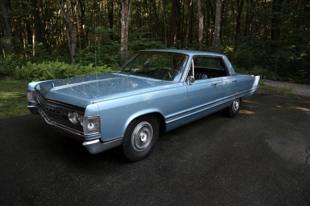

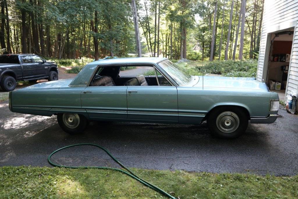

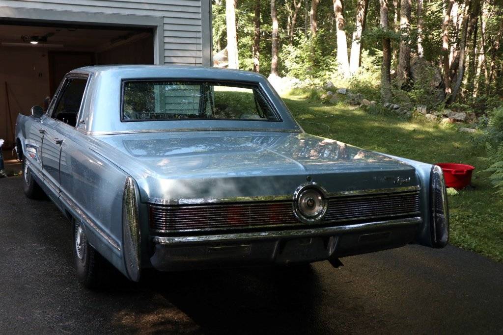

View attachment 480923 View attachment 480927 View attachment 480928 View attachment 480932 View attachment 451597 View attachment 451611 View attachment 451615 View attachment 451782 I started with a solid Arizona car, for 3500. it was mine and I felt I had to rescue a piece of automotive history and a time of elegance. I had the body stripped via soft plastic shot, like new old stock when it was done. Brought it back to a local automotive body shop repair for the paint...Wedgewood Blue.

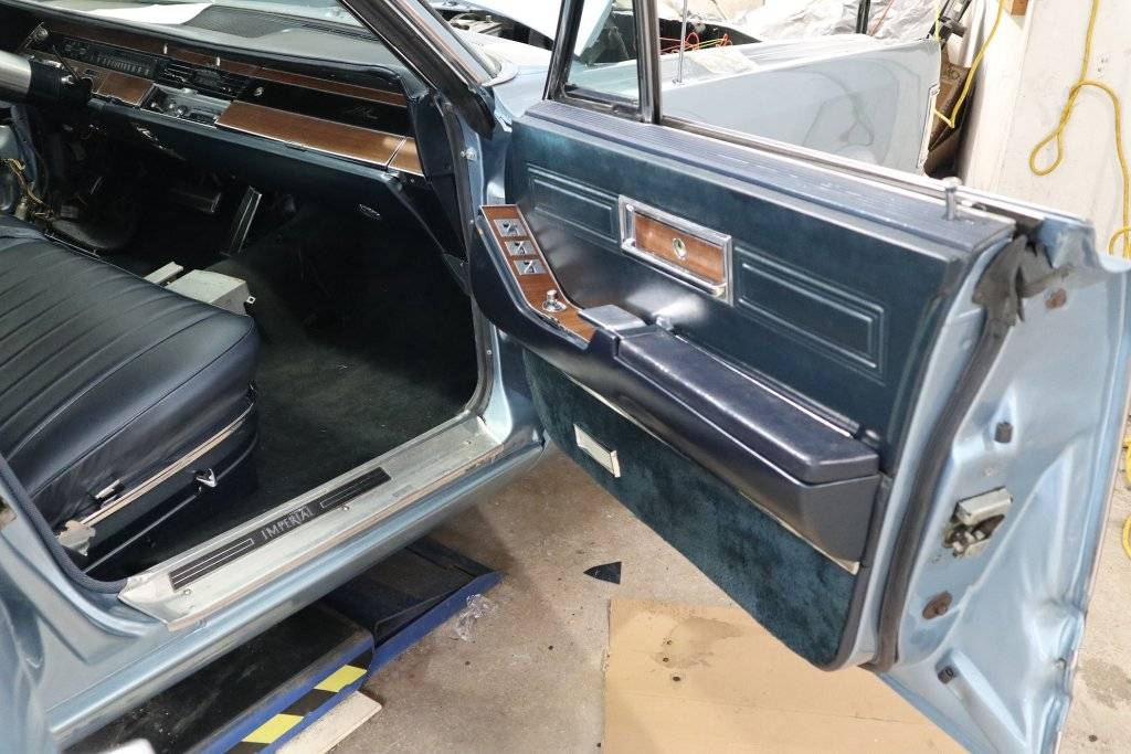

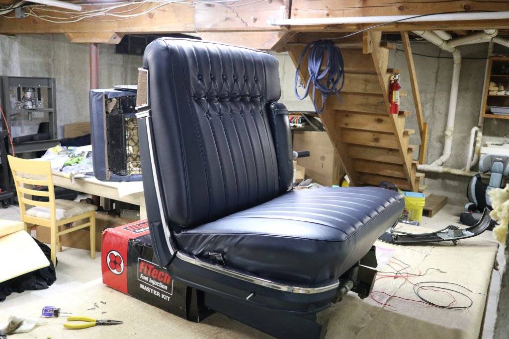

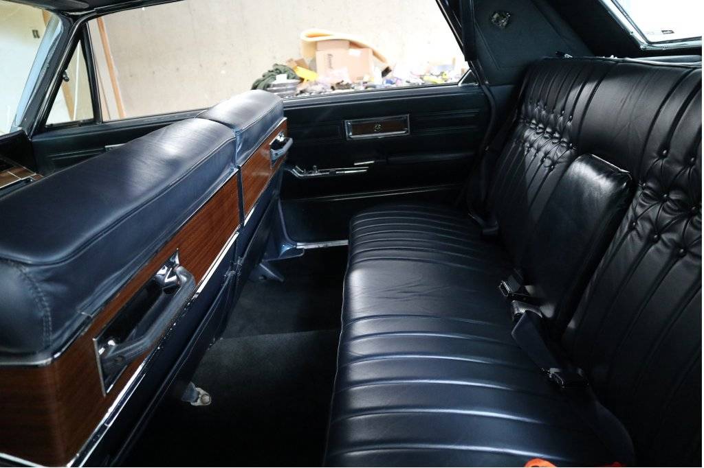

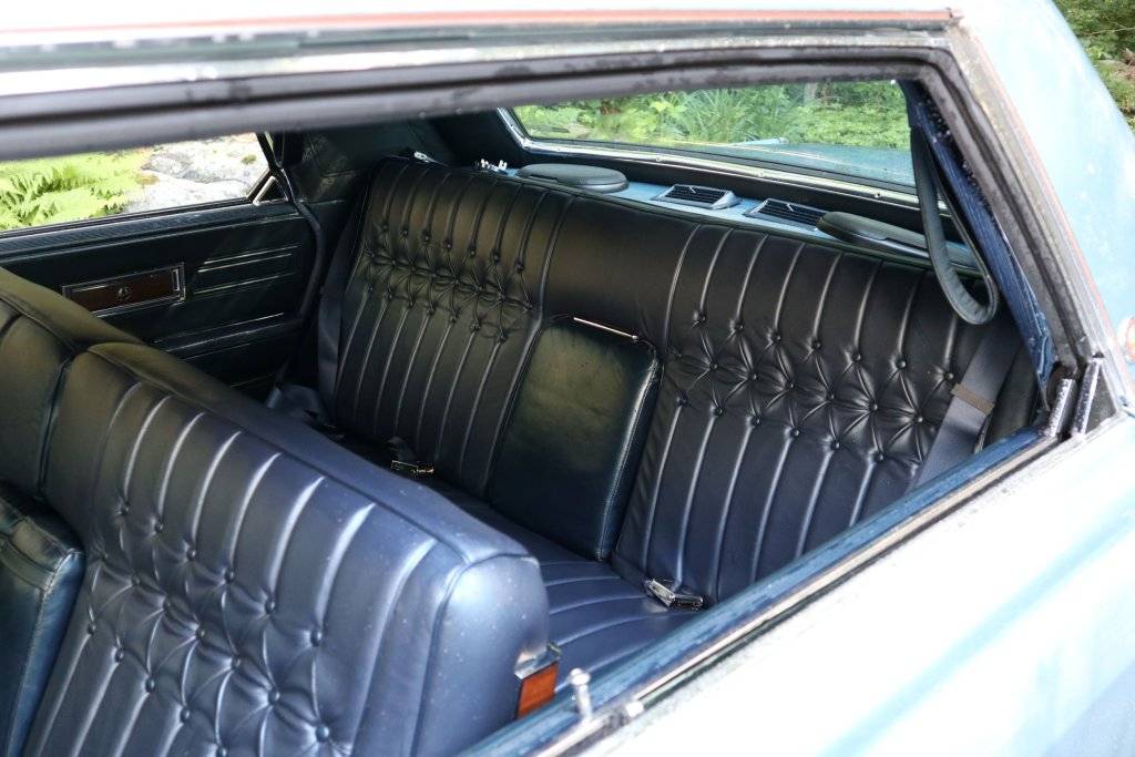

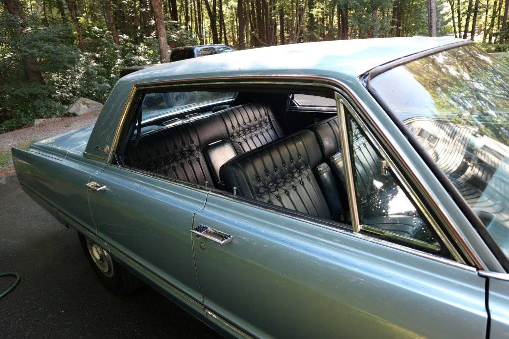

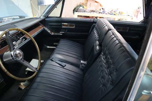

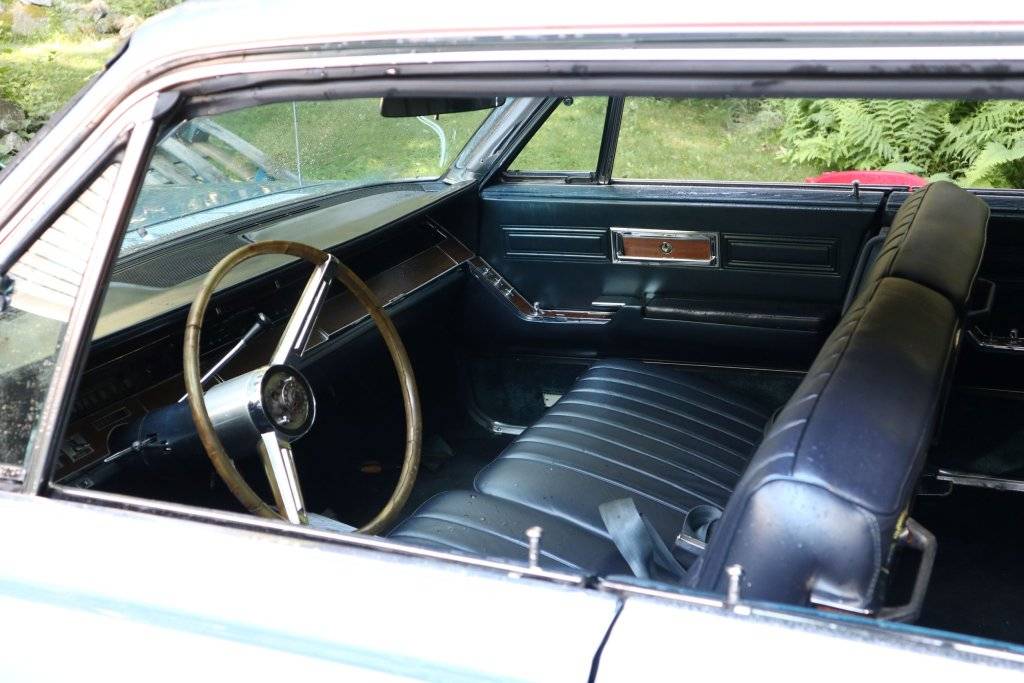

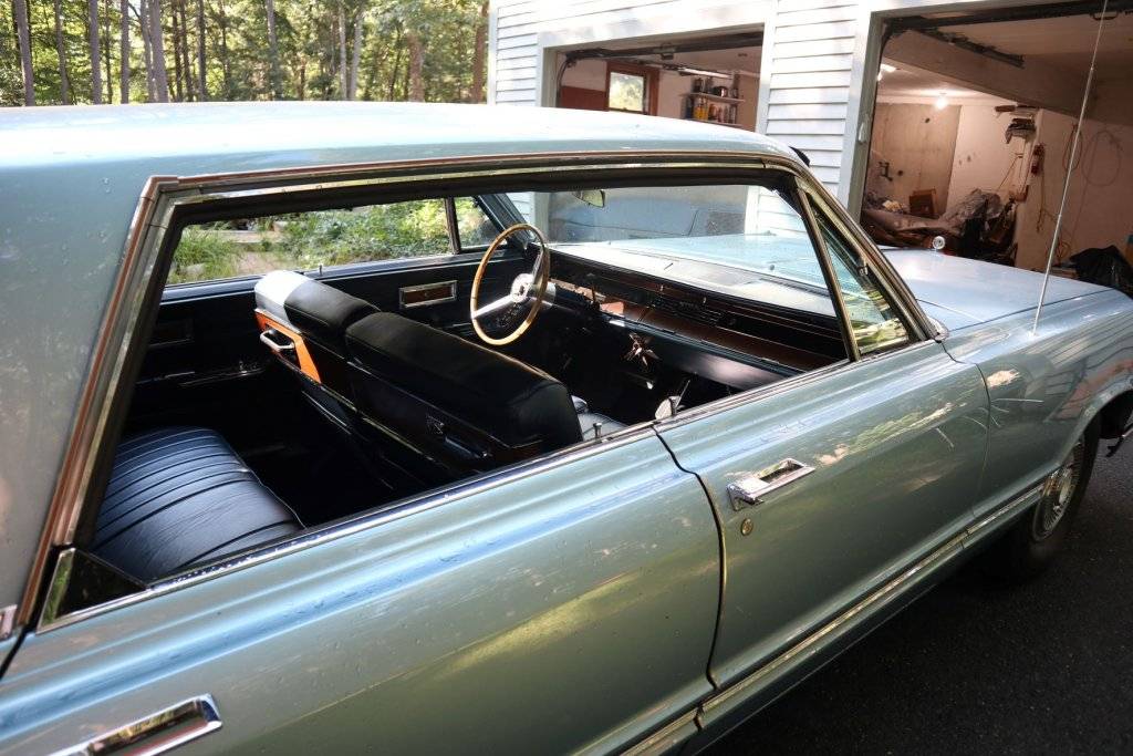

I completely striped the interior, out came the seats, I reupholstered them using SMS Auto Fabric...leather seating. I had to supply the patterns. New foam, cotton batting and burlap.
Pulled every wire out of the car, removed the vinyl tape and checked condition, replaced where needed, soldered where needed, bought vehicle electrical wire and other electrical goodies to make it safe and remove any chance of a failed wire that could cause burning.
I pulled the dash out, windscreen front and rear, and door glass, everything came out.
I had to find another dash pad and get SEM color match to spray, bought walnut wood veneer to apply to dash surfaces, looks nice!
I am in the process of re-assembly and anticipate it being on the road in 2022, summer of.

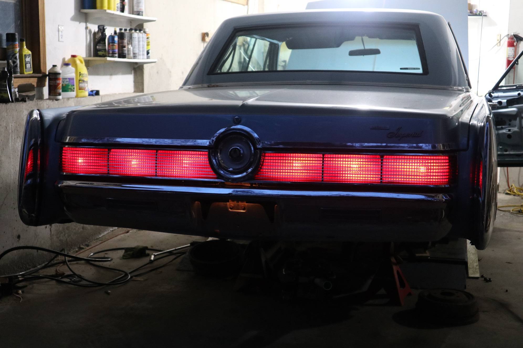

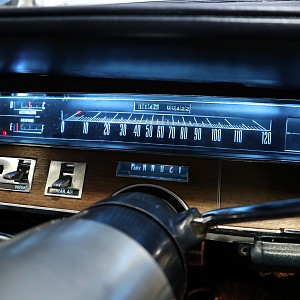

I completed the check-out of DC voltage through 50+ year old wiring...no burning, no fires, all my electrical repairs are good. I had to remove the Sentinel amplifier and re-wire for lights. All directional are working, turn signals, flashers, brake lights, etc.; I did make a few upgrades to lighting, the dash has LED bulbs and the headlights are from Vintage Lighting and are LED [very bright], tail lamps are Sylvania super bright and everyone can see me.
I am now working on the Fi-Tech fuel injection connections and getting the engine bay wiring squared away...should be firing up in December.
Latest updates

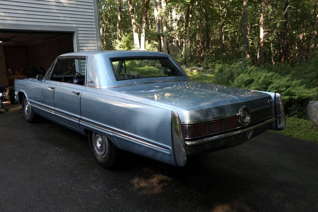

Here goes...interior is all in, electrical gremlins worked out, engine fired up with new electronic distributor and FiTech fuel injection...now I have to time the engine and get her running smoother than it already is. Power steering gave me a headache when it did not want to let me turn the wheel...kind of intermitent. Brakes work although I have a small leak...damn these Budd calipers. As you can see she is clean and I rode around the cul de sac a few times...no issues, just need to set the torsion height and get things lelveld out. What do you think? And yes, it rides like an old car.
Interior coming along nicely...the little things slow me down...will be on the road this summer/fall

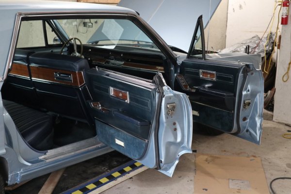

Nearing completion, electric window mechanisms, door handles, lock and latches all installed. Working the glass and roof-rail weather-strip, then front seats, door panels and run it up.
Wish I had the skills to do work to this level. It will be a beautiful car when finished and I am looking forward to seeing it when it is. Thank you for the pics and comments:)
Takes patience, I manage my expectations where it comes to what I can get done on any given day for an hour or two...by the time a year passes I am well on my way on disassembly and now reassembly. Door glass is going in, all locks and mechanisms are in...slow and smooth. Getting it done! I will have to post updated pictures soon.
Hello everyone who loves the Big Ladies! An update since last, I have installed the steering column after completely tearing it down, servicing worn coupling and replacing telescopic turn signal switch...a small amount of reengineering, but done!
Secondly, if you look closely you will see that all the door glass is in and currently still awaiting me to make cant adjustments, etc.. All the window motors and gears/bushes, etc have all been serviced with new grease and a magnet needing super glue on the housing. Everything works as I bench tested with a 12V battery. All the locking and door handle mechanisms are in and work great!
I have all new rubber weather seals for the doors...shut like a vault door! Solid.
I have installed all the inspected and re-worked engine compartment wiring and waiting to apply 12V in a test, have a special fire extinguisher that will not cause wiring issue if used...like a Halogen gas...ready to test soon.
My issues are lack of replacement weather-strip and window channel guides and flocked plastic channel guides...but I made do with other like year C body reproduction items and just re-engineered.

The rear seats for 3 point seatbelt was easy, the front does not have a mount on the roof rail to mount [wouldn't want that ugly hanging there anyways. I will have a custom "H" harness for the front made up and bolt to the floor...still working that out.
