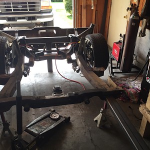

Presently under construction...

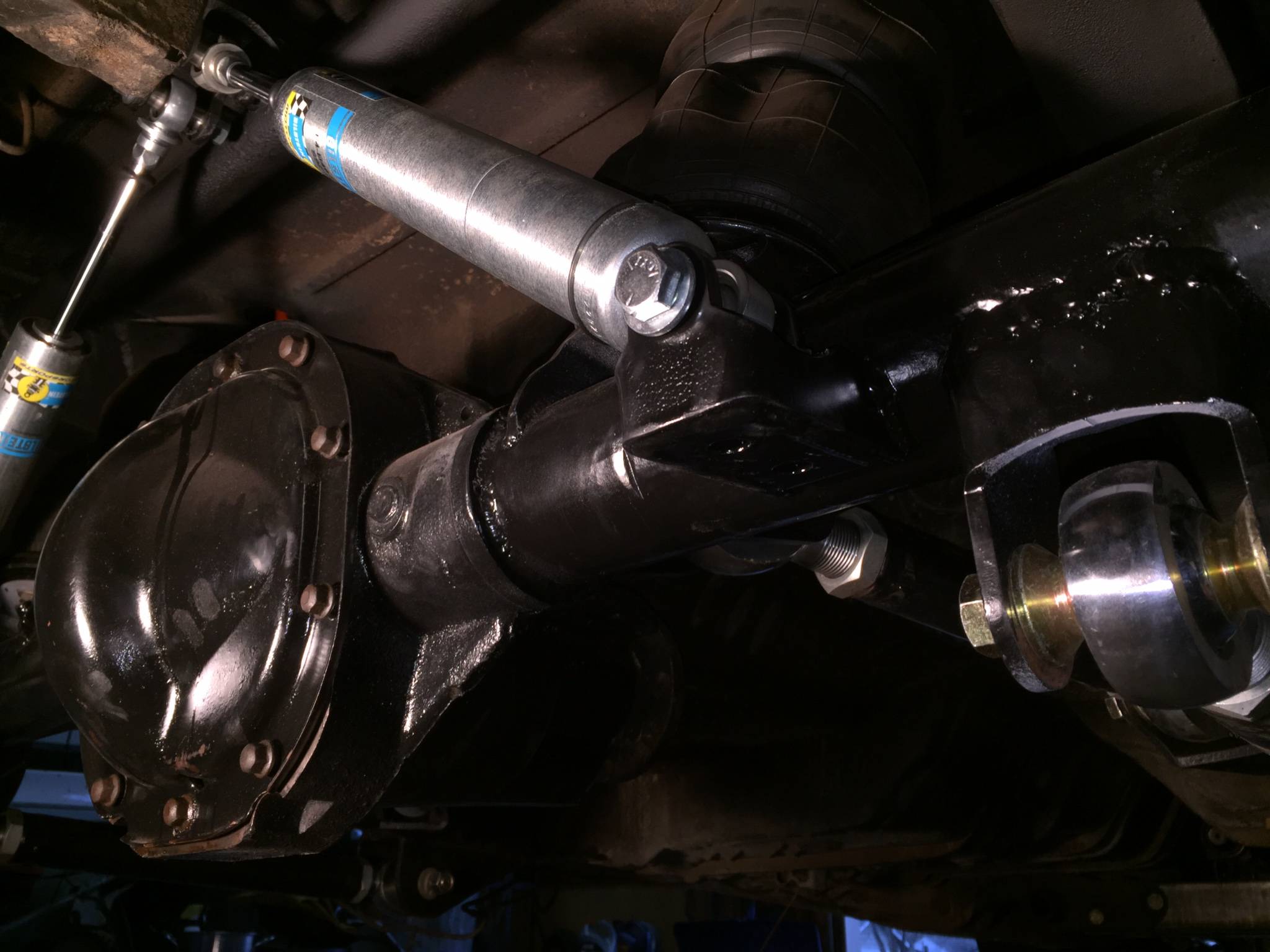

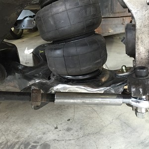

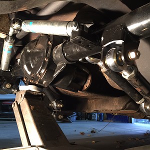

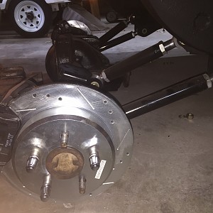

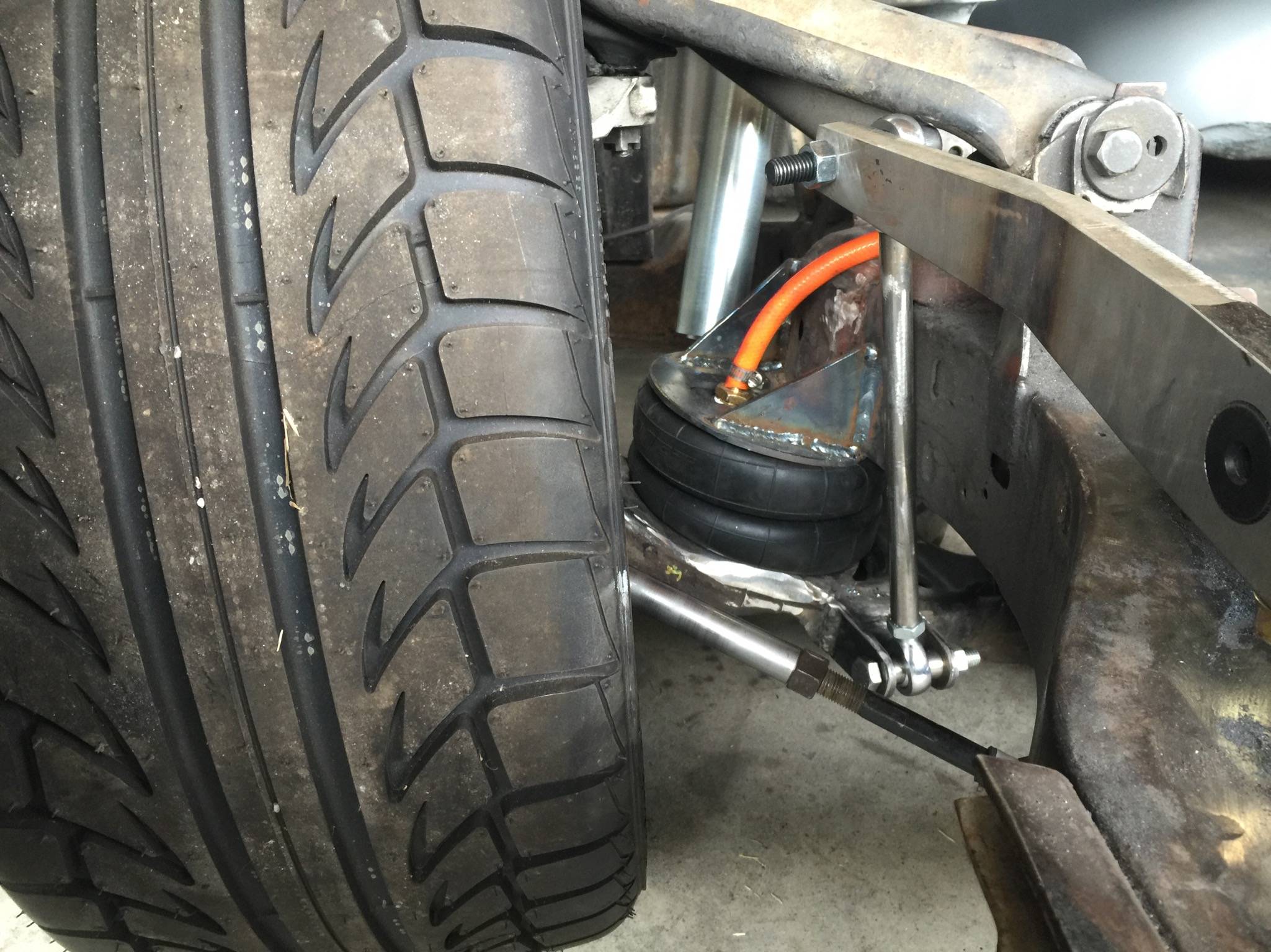

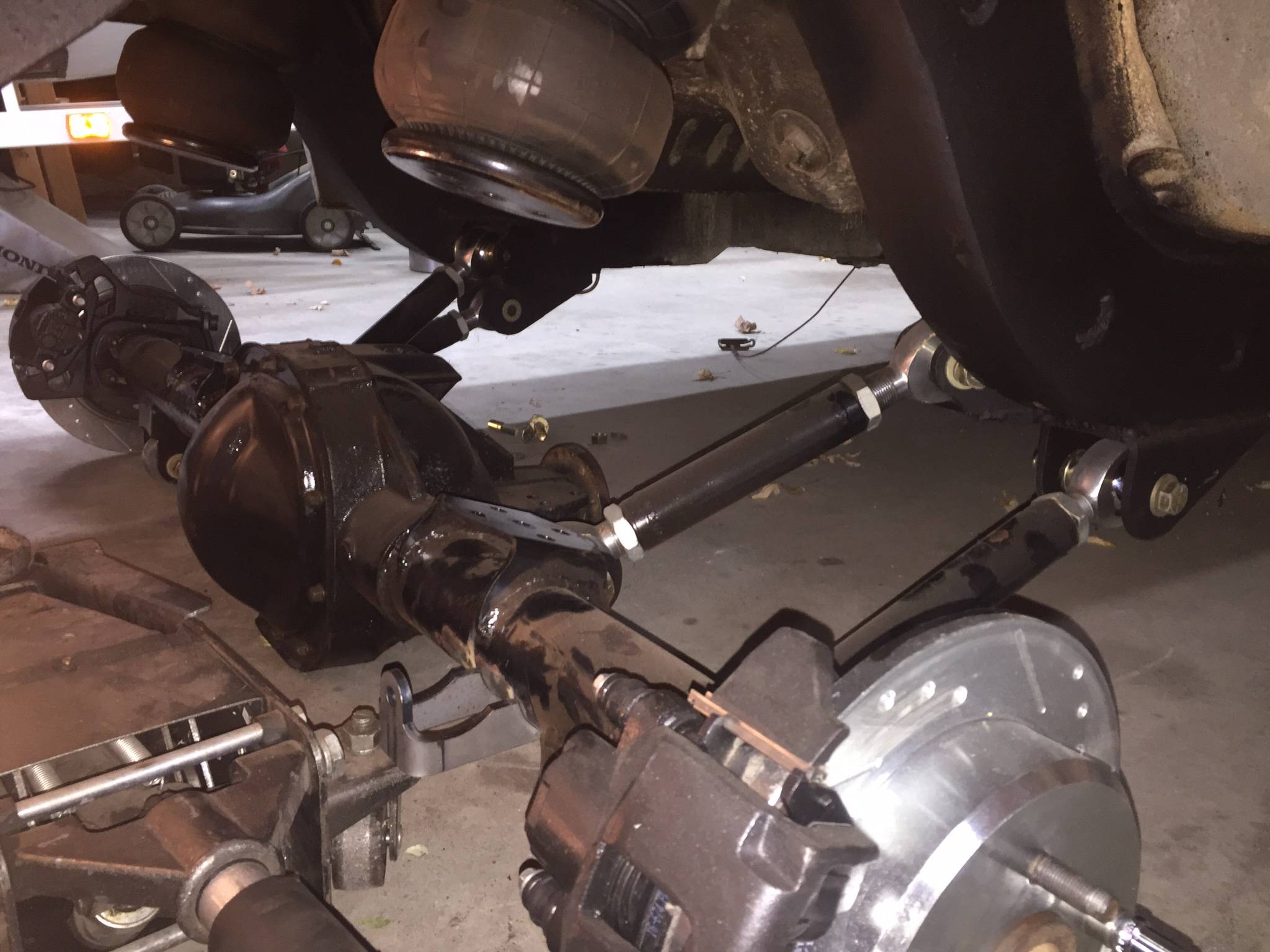

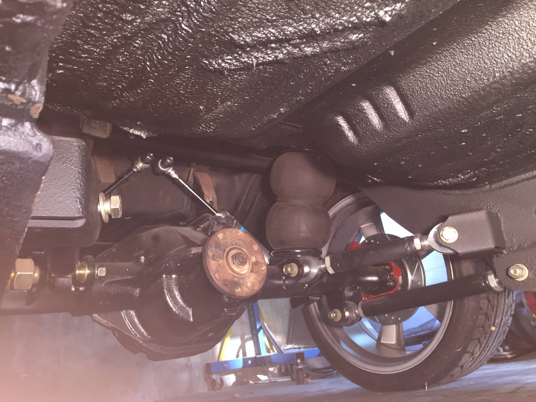

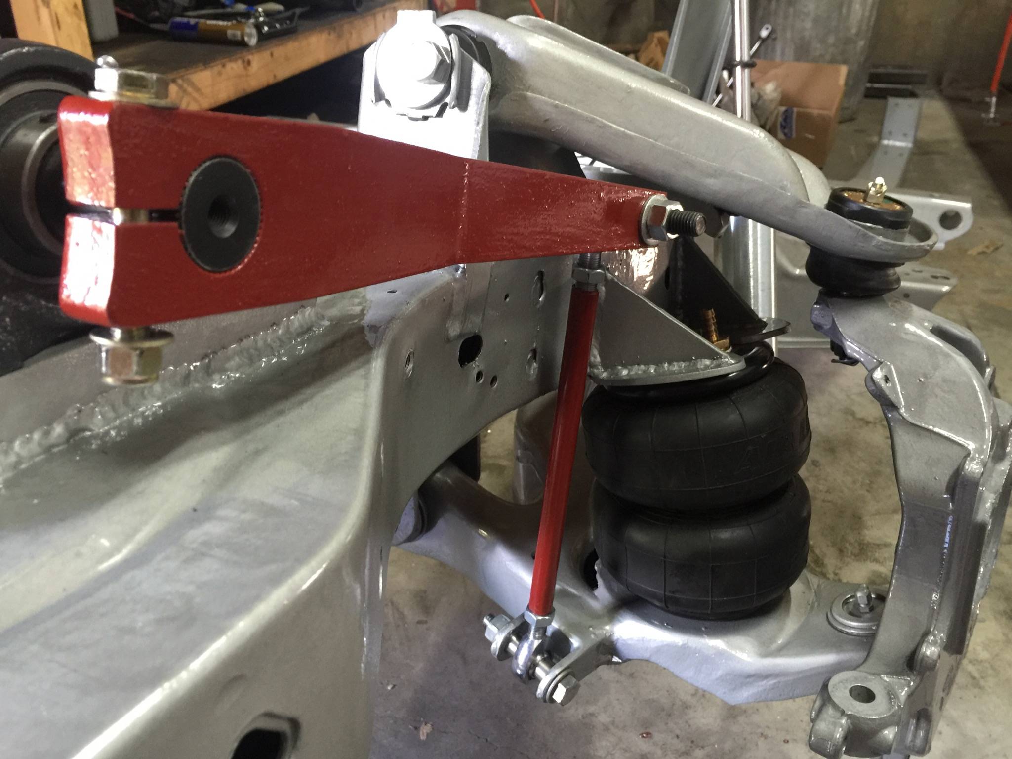

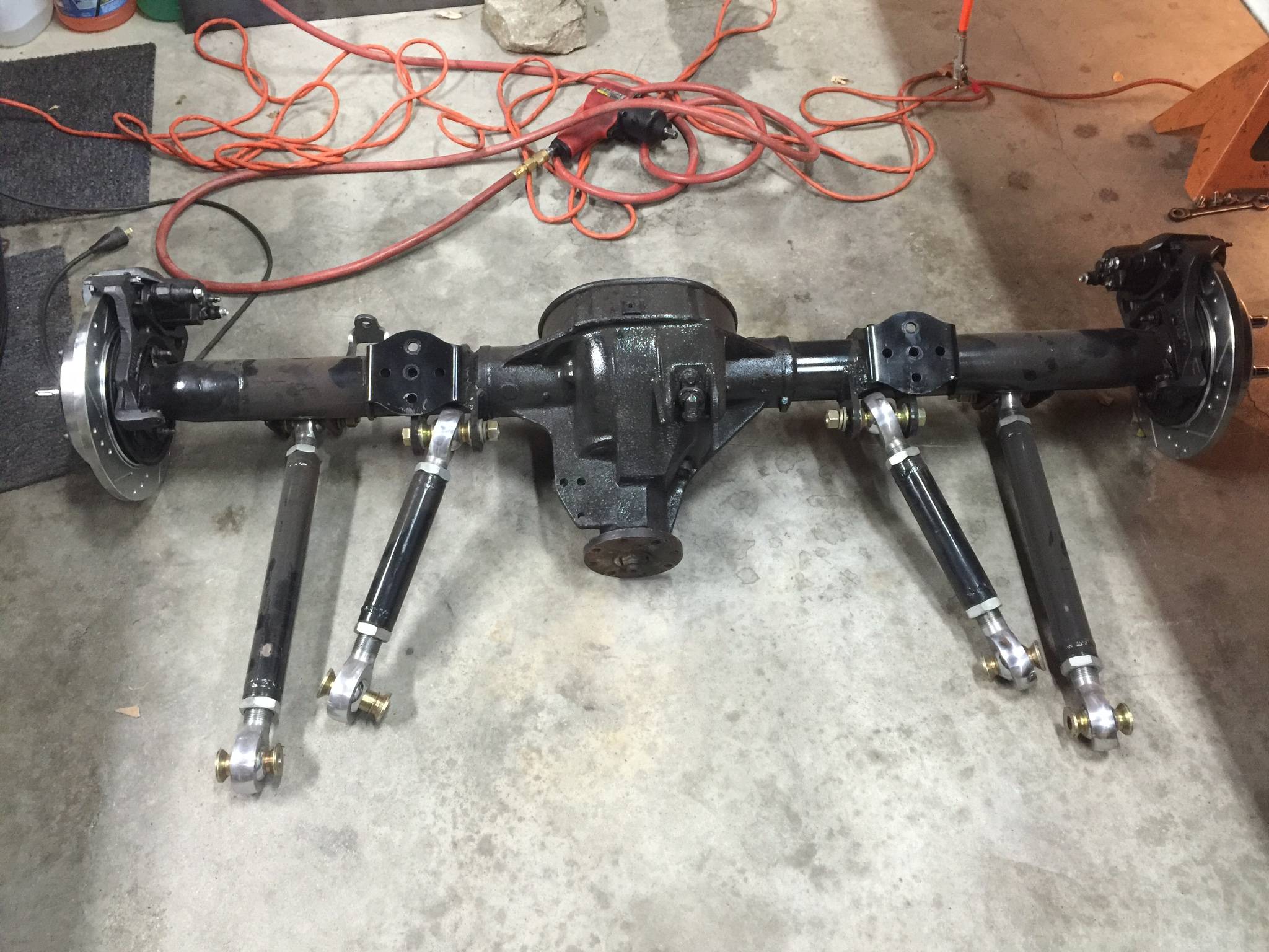

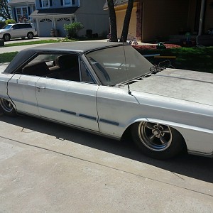

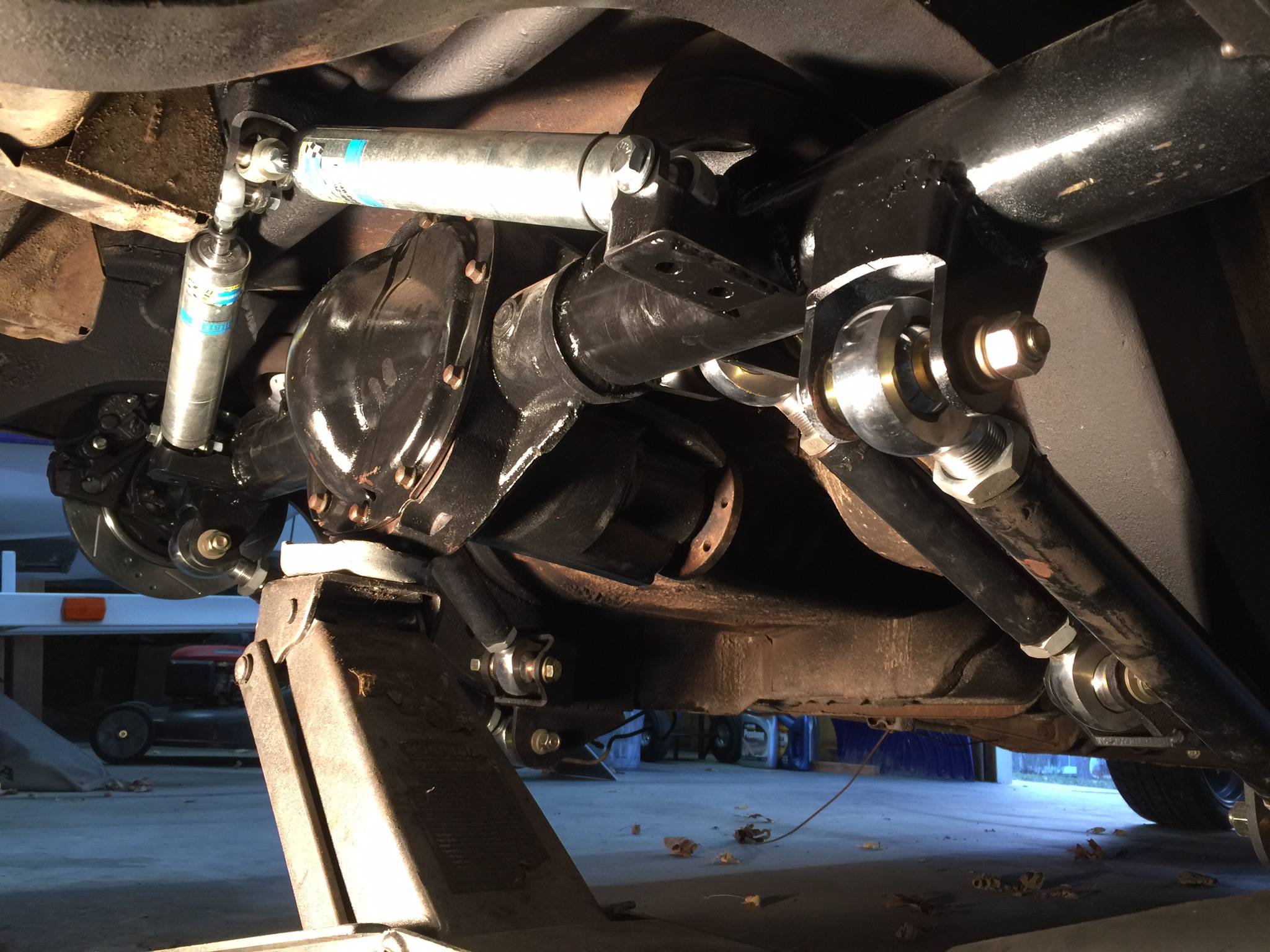

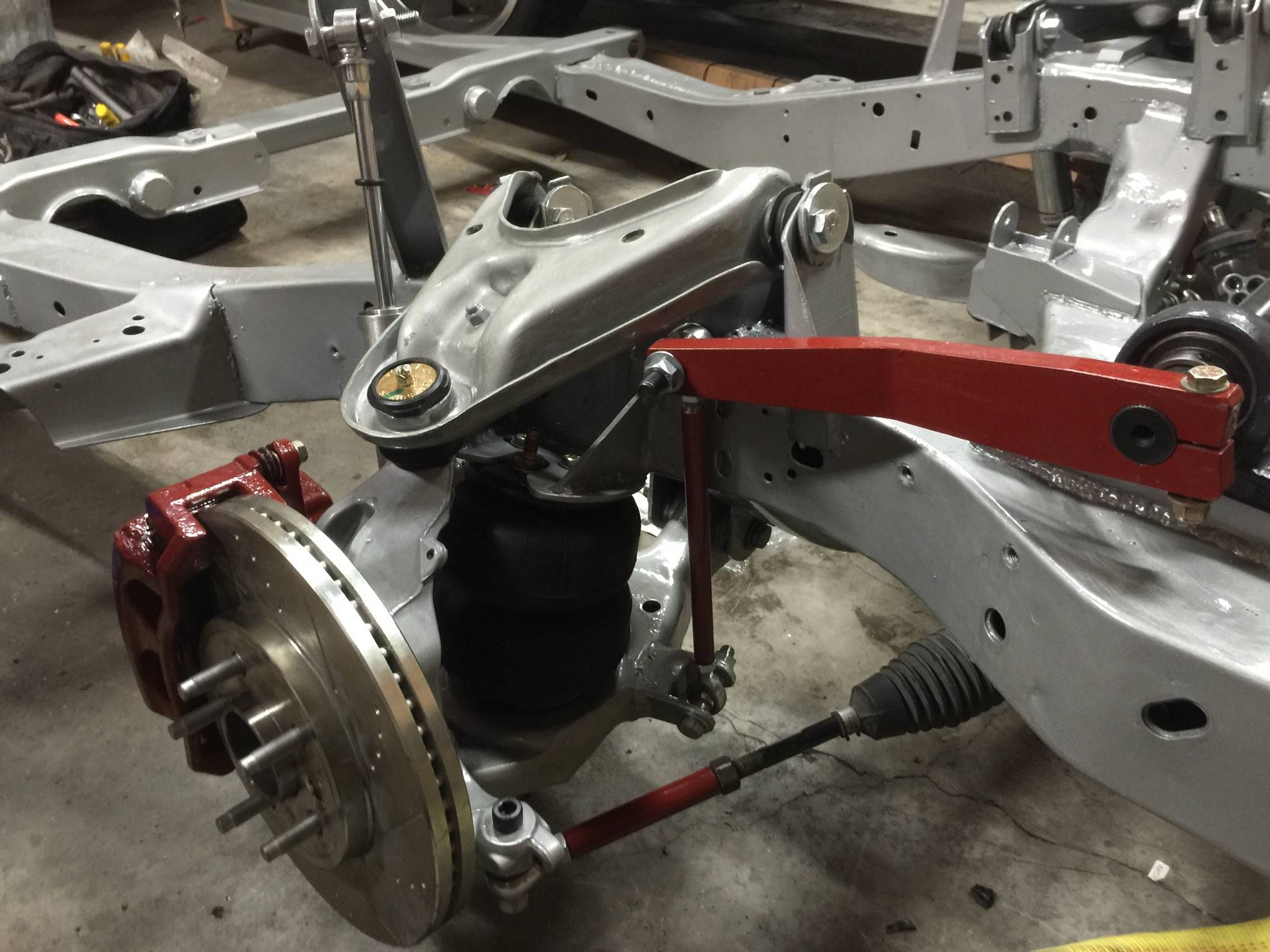

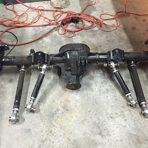

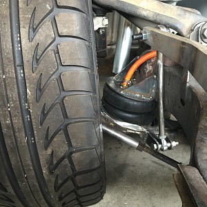

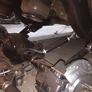

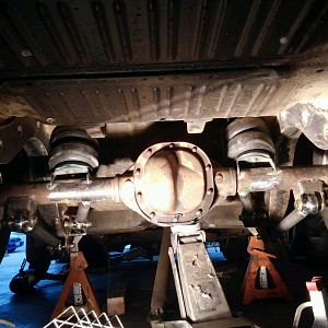

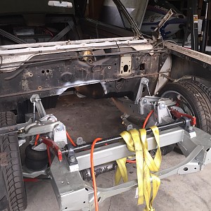

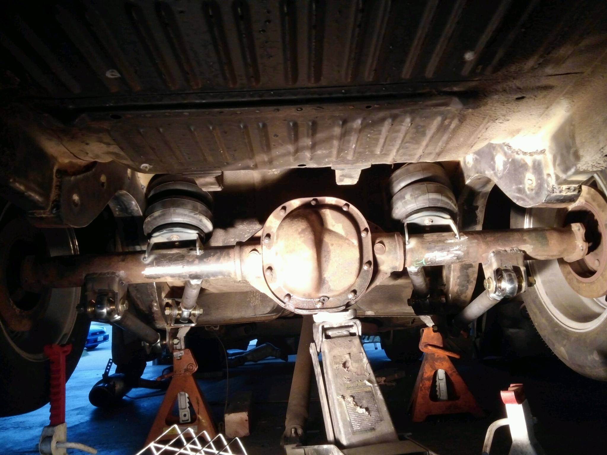

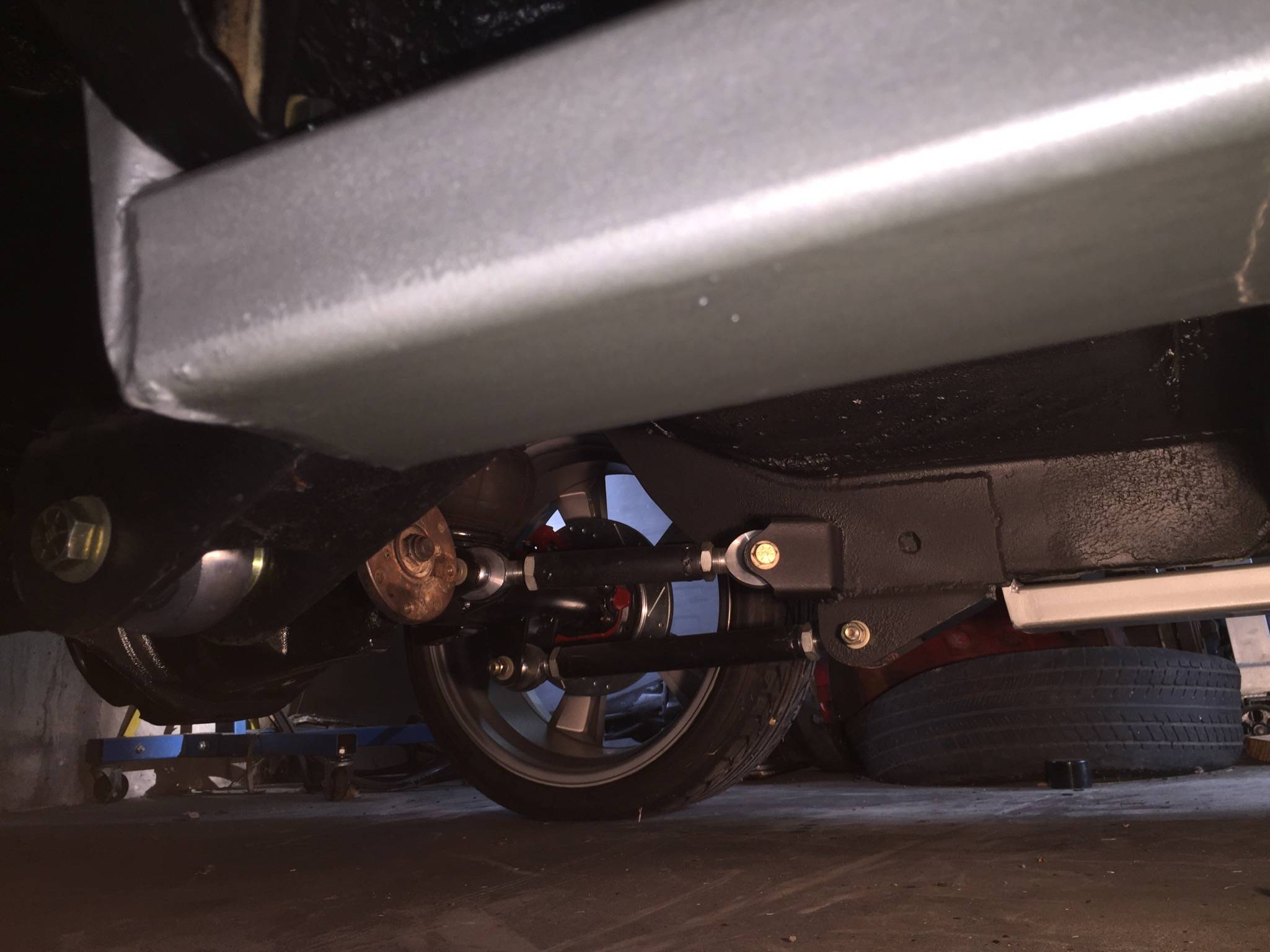

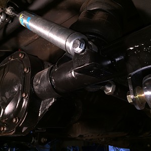

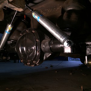

Suspension: Bagged and slammed. Custom triangulated rear 4 link with 1-1/4" RuffStuff heim joints. Front is a conglomeration of crown vic and stock components. All 4 corners stand with Bilstein monotubes.
