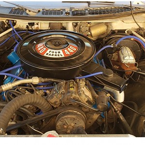

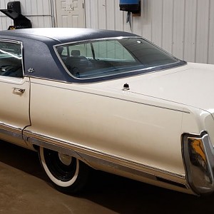

This is CC (CeeCee). I lucked into this car my senior year of college (2018). She has just under 59k thousand miles. She was originally sold in Butte MT, I believe I am the 4th owner but I know that the 3rd owner only had it for about 3 weeks. It has a 440 in it. When I bought it, it was completely stock other than a new fuel pump. I discovered the original paperwork in the jockeybox and if I remember right the slip was still under the back seat. In the trunk the original spare tire and snow chains (gotta love Montana) were in there as well.
Since then I have put in the following:
Tires and Rims
Fuel Tank
Fuel Pump
Radiator
90 Amp Alternator
Heater Core
Servo Unit and Amplifier

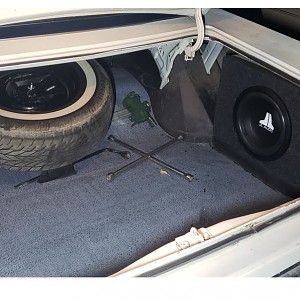

Dual Exhaust-2.5 all the way back into FlowMaster mufflers (original exhaust manifolds)

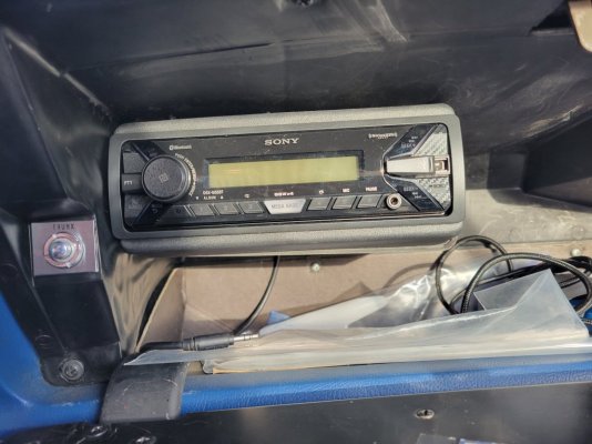

Bluetooth Stereo- (connected to 8track player as well)
All Speakers are JL Audio
2:3.5 inch dash Speakers (left the center speaker connected to original radio-next project in that area)
2:6x9 speakers under back dash (I know that is not correct term lol)
2: 12ich subs
CB with PA speakers mounted under the hood.
2 Amps, I don't remember wattage off hand
Led Headlights w/Halos, as well as new lighting all the way around the outside.

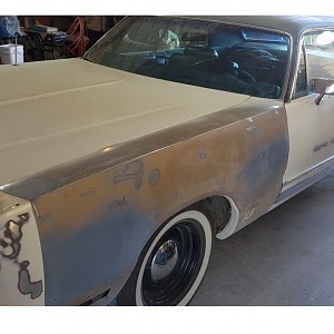

New left quarter panel

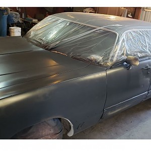

My Dad, Uncle (retired body man) and I stripped down and repainted with original color. (I do not have any new pictures since then sadly.)
Brake job, still has rear drums.
Minor adds:
Door Pulls
Headrests
Trunk sealer and mat
Jack Baseplate
Vacuum Lines
440 sticker for Aircleaner
Painted Air Cleaner and Exhaust Manifolds
Please comment on any suggestions/or ideas for me. I am still learning and want as much advice as possible. Also if anyone could translate the code for me it would be much appreciated.

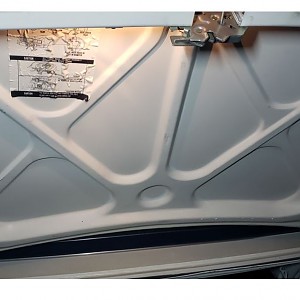

Heres the fendertag decoded. Just ran it through, 1969-1974 Mopar Fender Tag Decoder, so it might be off on a few since the tag codes seem to have a lot of changes year-to-year.
CS43:
Chrysler
Special
4 Door Hardtop
T3C: Unknown
1973
Jefferson Avenue, MI, USA
190854: Sequence number
E85: 440 cid 4 barrel V8 350hp
D34: Light Duty Automatic Transmission
EW1: Eggshell White (Dodge) Exterior Color
H738: Trim - High, Unknown, Unknown Color
HB8: Unknown Int. Door Frames
CO8: Build Date: December O8
125986: Order number
V1B: Full Vinyl Top, Blue
H53: Unknown
R48: Power Antenna
L31: Hood/Fender Mounted Turn Signals
M45: Unknown
P33: Power Vent Windows
P41: Power Door Locks
S61: Tilt/Telescopic Steering Column
G11: Tinted Glass (all)
V78: Accent Stripes, Deleted
R32: Dual Rear Speakers
