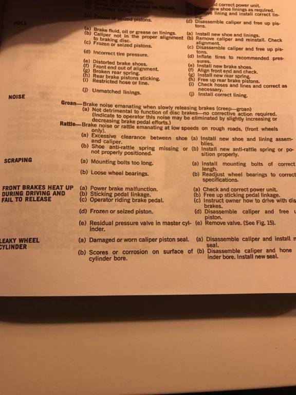

on my ‘67 imperial I found out that de front discs heat up while driving. I can turn the front wheels by hand but I do feel resistance. Rear drums don’t heat up.
I looked in the shop manual and the say the “residual pressure valve” might be the problem and needs to be removed from the mc.
-So what are your idea’s About this?
-what is this valve doing?
-do aftermarket mc have a residual valve?
-how can i check if it really is this valve?
-any other idea’s?
Thanks for your help guys
Ramon
Photo of the shop manual

Thanks for the input guys! It stops straight and both wheels seems to turn the same. I think it’s just how it should be with those budd brakes. I unbolted the mc from the booster just to check if that releases the rotor but it is not making any diffirance. So for now i’m good (I think;-))
