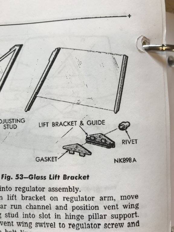

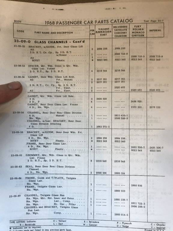

    I am not having much success searching for the gasket that goes between the front side window and lift bracket. I found an E body one on EBay but I believe it is different based on my part manual.
    I believe it is simple enough to make if I can find the right gasket material. The original looks like a thin piece of water resistant black fiber/ cardboard.
    Any suggestions?

    The material that is provided in the rebuild kit for the A and B-Body applications is nothing more than a heavy grade of roofing tar paper material. Even if you have to use the thinner grade of roofing felt, you could cut several pieces and glue them together to achieve the desired thickness.

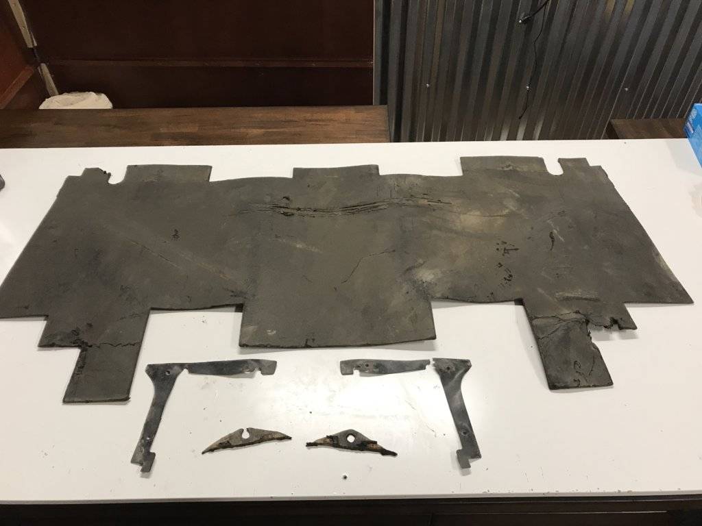

    FWIW, I made a trunk divider out of 1/8" tempered masonite and glued carpet padding to the back of it for sound deadening. I used the original divider as a template for the new one.
    Once cut out, I installed it, climbed in the trunk and traced all the bracing. Then put the padding where the braces weren't.
    If you have an old school glass shop nearby, they may have something suitable for the glass gasket.
