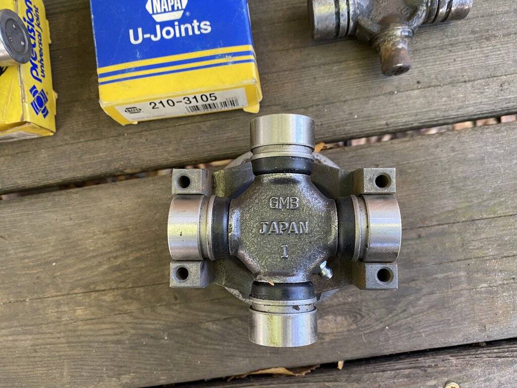

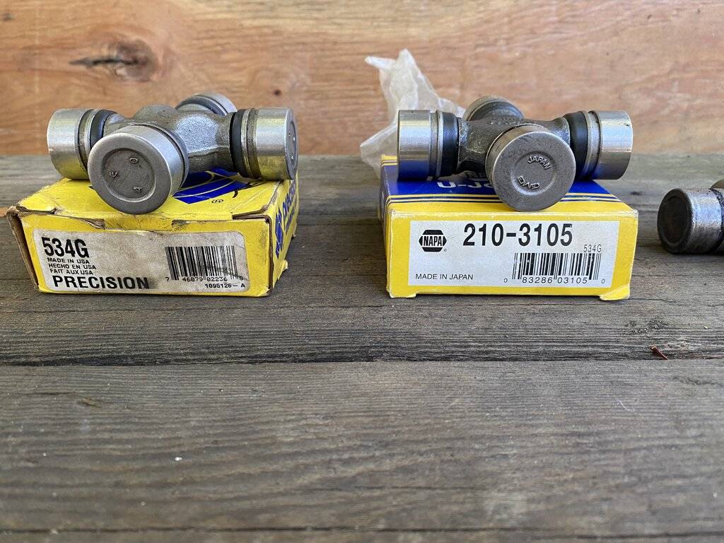

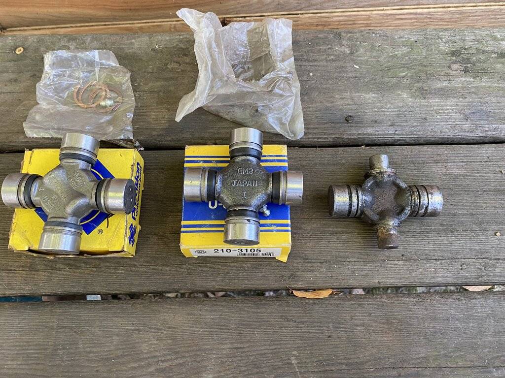

    I’ve been refinishing the driveshaft including replacing the U joints in my ‘70 vert. In a box of parts I have, I came across two NOS u joints, one from NAPA the other from Precision. I have no idea what car these were intended for, but they did com from an old Chrysler mechanic. I measured these against the original that I just removed, and they are identical in every way, except for the part numbers stamped in the cross. I ran part numbers on the boxes and couldn’t find a specific application, although both the NAPA and the Auto Zone websites both say “wont fit your 1970 Chrysler 300”
    My question, is there any reason I can’t use these new parts that measure up in every way?
    Fits perfect in the rear yoke. Yeah, I know, made in Japan:

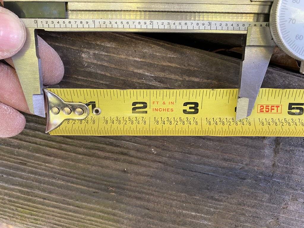

    Cap end to cap end:

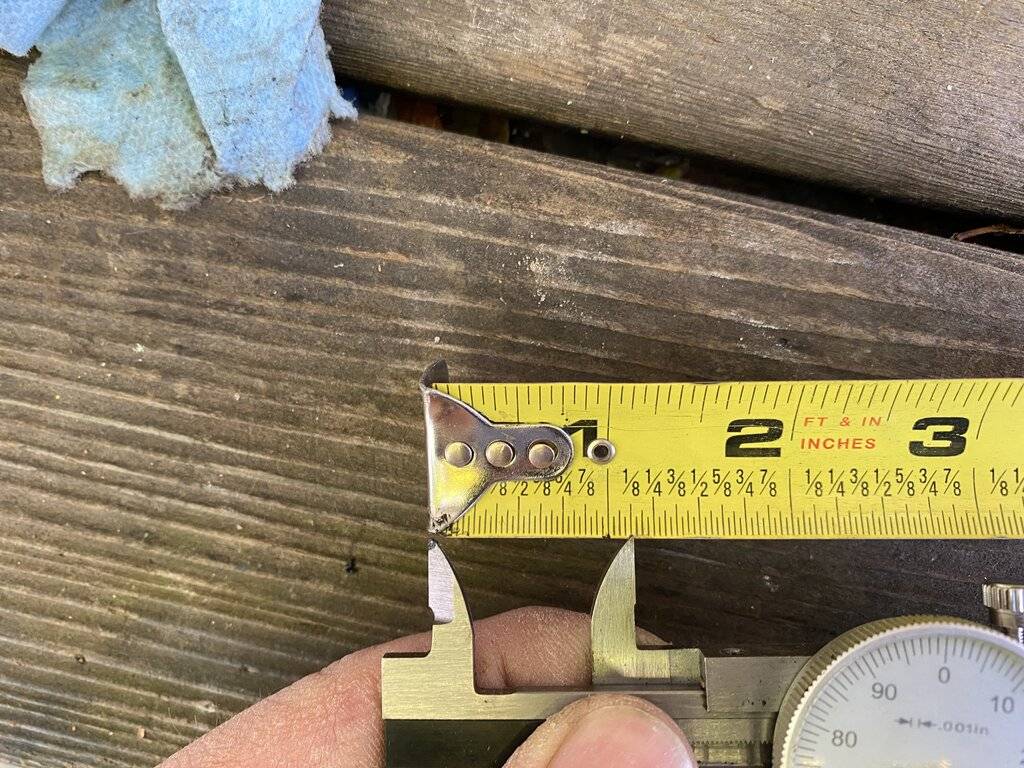

    Lock clip to lock clip:

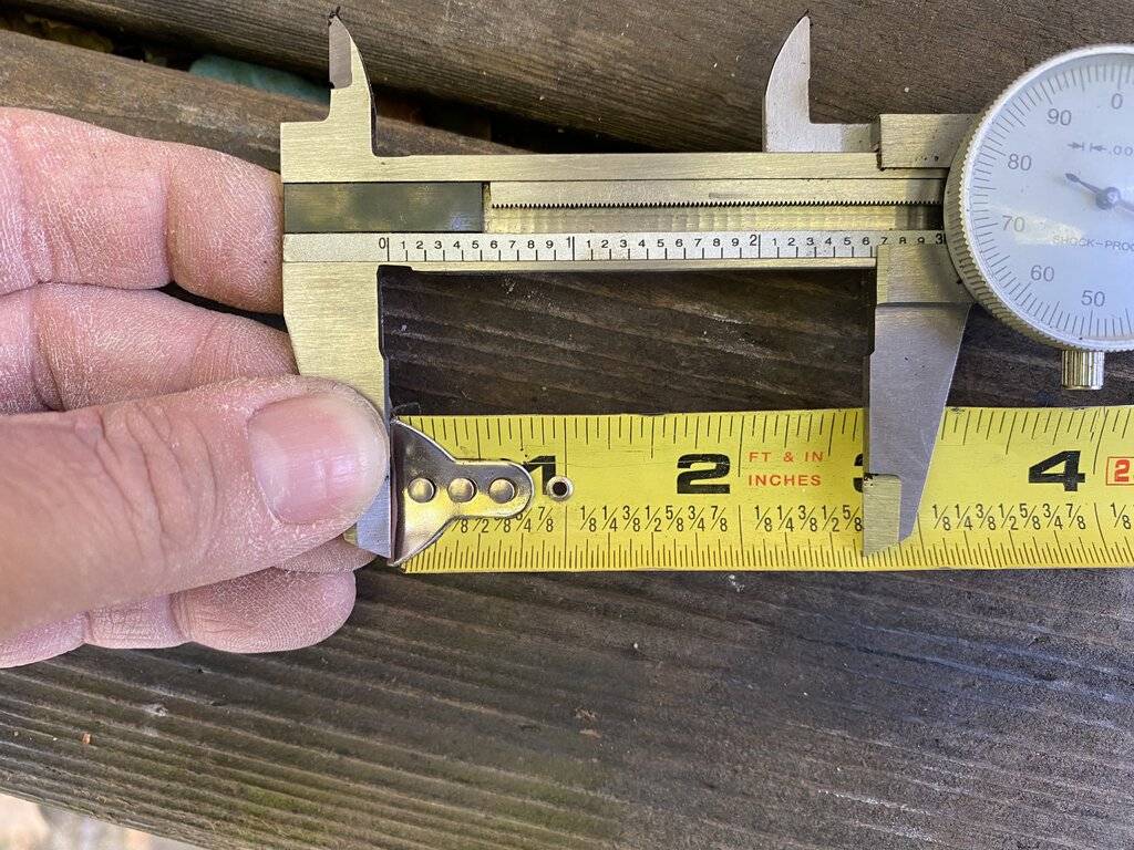

    Cap end diameter:

    If it measures the same, it is the same. The only dim you don't have is the shaft diameter and the only thing that might affect is how much torque the joint can take.
