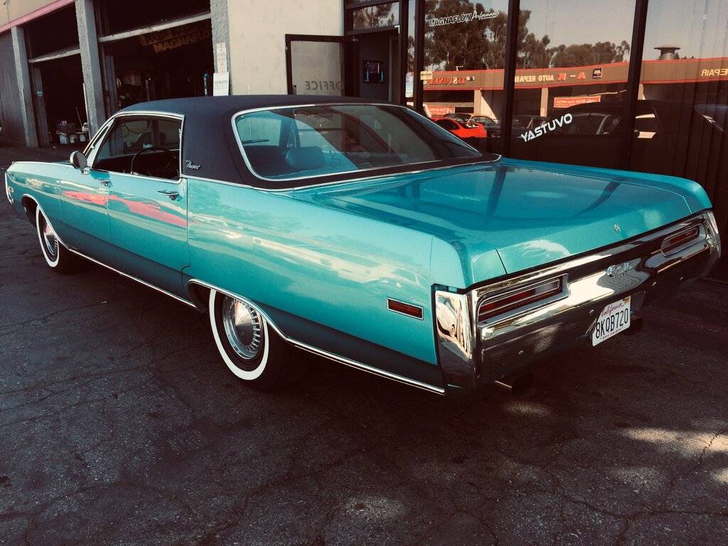

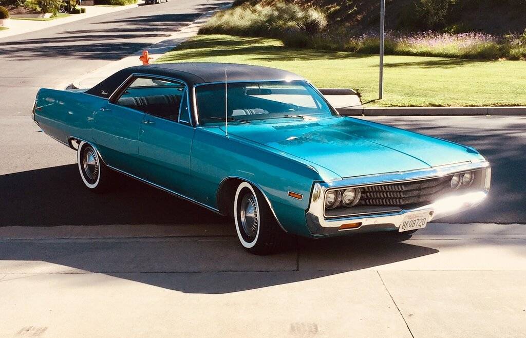

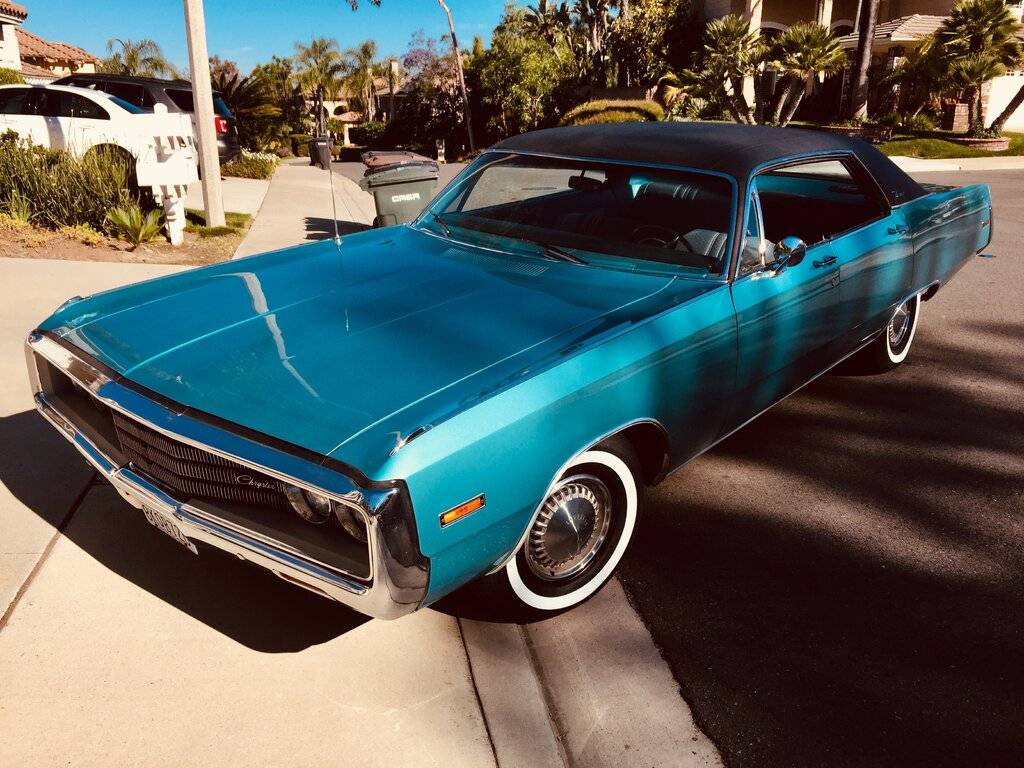

ok, here we go. Time to rebuild the 383 for my 70 newport! Wasn’t planning on this but lately the motor has very low oil pressure and ticking lifters . So time to rebuild. Wish me luck!
Car is a beauty. Great color! You could just fix the oiling problem with the 383.

Great looking car!
