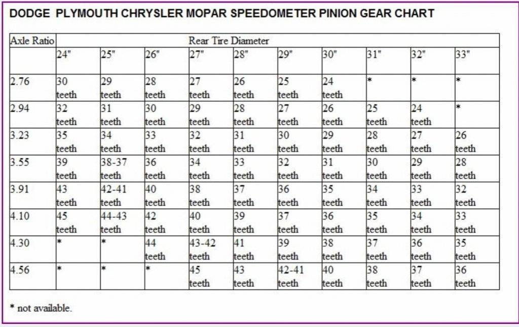

You can buy a reasonably priced commonly available tire in the size of your choice and buy a $35 speedometer gear.

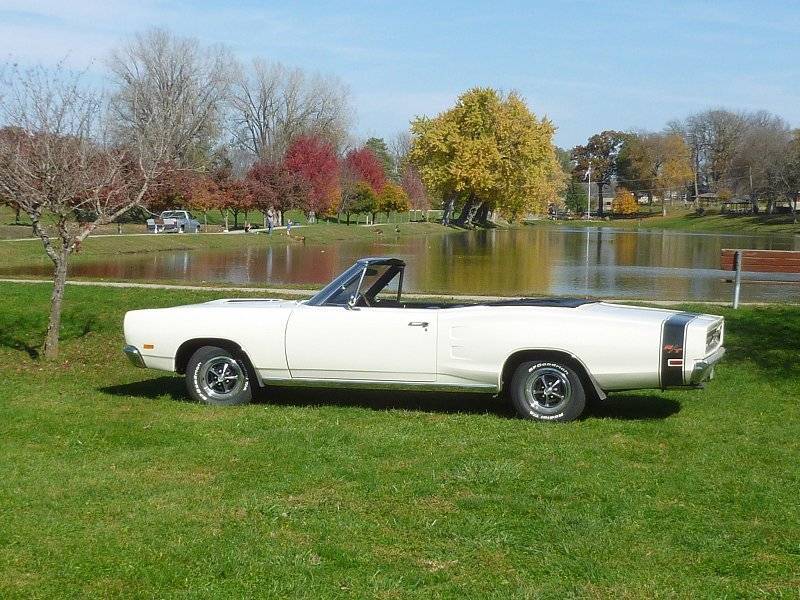

These Coopers are on ebay now, decent price and free shipping. But they are RWL which would be a trade off and really don't blend well on a slab side.
If the car was originally equipped with black walls then that would be the way to go IMHO. The Admiral was originally equipped with black side walls, so I installed a set of Cooper Cobra tires black side out. They capture the original side wall look better then the Hanooks I think.
