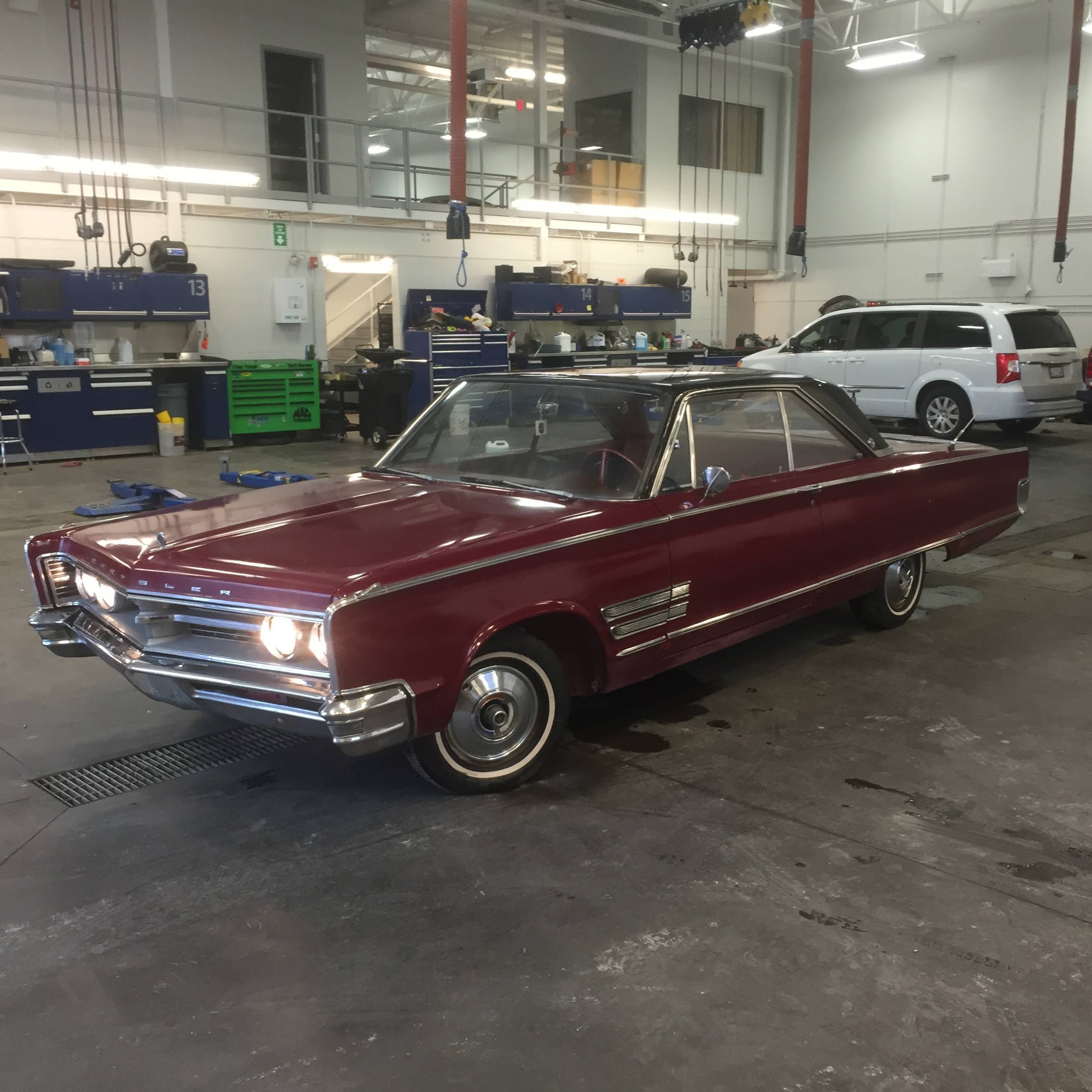

Just wanted to get your guys opinion on what rim size I should use on my 66 300. I'm running steel 15" wheels on it now... But I have 14" steel rims that came with the car. I'm not sure if that's what came factory or not? The hubcaps I have for the car will fit the 14" rims. I also have a set of Chrysler dog dish caps that will fit either 14" or 15". Im gonna be buying new white walls for the car next month. What's your guys' thoughts?

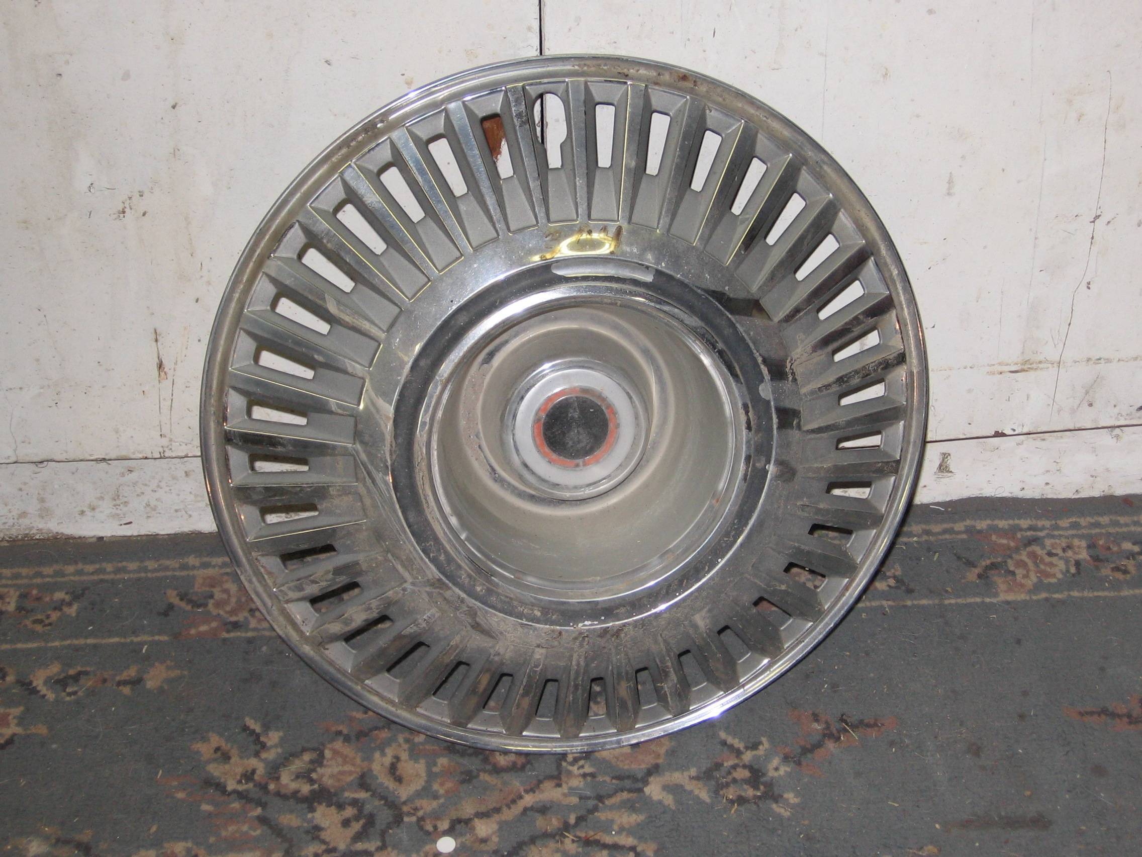

Vintage Take Offs Chrysler 300 Newport Dog Dish Poverty Hubcaps Hub Caps Set 4 | eBay here's what the dog dish ones look like. Only ones I could find on eBay.

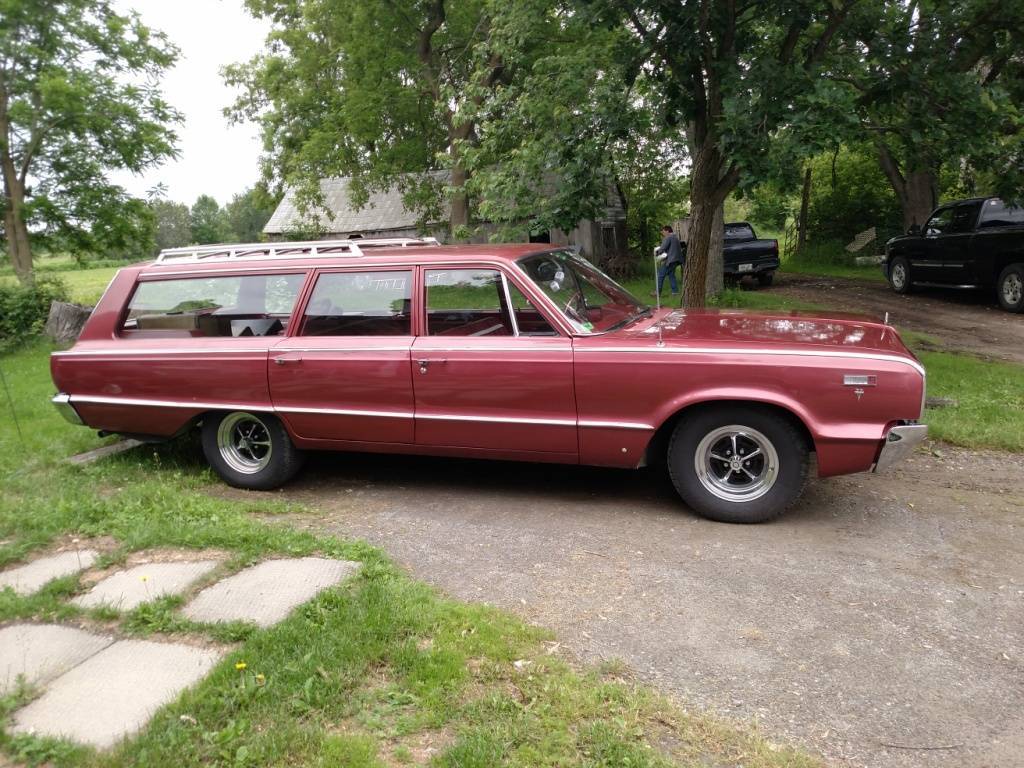

I put 15" on my Fury. To me the 14" are just too small looking on such large cars. I would have put 16" on if I had the clearance for the reverse wheels I got. After that I think they start getting too big. All a matter of preference, though.

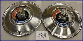

It's too bad they didn't make those cool spinner caps in 15", they are by far the best looking IMO. I know they used a similar cover for the '66-'67 Chargers but never checked to see if they are 14 or 15 inch. Not identical to the 300 style, but very close.

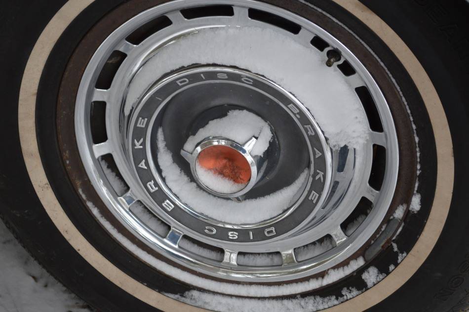

My 300 is a disc brake car with the correct hub caps. Here's a shot of one, albeit a bit snowy. It has a center spinner of sorts, but much smaller. The plastic discs inside tend to come loose over time, too. Contrary to what some of the online whackjobs say, these hubcaps are not rare, weren't used on only one model, one year, whatever. I've seen them on wagons and other models in the 66-67 (maybe 68?) years.
