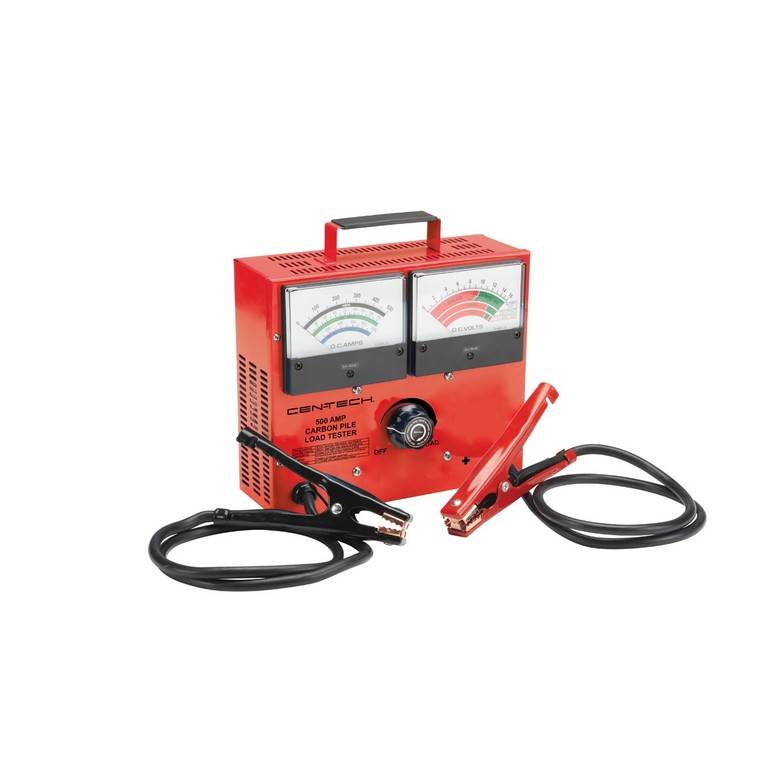

As to carbon pile testers ... HF has cheap ones. The $50 one has an adjustment knob and a claimed 500 amp capacity, they have ones for half as much that rate 100 amps and use an on/off switch. I don't love them, but they are cheap and I have found them to reasonably durable in my environment where all tools get killed ASAP if not somewhat idiot resistant.
If you go there, don't hold the load longer than recommended in your test instructions, for more generic testing we often just use the headlights and blower motor to provide some load.

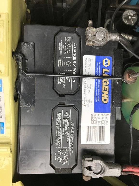

Here's the battery. Can these tops be opened? I have never wanted to deliberately attempt to open them.

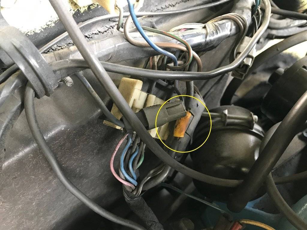

This is the only suspect looking part of the wiring. See the crimp splice? Somebody removed a faulty connector in the past and replaced it with this. This is on the big current carrying wire from the alternator. This shouldn't explain the high voltage reading, though, should it? Anyways, I should check the resistance of this wire from end to end. I plan to solder this splice anyway.
They can be opened. See the little notches? That's where you can put a screwdriver in and carefully pry.
This would have no bearing on too much voltage. Honestly, I don't think this splice is a problem, but it can't hurt to fix it.
What I do see is some possible issues with the battery terminals, especially the negative terminal. See how there's no gap where they clamp? Those terminals are stretched to the point of where they aren't clamping on the post. While that may not be the issue, it's something that you want to correct.

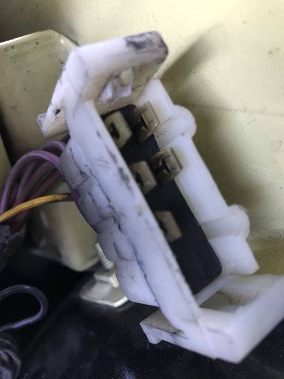

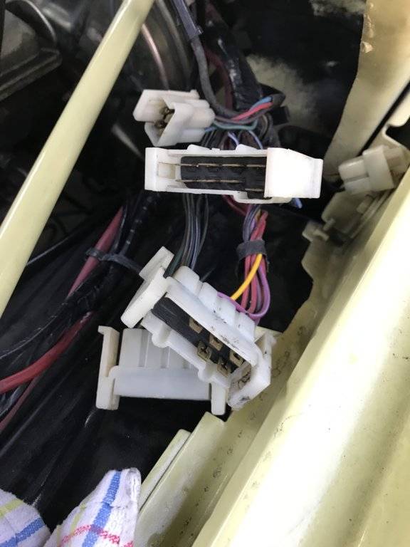

I checked the bulkhead connector and it was pristine. I cleaned it anyway and packed it with dielectric grease.
