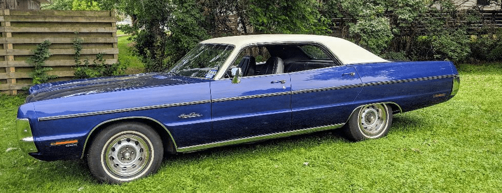

I Installed the 1968 15x6 steel wheels from a 68 Chrysler disc brake car. I then used mopar 15 inch caps.I stuck with 215-75rx15 tires in order to have the best ride, 225-75 worked but the Michelin tire I used is larger, and the car tends to go wherever the tires want to go. other brands tend to be smaller despite being advertised as the same size. some cordobas had 15x6.5 wheels, that work better with a 225/75x15. my 1977 6.5 wheels recommended 225/75x15 or G70 15.

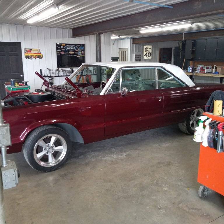

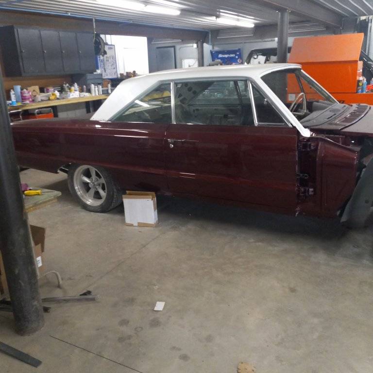

You asked "how wide can I go?" I have 225/50/17 on a 7" rim on the front and 275/50/17 on the back of my 65 Monaco. There are no fitment or rubbing issues. The only thing is that to get the rears off and on the car has to be jacked up by the front spring perch to let the rear end hang. The car is still in the body shop which limits how good the pictures are.

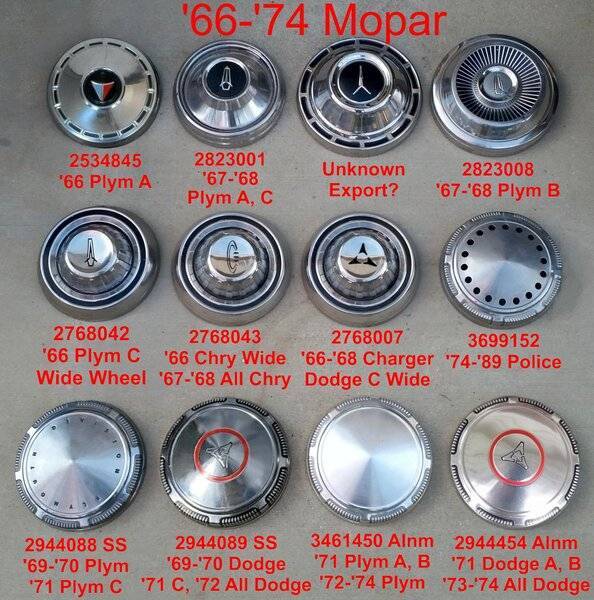

Or you could go the painted wheel/dogdish route. These caps almost NEVER fall off. Be aware that these small caps come in 2 diameters, which match the wheels. IIRC 67 was a transition year from larger caps to smaller ones. The 'unknown export' and 2823008 caps are larger, all the others are the smaller size.
