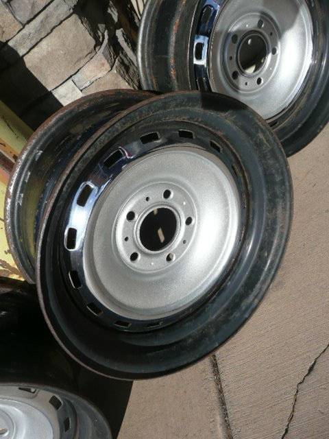

Hey all, I just recently purchased a set of 15x7 Chrysler Road Wheels. I am now in need of proper trim rings, (4), prefer brush finish. So what can I use, what has any one else used, what have you got? New, or good used, daily driver. Not looking to spend concourse money...

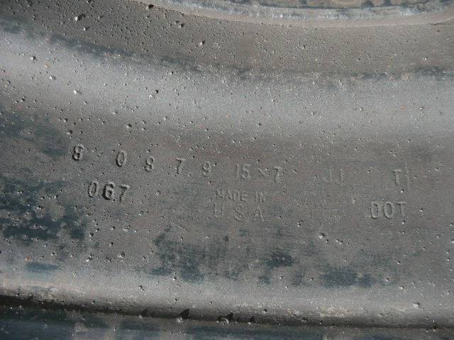

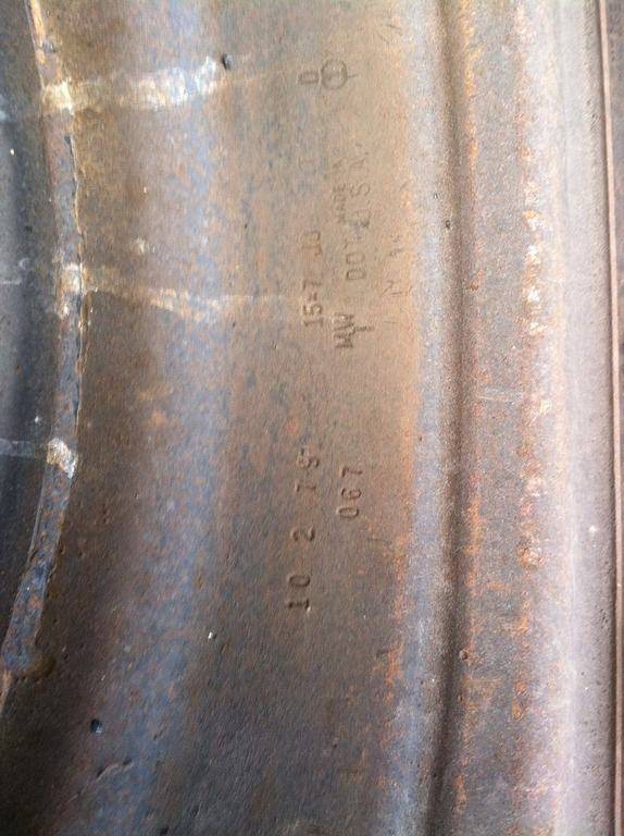

Are you sure they are 7 inches wide?
Correct me if I am wrong,
All the Road wheels I had and seen were 6 inches wide.
Trim rings for 15x7 wheels in general will not fit the road wheels,IIRC
Yes, 7 inches wide. Off of later 70's early 80's M bodies. Same look, only 7".

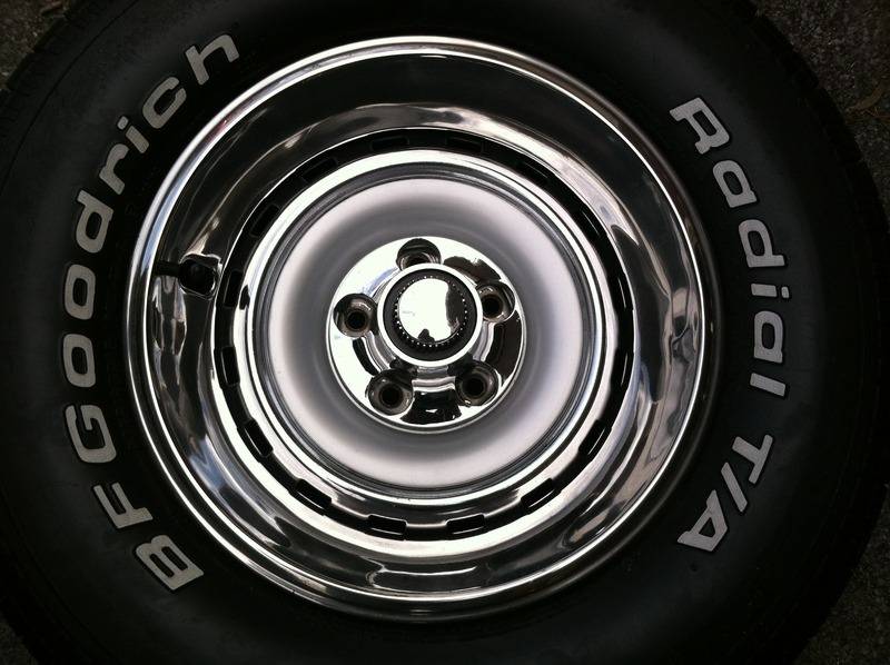

The 7" road wheels came with a kind of ugly looking shiny trim ring that had a completely different contour from the ring used on the 6" wheels. You'll probably have to use trial and error to find what looks and fits best. A general automotive swap meet where you can find a big selection of rings from GM, Ford and Chrysler would be ideal. I have a set of the 7 inchers that I picked up at Carlisle a few years ago, but I haven't gotten around to investigating trim rings yet. They came with rings off a set of 6" wheels.

Someone somewhere told me they used the 6" rings, and painted the under part of the rim Argent, so the black wouldn't stand out....guess that's a possibility...

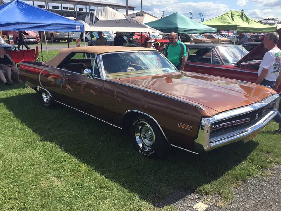

My 15 x 7 wheels have a generic trim ring that the previous owner found at Carlisle. Only a few people, like @polara71 , would notice the difference. These are stainless steel and I would bet that you could make them a "brushed" finish pretty easy with some Scotch Brite, using the jacked up car to spin the wheels.

The look and stance of your car is why I sought out the 7"... beautiful car!!!
