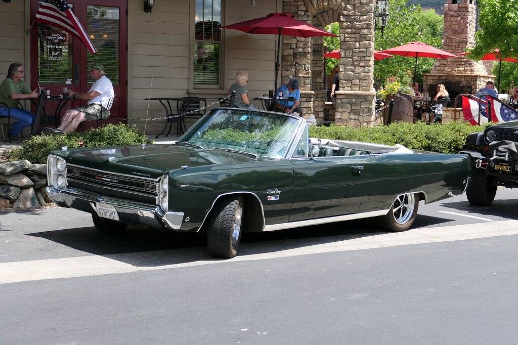

I am no expert because I have never owned a '70 but on my '68 I run American Racing VN501s in 17x7 with 4" backspace. They fit easily and I have no problems with any kind of rubbing or clearance.

That is correct: zero offset. This picture was taken in late May (Memorial Day weekend) and with the front wheels turned out from backing in to the parking spot you can see the tire width. I run the same wheels wheels and tires on all four corners with a fifth in the trunk as a spare.
