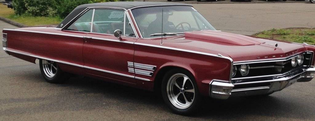

    No but I put 17" on my '66 300.

    Yes. The fronts are 17 x 8 and the rears are 17 x 9. The tires are 55 Nitto's. My mechanic who does a lot of performance car and muscle car work said the trick is not to got to high with the pressure to keep the ride good. I think they are at 35 psi. I plan to have the car out this weekend so feel free to follow-up with me after I put some miles on her as I have not driven the car since last October.

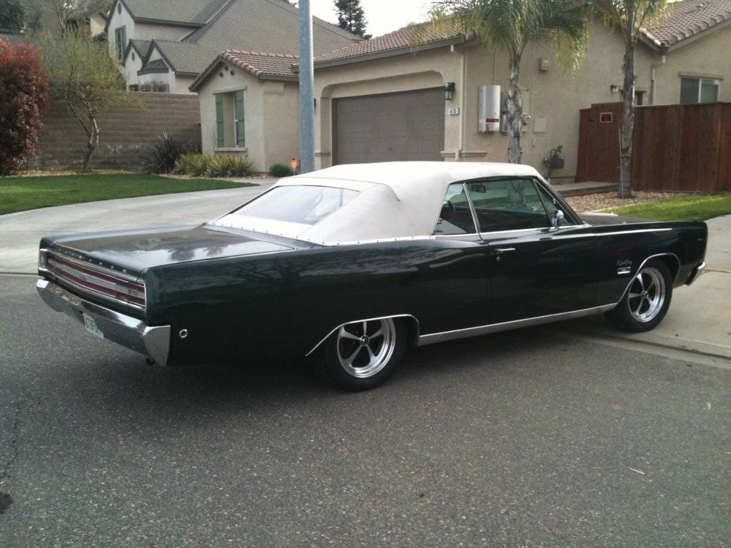

    I went with the same 17" wheels as FURYGT but mine are 7" wide all around. No clearance issues what-so-ever and plenty of room out back for more, but my car is stock and I have need for more rubber. I upgraded my original power drums to a set of power discs off of a 73 Chrysler so I had to upgrade from my original 14" Magnum 500s as well. Some friends recommended 17" wheels due to the availability of great modern rubber at very reasonable prices in the larger wheel sizes, unlike 14" and 15" rubber. And 16" rubber may soon be harder to find, too. These wheels (American Racing VN501) with modern rubber are virtually the same diameter as the original 14" Magnums due to the lower sidewall and here is what they look like on my car.
