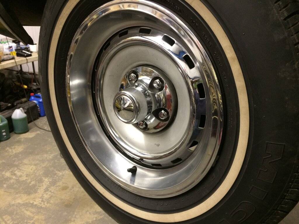

Does anyone know where to buy the lug nuts for the 16 slot road wheels?
Thanks for any info!
When I bought my '70 Monaco Brougham in 1975, with the "then-unusual" W23 16-Slot Road Wheels, the lug nuts that were on the car were more like the one on the far left of your picture. With a medium "tower" on them. Should be the same ones that can on the later '75 Cordobas and C-bodies, I suspect. Other than the later cars would have only rh thread lug nuts.
Enjoy!

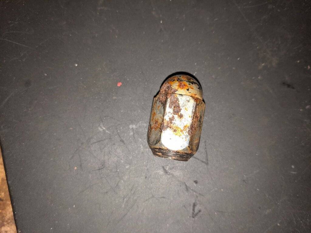

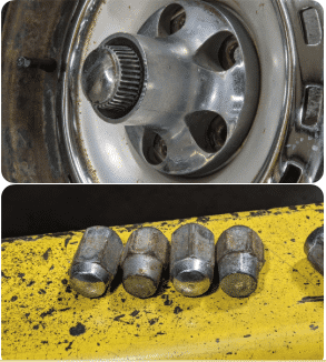

Some years back, I was planning a road wheel lug nut thread, but it never came to be, so tonight I'll get a chance to use the photos that I took.
Number 1 is an original 1978 road wheel lug nut. It's the kind with a stainless cap.

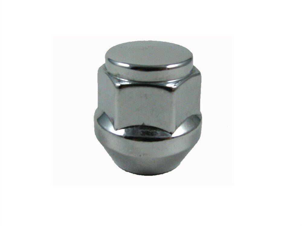

Number 2 is what Dorman used to sell as a replacement for the road wheels. It's similar in style to the nuts used on the front wheel drive cars in the 80's, but taller. It's also stainless capped. It's been superceeded by a chrome plated solid nut, though many sellers have not updated their photos and still show a capped nut.

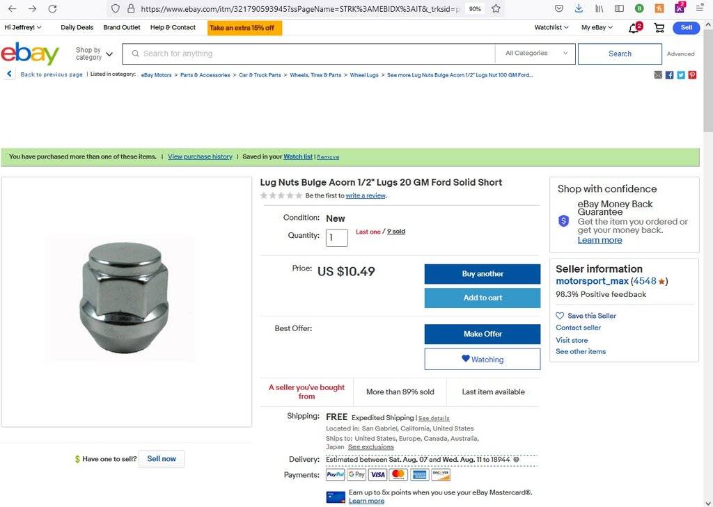

Number 3 is the ebay nut in my previous post. It's a chrome plated solid nut.
Number 4 is a McGard, chrome plated solid nut.
All four nuts have a 3/4" hex.
Side view:
To my eyes, the McGards stick out too far.

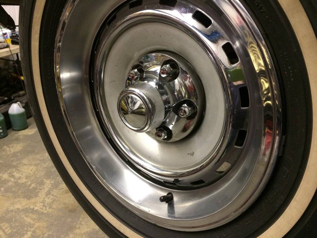

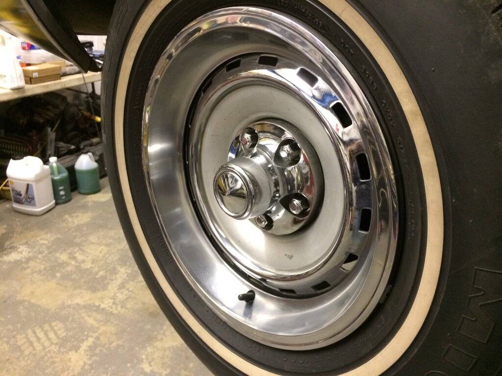

Here's what they look like on the car. I don't have a photo of the original style nuts. It was a chore just to get access to the one that I used for the photos.
Dorman 611091:
ebay:
McGard:

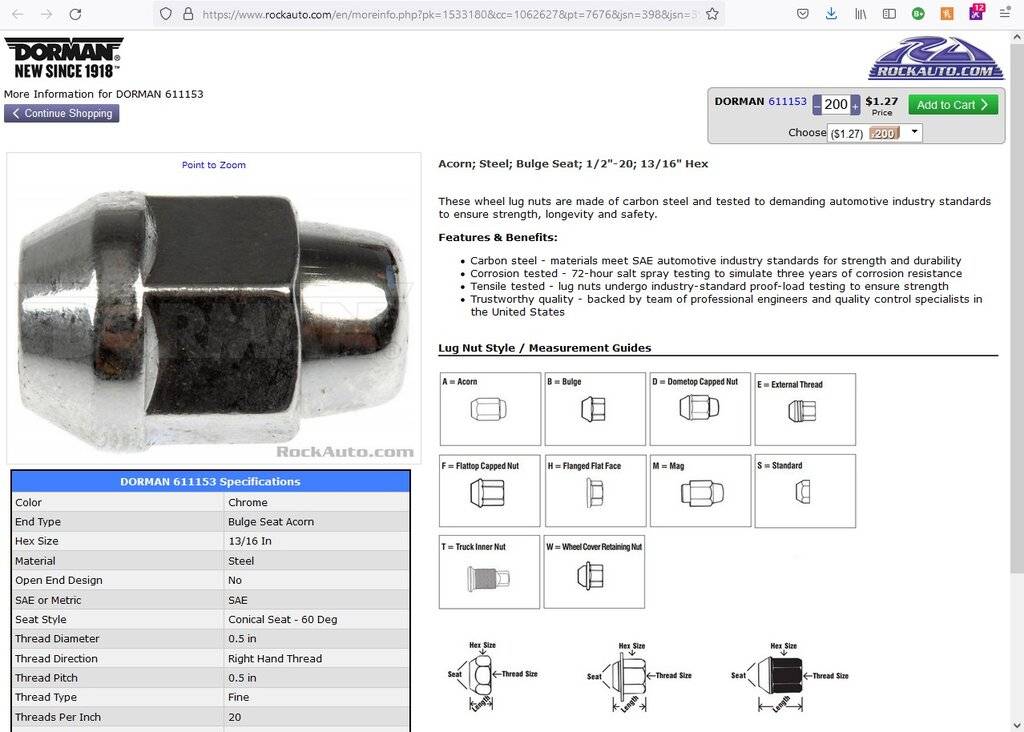

Dorman sells a nut that's similar in design to the original 1978 nut, but it is a 13/16" hex with a wide base, so it's probably not going to seat in the wheel all that well.
