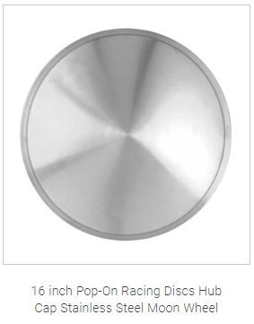

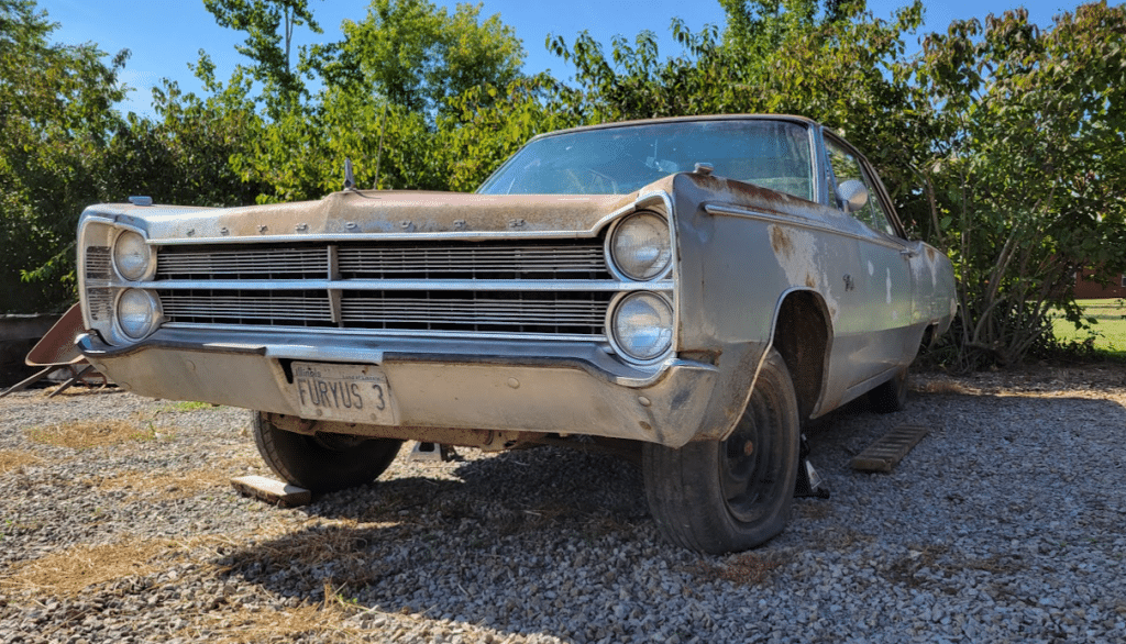

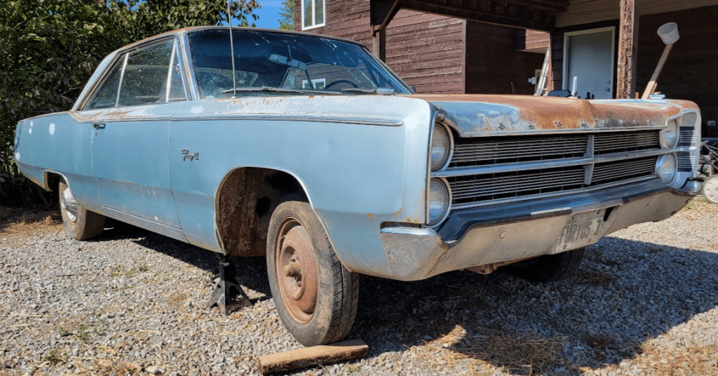

I've recently re-aquired my first car, after 23 years, (pic below) and working to get it back on the road. Although it's rolling (sort of) on a mix of space savers and junk in the pic, I do have the original 14" steel wheels that I could put good tires on. But, I want to upgrade to 16" steelies if possible? Want to go 16" for more/better tire options and I like the look of a slightly larger wheel in those wheel wells. Need steel as I want to go with full moon racing disks (snap on style, not the kind with screws) like I had on it in in the '90's. I love the look and it wouldn't feel right any other way...
I'v looked in the obvious places and tried to find a good cross reference for other cars with same lug patern, offset, etc. and I'm not having much luck. I did search this site as well, but new here so not exactly sure best methods...
SO, anyone know where I can find pre-owned 16" steel wheels from another vehicle that will fit my Fury? Budgetarilly constrained at the moment so not ready to spring for anything $$$ and new.

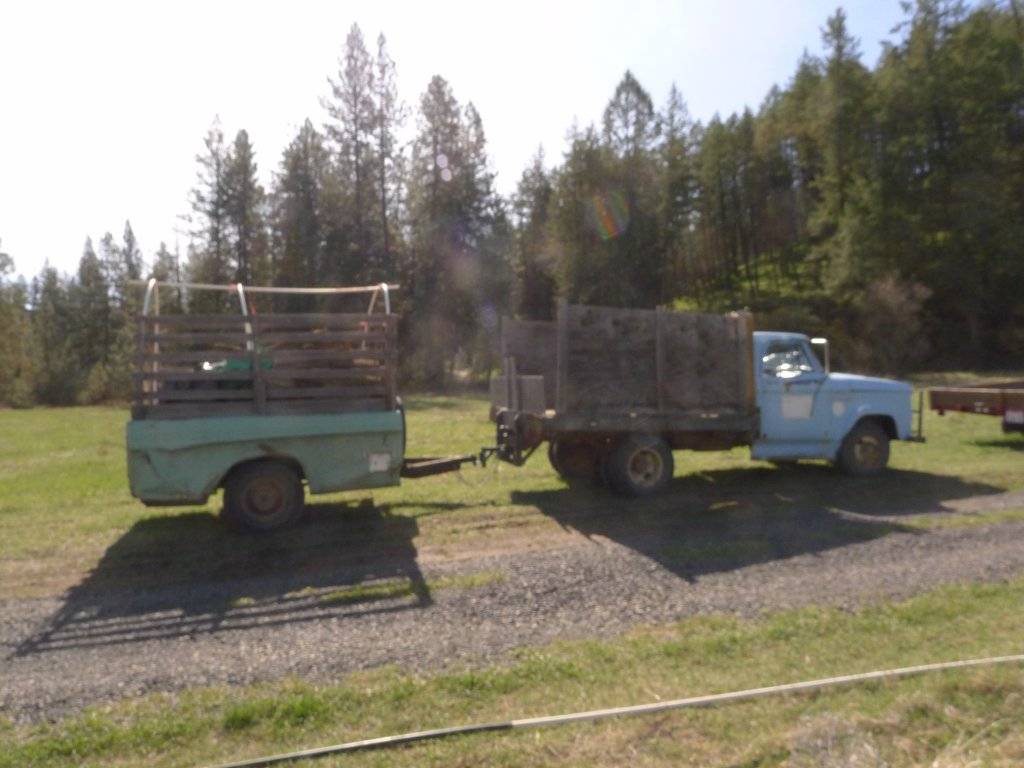

I've got your wheels right here, but you can't have them ;]

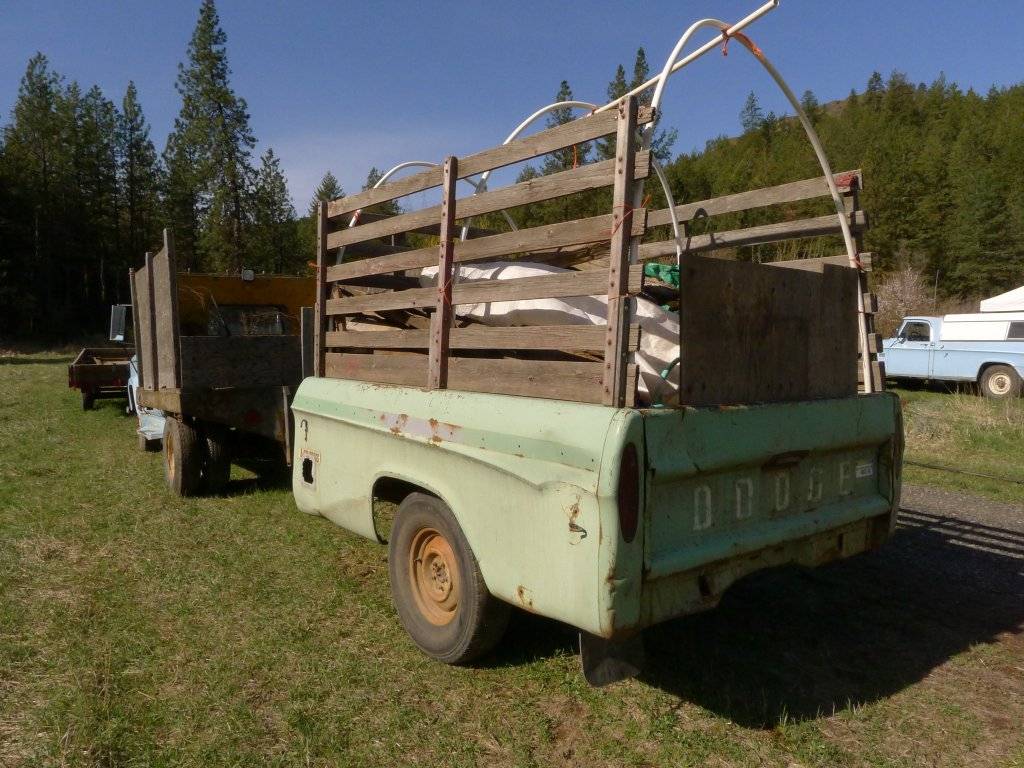

Factory Mopar rims, 16" D100 wheels, a Forest Service option as seen here original on this D100 trailer with factory overloads, sits as high as a 3/4 ton, for ground clearance. These are 16" 5 on a 4.5" 2WD truck wheels, not W100 wheels which have a much larger bolt circle.
I managed to score a set of four of these for a '69 D100 I drove years ago, I worked in the woods and wanted the extra clearance, and I like tall skinny tires.
Tire size is standard everyday 10 ply Load Range E 235/85/16, these are old Bridgestones so they should outlast humanity...
I heart my truck ;]
