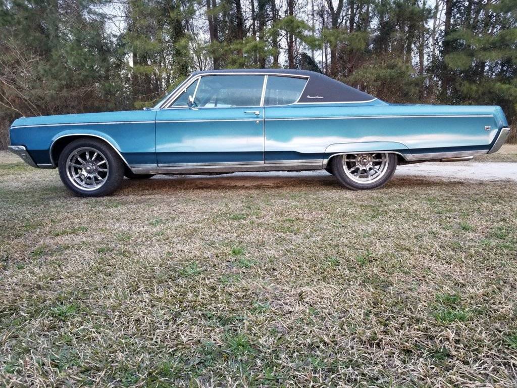

  6. FURYGT
    FURYGT Senior Member
    Messages:
    2,438
    Likes Received:
    1079
    Joined:
    Mar 11, 2017
    Location:
    Lincolnton, NC
    275/50ZR17 Nitto NT555 G2 on the rear and 255/50ZR17 R17 Nitto NT 555 G2 on the front. 17 x 8 wheels up front and 17 x 9 wheels out back.

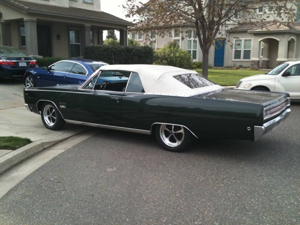

  12. MoparJim
    MoparJim Member
    Messages:
    162
    Likes Received:
    171
    Joined:
    Mar 18, 2017
    Location:
    Oakdale, California
    I have 235/55-17s on 17x7 wheels on my 68 Sport Fury. This combo is virtually the same height as the original 14" tires and wheels, so not fitment problems whatsoever. They help the car handle and track very nicely. The only downside is that the ride is just a little bit harsher with the lower profile and higher air pressure, but it is not a big deal and I love the way these look and drive. 68 Sport Fury 2.JPG

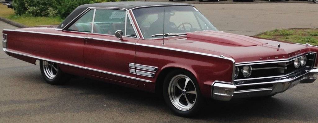

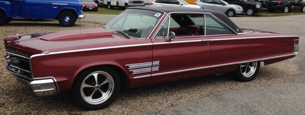

  17. FURYGT
    Messages:
    2,438
    Likes Received:
    1079
    Joined:
    Mar 11, 2017
    Location:
    Lincolnton, NC
    & VN501, which are what is on my '66 300. I think one of the reasons that they are popular is that for a modern wheel, they have a classic look that evokes the Magnum 500 and people have also told me that they remind them of the Keystone Classic wheels. I think another reason that these are popular is that they are reasonably priced. I got mine from Ron's Rims directly but they also sell on eBay. $160.00 each shipped for 17 x 8's.
