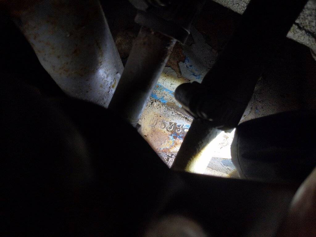

    Like already stated, a replacement engine could be anything. Recommend you take pictures of the engine and send them to this list. Maybe then we can tell you what it is - or is not.

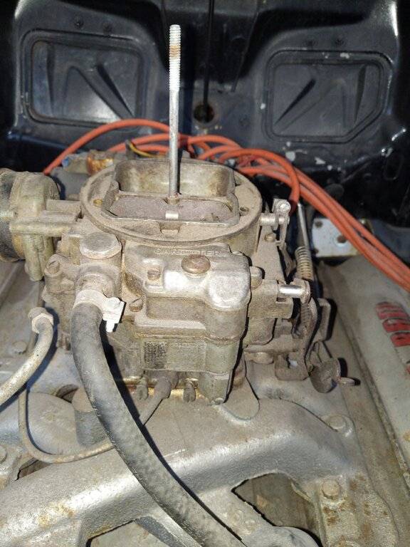

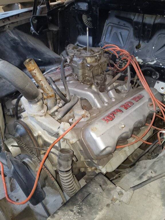

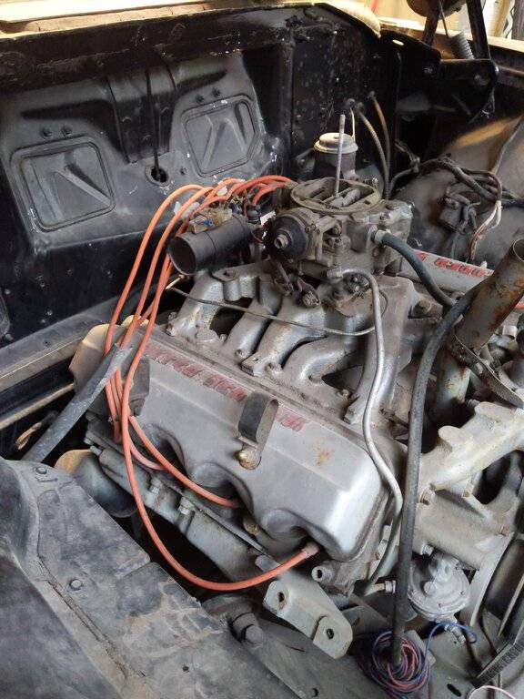

    Ok here are some pictures.

    Appears to be a 315 4 bbl.
    D633-86736

    Looks like they replaced the engine with the same type it had to start with, or maybe they just rebuilt/repaired the old one. Block has some blue paint on it so it could be a rebuilt.

    What color were the blocks back then?
    You can't tell very well by the picture, but it's a light baby blue?

    Mopar did not use that color in the 1950's. Most of the early poly engines were Mopar P4529148, aluminum silver which was the default color thru most of the 1950's for most engines.. The poly engines switched to red about 1962.

    Agree. Most likely that is another 315 engine. Original factory color was silver, but if rebuilt or replaced with another engine which another owner had, original silver could have been painted over.

    A lot of commercial rebuilds were painted a non-factory color to make ID easier in the event of a warranty claim. You know "We only paint our engines red, yours is green".
