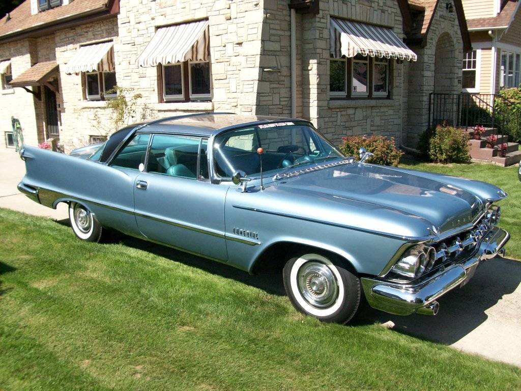

My '59 Imp has the turn signal cancel switch attached to the steering column above the brake pedal. Are we on the same page describing the part? I'm not sure of the outcome if you eliminate it. Perhaps you would have to manually cancel the turn signal by hitting the button on the switch (right or left).

Your Imperial is beautiful.
