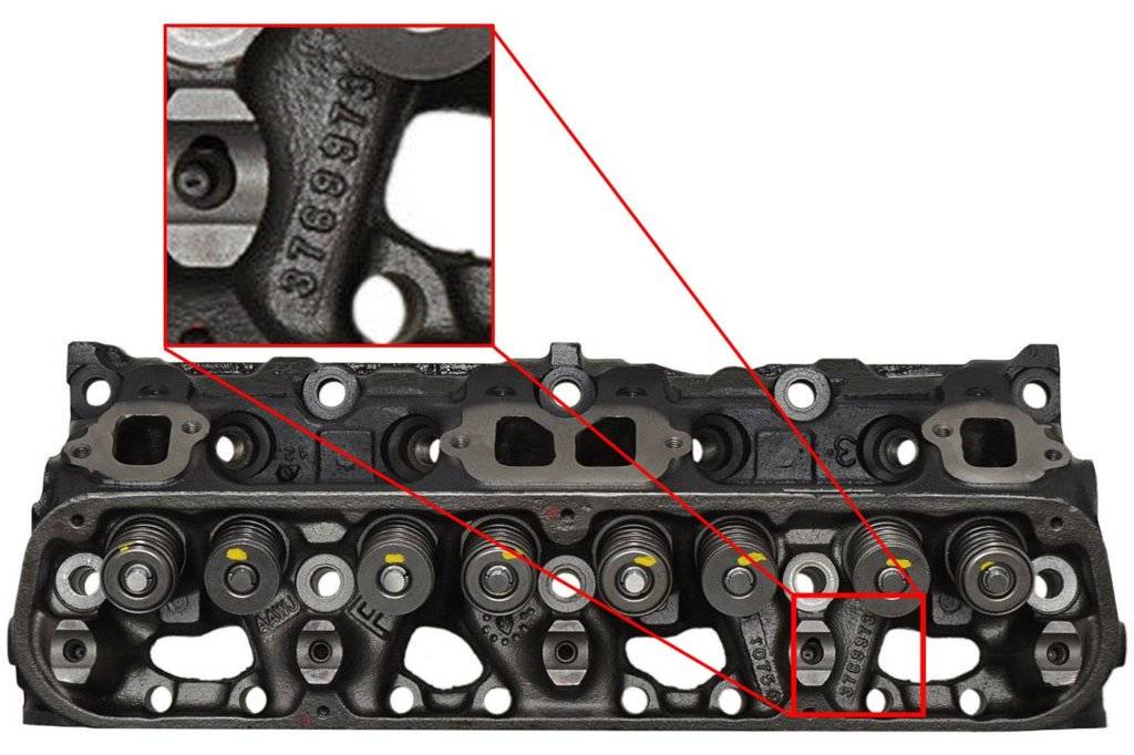

1960 318 Poly Head Casting Number?
Where's the casting number located on the heads?
Most mopar heads have the casting number in one of two locations, first on the top of the intake runner under the valve cover, it will be a 7 digit number. The second location is on the intake runner on the bottom of the head where it bolts to the block. www.enginelabs.com has a good article on mopar heads.
