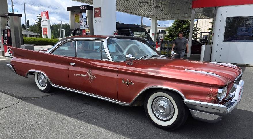

1960 Chrysler New Yorker Dual Brake Master Cylinder Conversion
