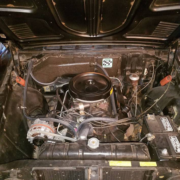

Still got the Dart! Went through the entire cooling/heating system. Flushed the engine three times and I am still getting rusty water out of it. Found an "HP" air cleaner on a 1958 Plymouth 350ci. Redid the interior with NOS seat covers sourced out of Australia. New Coker bias plys. oh, and a correctly date coded Carter AFB and wide finned alternator.

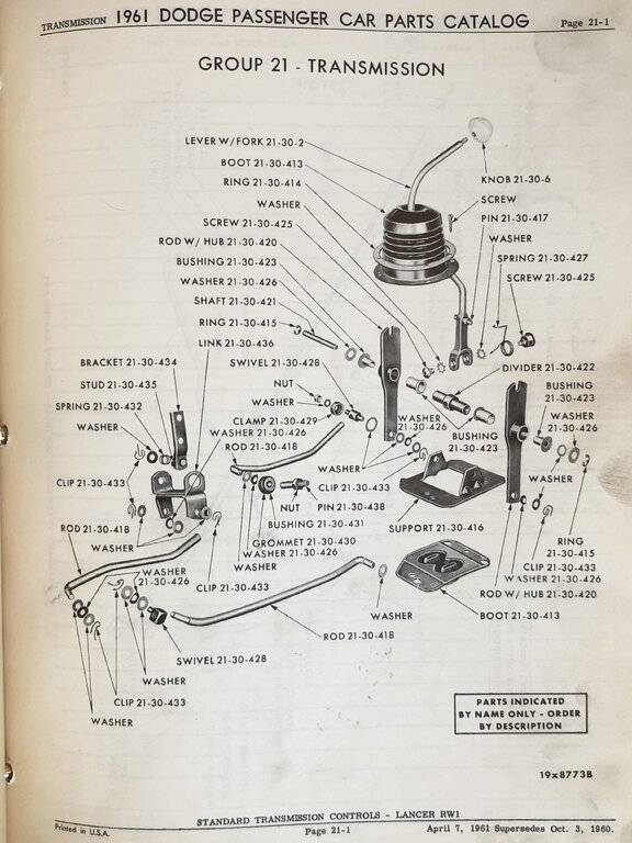

Also in 1961 both the lancer & valiant were availble with manual floorshifter (from the factory).

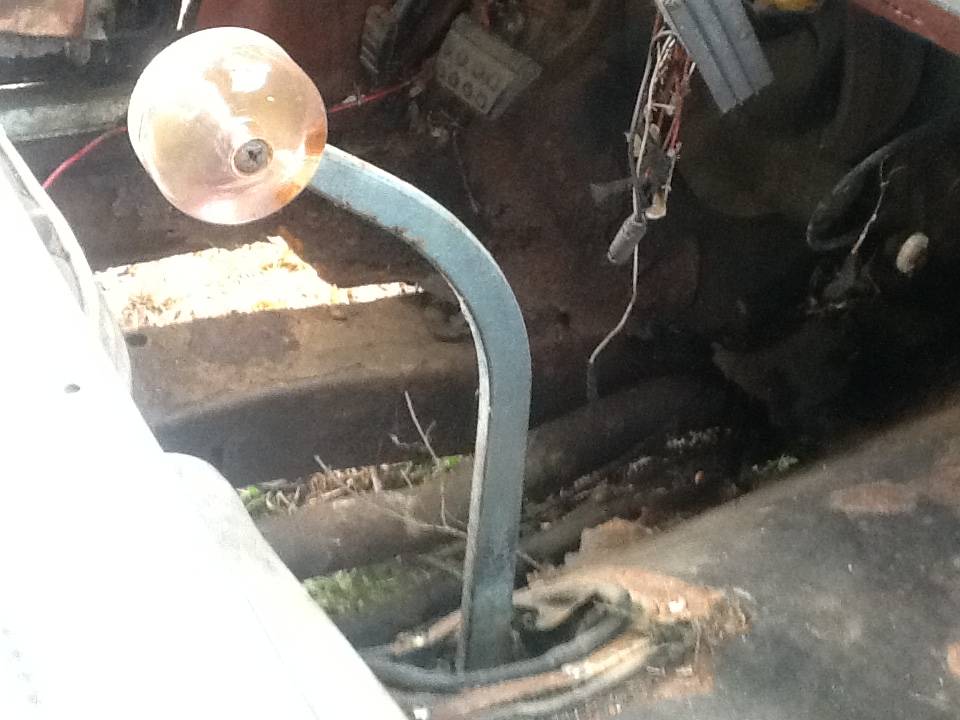

Set-up for Dodge Lancer from the 1961 parts catalog. Again might be good insight.
Contacted a guy local to me who has a ‘61 floor shift Newport. I’m going up on Saturday to see and measure. I’m a bit hesitant to cut out a hole in sixty year old virgin floor pans. But there is no avoiding it. Keeping the three speed!
