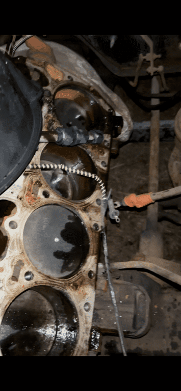

Also— I am needing the complete top end for it. Long rams, exhaust manifolds, heads. Yeah, I know. Rare… I am wondering what heads I should be looking for…? If they’re impossible to find, are 452’s the next best thing? Thx.
Neat car, they made many of the long ram 4 doors, it was an optional engine.
I wouldn't want open chamber heads on that engine. I would use the fairly common 516 heads and leave the 1.60 exhaust valves. Because that is what the combination is and it is small cubic inches.

I’ll start looking for 516’s near me then.
Next question, do you want 4 bolt valve covers as original?
The don't have cast in rocker pedestals. Or do you not mind 6 bolt valve covers? Mid 1963 was the change.
And remember you need to have the bolt holes on the end of the passenger head for the alternator bracket. So 1960 and older heads won't work.

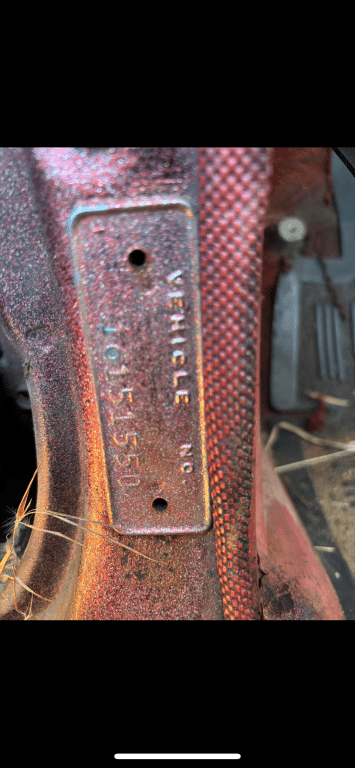

They didn't have an emblem on the dash. It probably isn't a real factory ram car. Post pics of the inner fenders, there are tell-tales there. Also there is a guide book on the sonoramic cars someone put together out there and you can get a copy of the build sheet from FCA "Chrysler" so long as you own the car and if you think it is a real one, you absolutely need to have that verification.
Yeah. I know the emblem is in the wrong place. It should be on the passenger side trunk lid. I said this on FB. And the original invoice clearly reflects my car came with the SC option with my vin # on it. And the book you’re referring to is the Darrell Davis book that also clearly supports what I’m saying. So, there NO doubt this is a factory SC car.

All well and good and that is an awesome car, I have the original dealer write up and the original title for my car as well - before window stickers. I would still encourage you to get the build sheet! It is a wonderful service and everyone should have it to accompany their car, especially unusually equipped units.

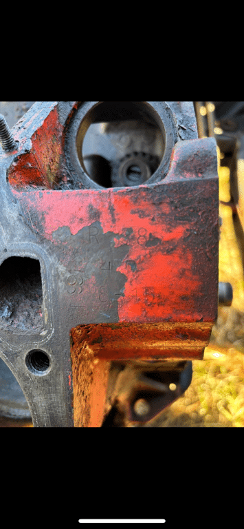

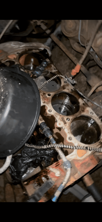

The R on your block indicates 1961 motor!

There are early 60s closed chamber heads around. 4-bolt too..... WTB ad would get you started.
